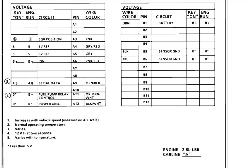

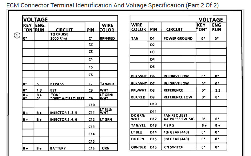

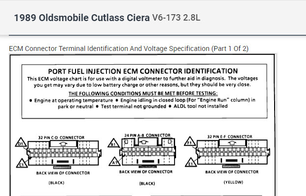

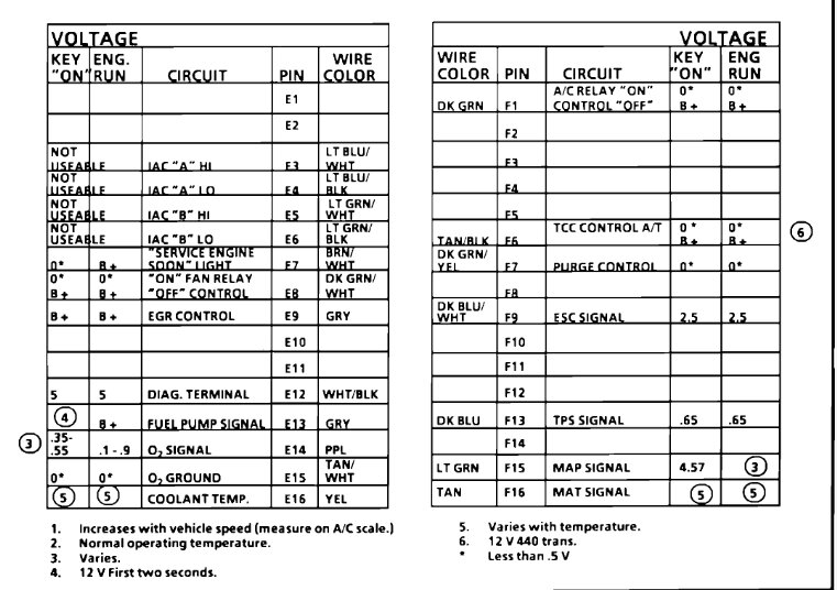

I suspect you also needed the connector pinouts. If you look below, pic 1 shows the three different connectors and identifies the pins. The remaining pictures are what each wire/pin is used for.
Let me know if this helps.
