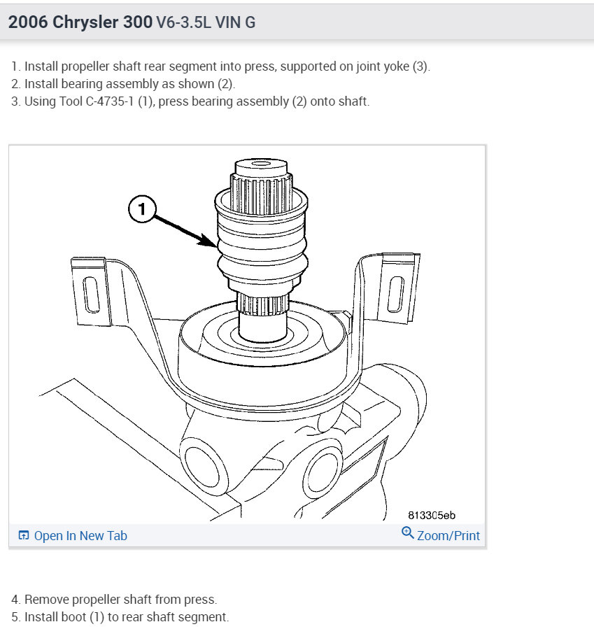

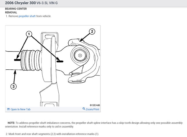

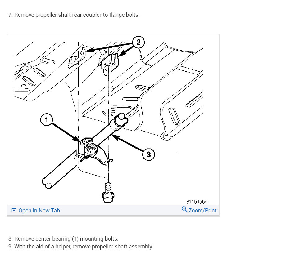

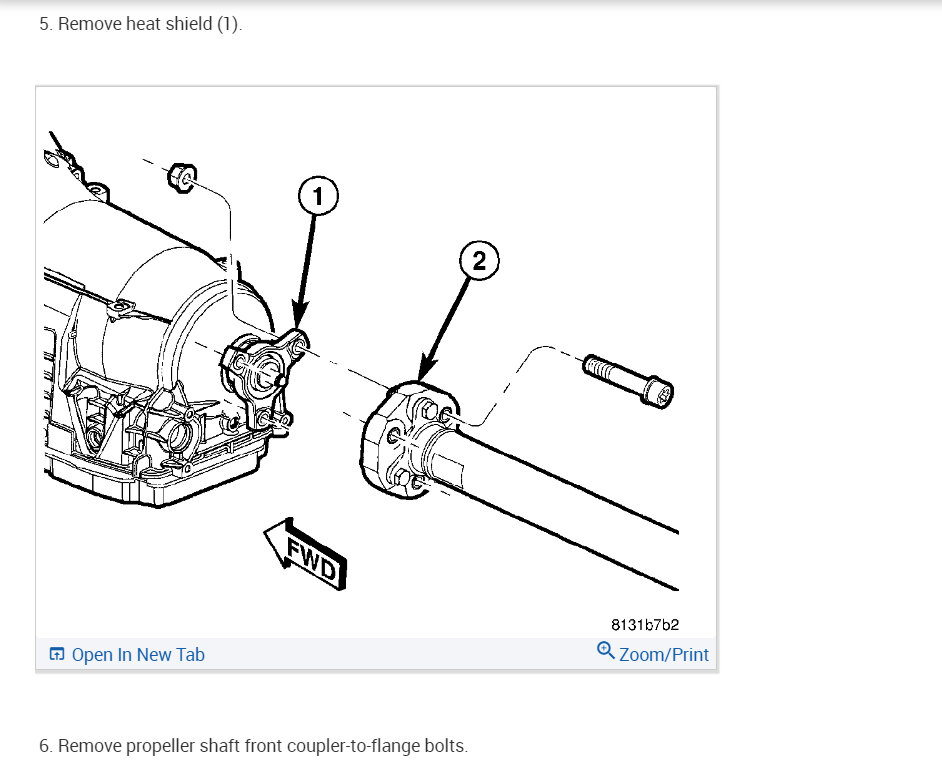

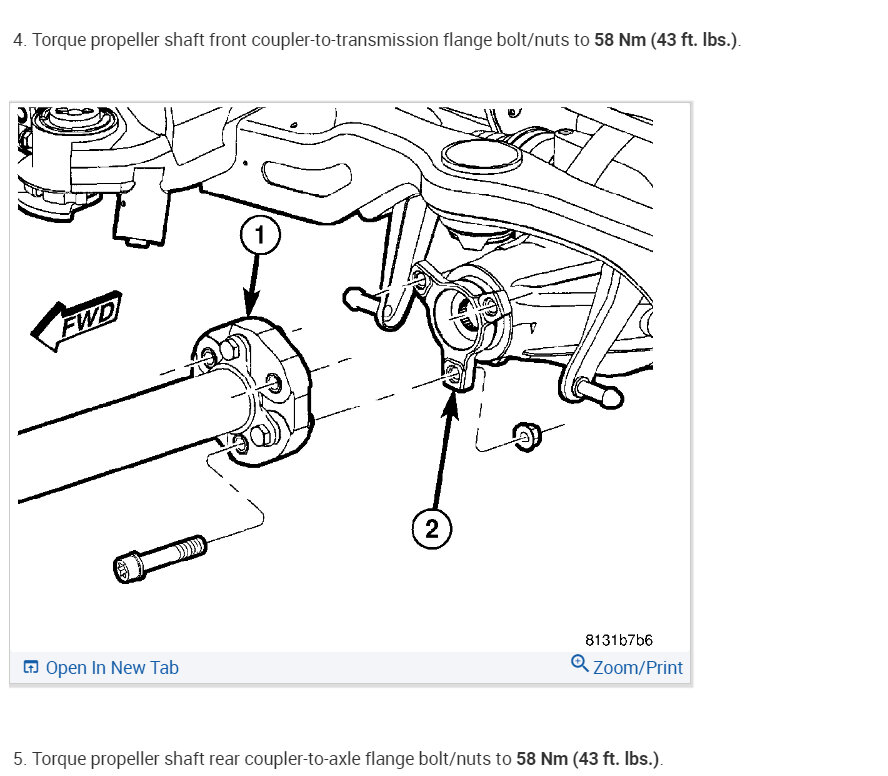

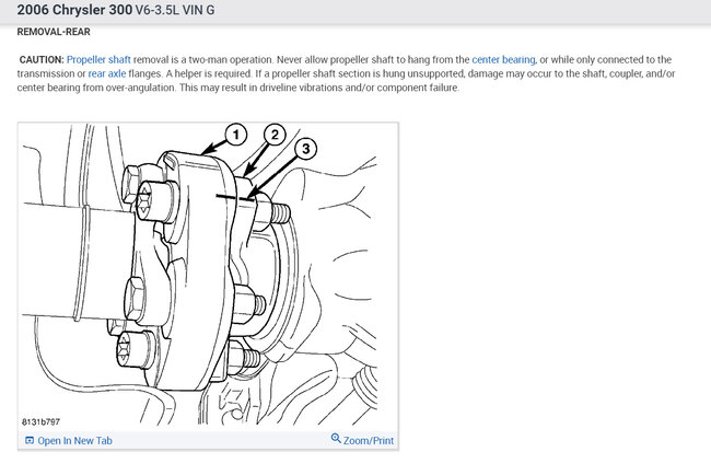

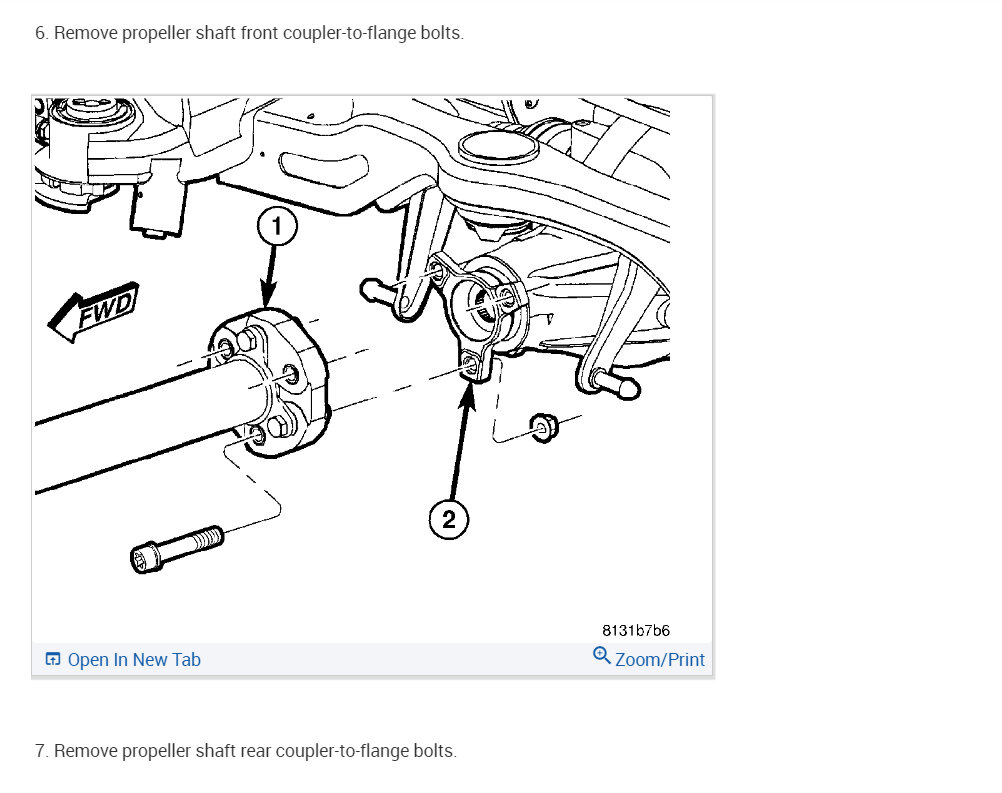

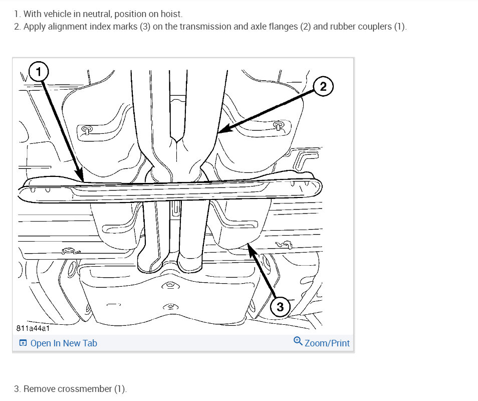

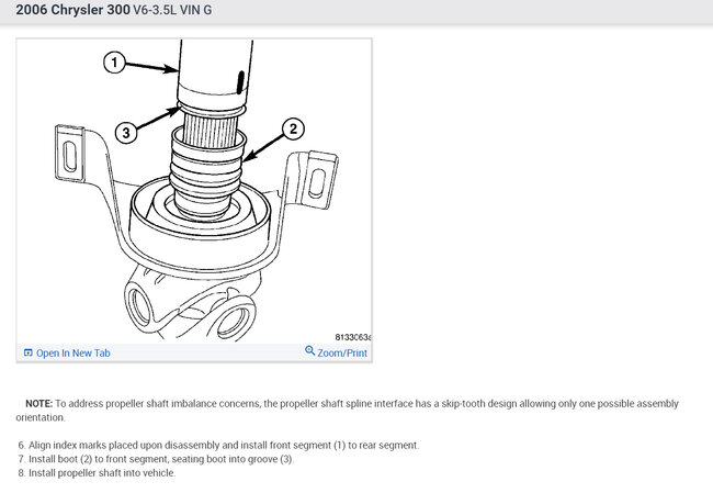

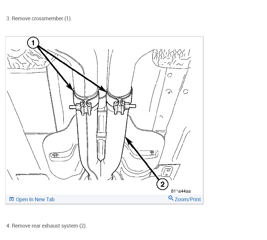

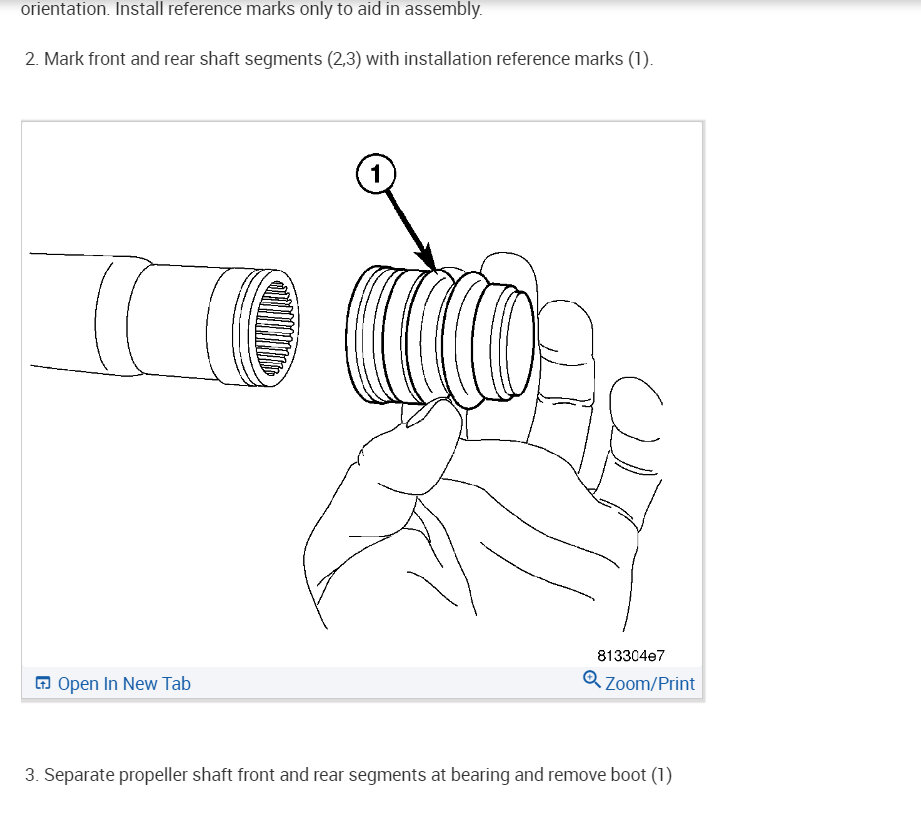

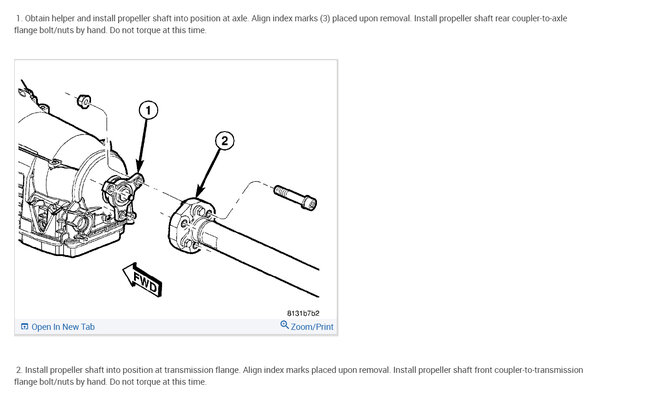

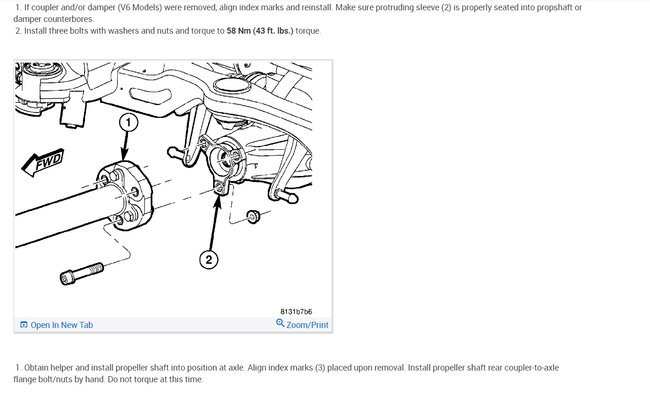

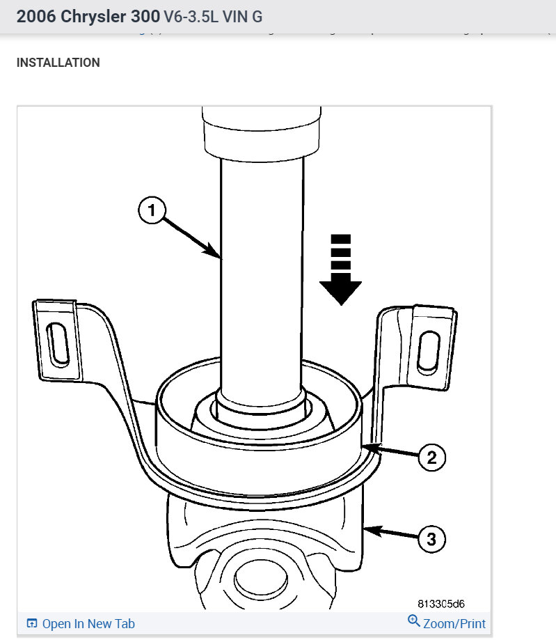

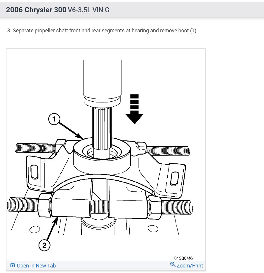

I'm replacing the carrier bearing on the car listed above, rwd. I have my driveshaft taken off, I just can't get the driveshaft to pull apart, so I need help with that.
May 28, 2023 at 10:24 PM
  • 55,746 POSTS

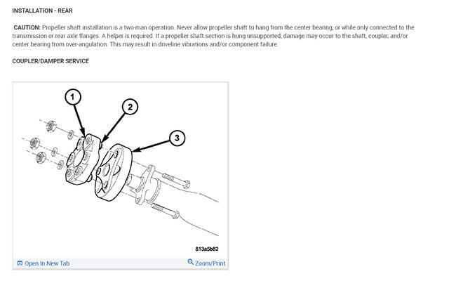

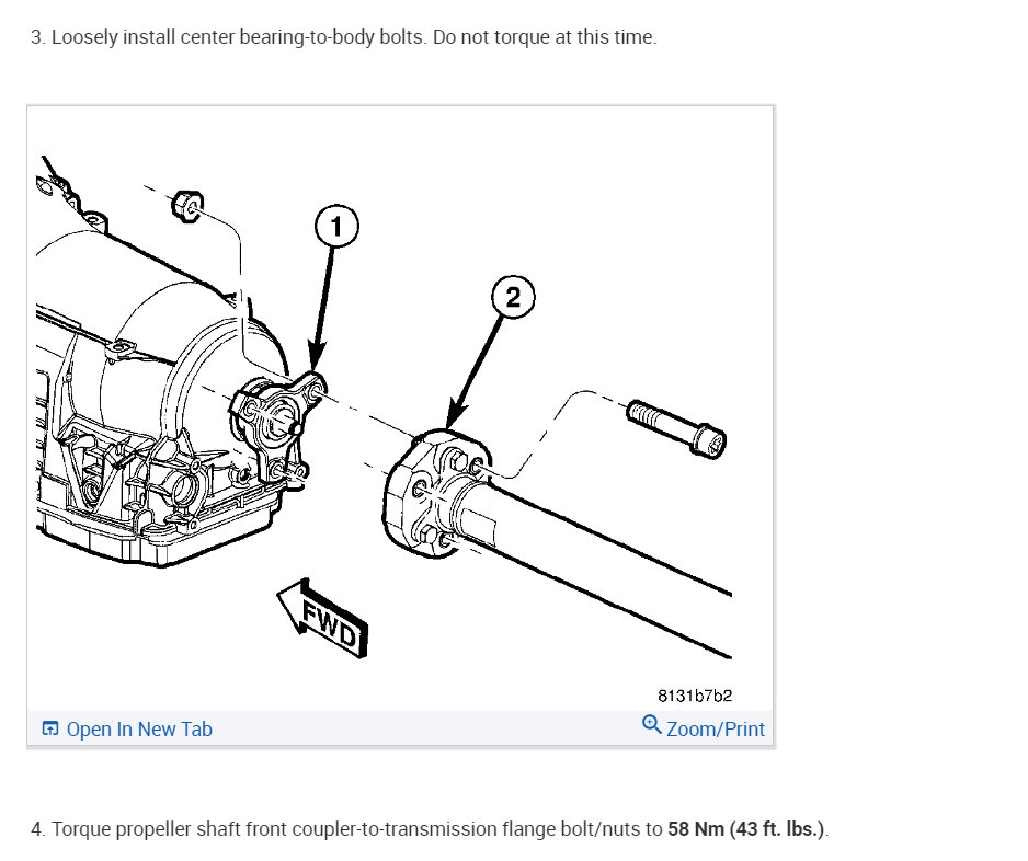

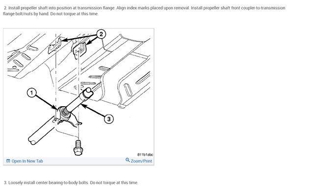

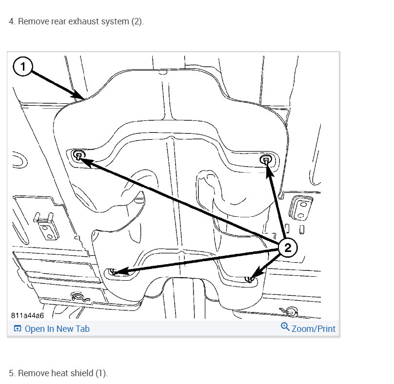

Yep, here are the instructions on how to remove the driveshaft and the center support bearing on the car above. Check out the images (below). Please let us know if you need anything else to get the problem fixed.
