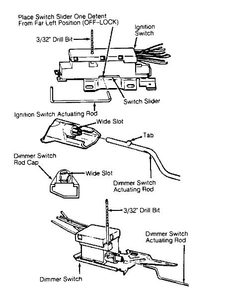

How do you take the ignition orange wire off

I need it to replace the ignition but I can't remove it

I know if the picture show or not but if it dont here the link
http://www.use.com/supersize.pl?set=05f04f0d32355e478577
Jul 21, 2014 at 3:44 AM

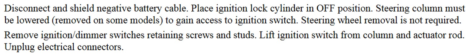

your pic didn't come through see pics for removal
Images (Click to enlarge)
