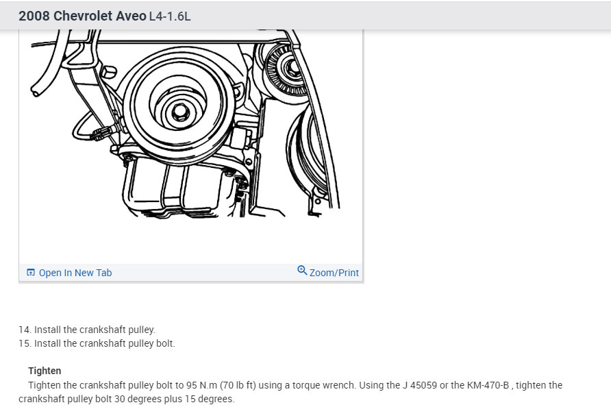

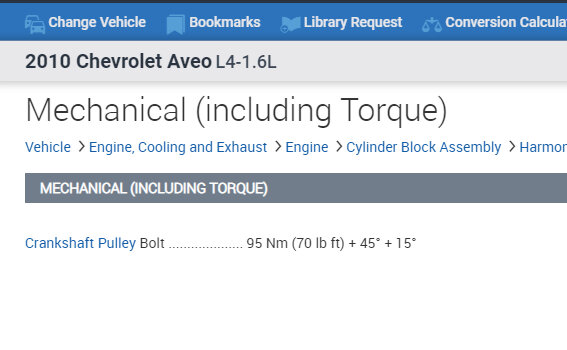

I need to know how to replace a crankshaft pulley and what the torque specs are for the bolt.

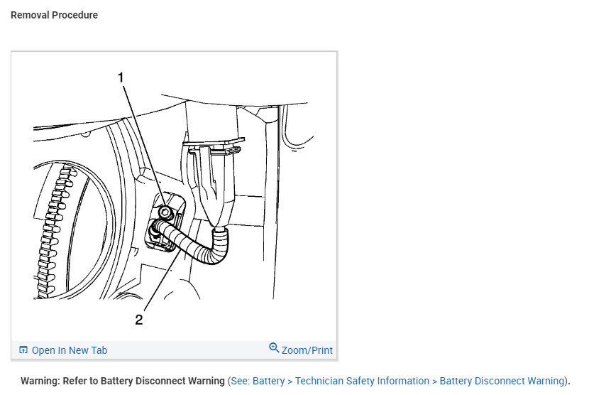

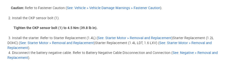

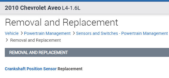

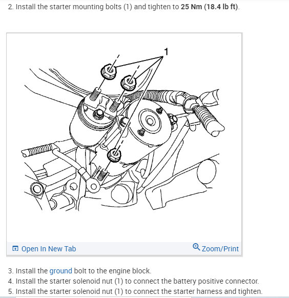

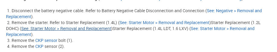

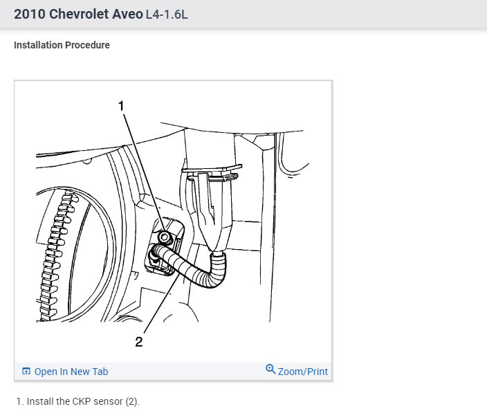

In general, these are usually an easy job. On your vehicle, the starter will need to be removed to access the sensor.
To get you started, here is a link that explains in general how it's done:
If you look below, I attached the directions specific to your vehicle for replacement. In sequence, I included the other tasks needed to complete the job.

My manual doesn't show a replacement procedure. However, the removal is simple, but the space available makes it difficult.
If there is access via the wheel opening, that is the way I would go. Remove the wheel and fender liner to access the pulley.

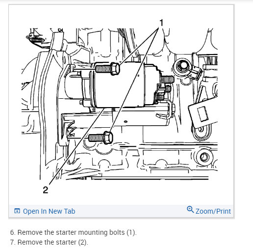

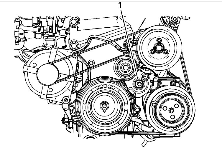

Next, remove the serpentine belt. Once that is off, remove the center bolt on the pulley/harmonic balancer. See pic 2 below. You will need a puller to remove the part from the crankshaft.

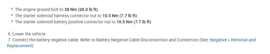

Reinstallation is the opposite of removal. I attached the torque specs below. (See pic 1)
Let me know if this helps.

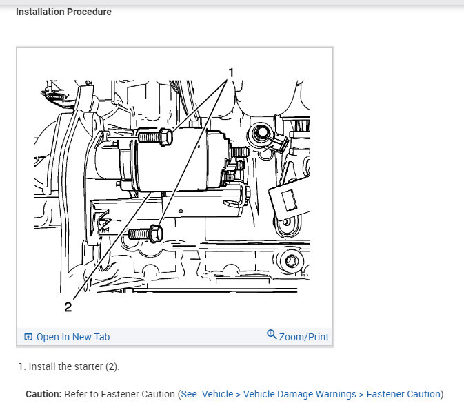

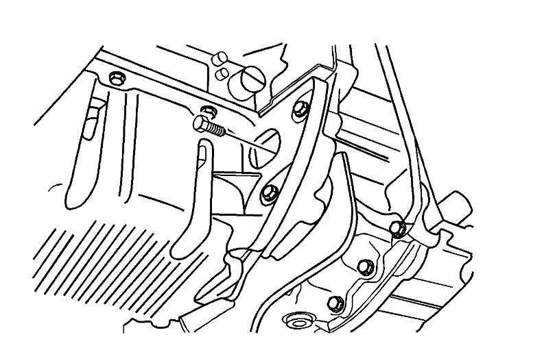

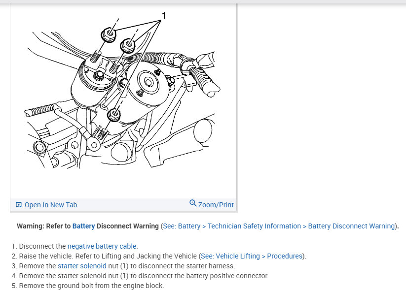

No problem. I was just wondering; how do you torque the crankshaft pulley without making the crankshaft move? Most applications have a holder tool. This crankshaft pulley don't look like there is any holes to install the tool to keep the crankshaft from moving.
Dec 7, 2022 at 8:07 PM
  • 110,193 POSTS
This is a tricky one. What I have done is to remove the transmission inspection plate or the starter and hold the flex plate. To make it a bit more difficult, they want the bolt torqued and then adjusted to degrees. See pic 1 below.
Pic 2 shows the service hall cover. If you remove that or the starter motor, you can prevent the crankshaft from turning.
