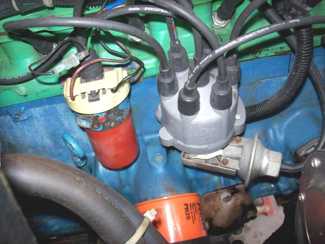

Trying to remove the wires from the coil of f-150 6 cylinder pick up truck

I HAVE 2 JEEPS, MY 1977 AMC CJ-5 HAS MOTORCRAFT IGNITION (FORD)
IF YOURS LOOKS LIKE MINE IN THE PIC BELOW, IT'S A HALF MOON CONNECTOR THAT SNAPS ONTO THE COILS RIM
GRAB IT ON EITHER SIDE AND SORTA "WORK"/ GENTLY PULL THE FRONT SIDE THEN THE BACK SIDE A LITTLE AT A TIME AND IT WILL SNAP OFF OF THE COIL
A QUICK JERK OF ONLY ONE OF THE SIDES MAY BREAK IT IN HALF
LEMME KNOW HOW IT GOES

DID I MISUNDERSTAND?
ARE YOU TRYING TO REMOVE THE WIRES FROM THE CONNECTOR (NOT THE COIL)?

No, I am trying to remove the wires from the coil. It has a plastic case which I do not want to break.

SO LIKE WERE YOU ABLE TO REMOVE IT VIA MY 1ST RESPONSE?
