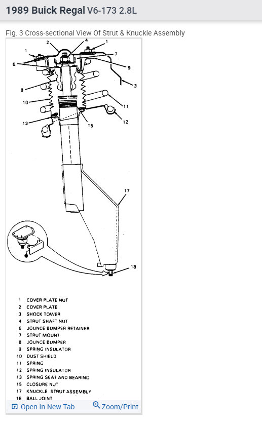

Do you need to remove the entire strut to replace the front strut bumper/dampener, or can you just work it out from the top?
This is the part I am replacing due to dry rot of the strut bumper/dampener. Ignore the fact that this part comes with a bellow boot. I am not replacing that.
https://www.walmart.com/ip/MOOG-K90463-Strut-Bellows/47771875
Aug 14, 2022 at 11:07 PM
SQM
  • 6,383 POSTS

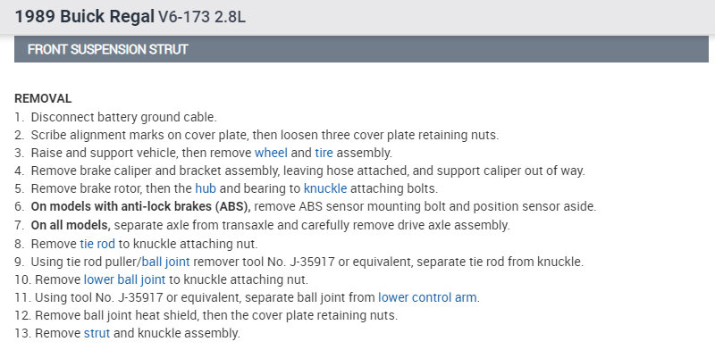

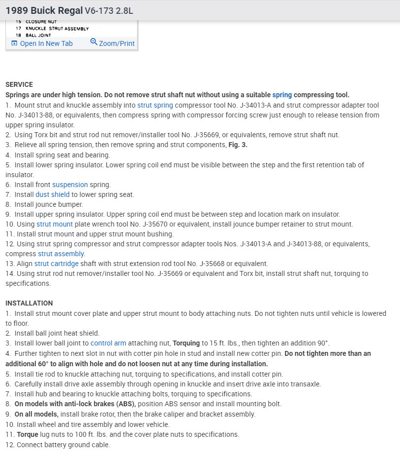

You will have to remove the strut in order to replace the dampener.
I have attached the replacement procedure below.
Let me know of any questions.
https://www.2carpros.com/articles/how-to-replace-a-suspension-strut-and-spring
