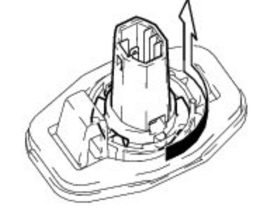

how do you remove license plate bulb from the socket
149,942 MILES • 3.5L • V6 • AUTOMATIC
AB AUTOMOTIVEREPAIR TRANSMISSIONS
  • 107 POSTS
we know how to remove the actual socket but do we need to break the bulb or change the entire assembly?
Dec 12, 2019 at 7:36 AM
STEVE W.
  • 15,413 POSTS

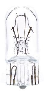

Looks like it takes a 168 peanut bulb. The assembly comes out and uses 1/4 turn locking to secure the socket to the lens. Check out the diagrams (Below). Please let us know if you need anything else to get the problem fixed.

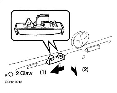

How do you replace the tag light bulbs?
Oct 19, 2020 at 10:08 AM (Merged)
ZACKMAN
  • 4,202 POSTS
Remove license plate lamp assembly a. Release the 2 claw fittings and disconnect the license plate lamp assembly b. Disconnect the connector and remove the license plate lamp assembly c. Pull the lamp straight out.

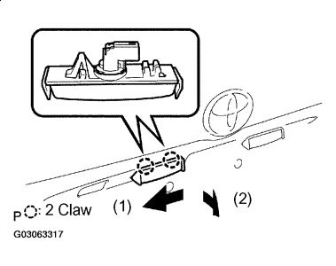

i need to change 1 of the 2 license plate lights but don't see any entry.I'm assuming I might have to take off the whole interior panel of the lift door but I'n not sure and not sure how to do it???
HELPPPPPPPP
BLUELIGHTNIN6
  • 16,542 POSTS
The back door interior panels are held in with special clips. To disengage these clips you must first purchase a clip remover. Then simply disengage the clips to remove the panels. Then remove the back door pull strap and trim board assembly. Remove teh sub-assembly outside panel and then you can remove teh license plate lamp assembly. Do this by releasing the 2 claw fittings and disconnecting the license plate lamp assembly.
