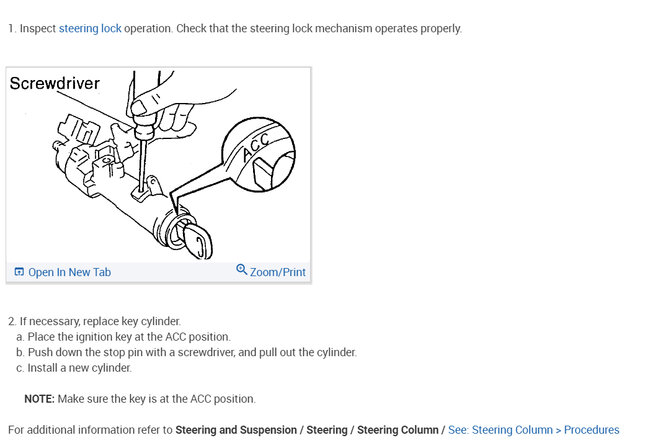

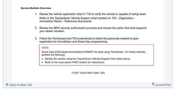

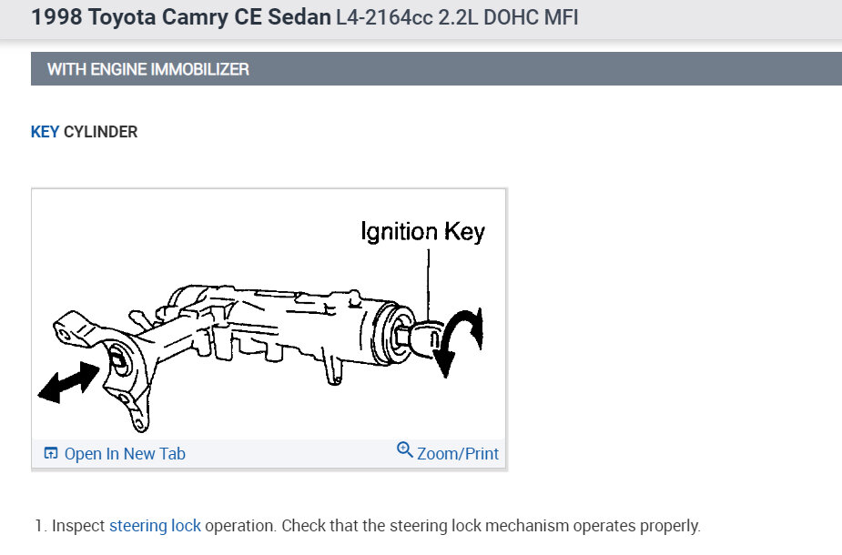

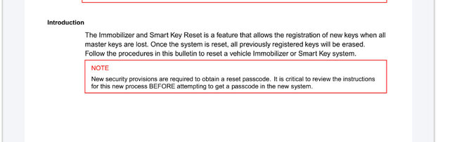

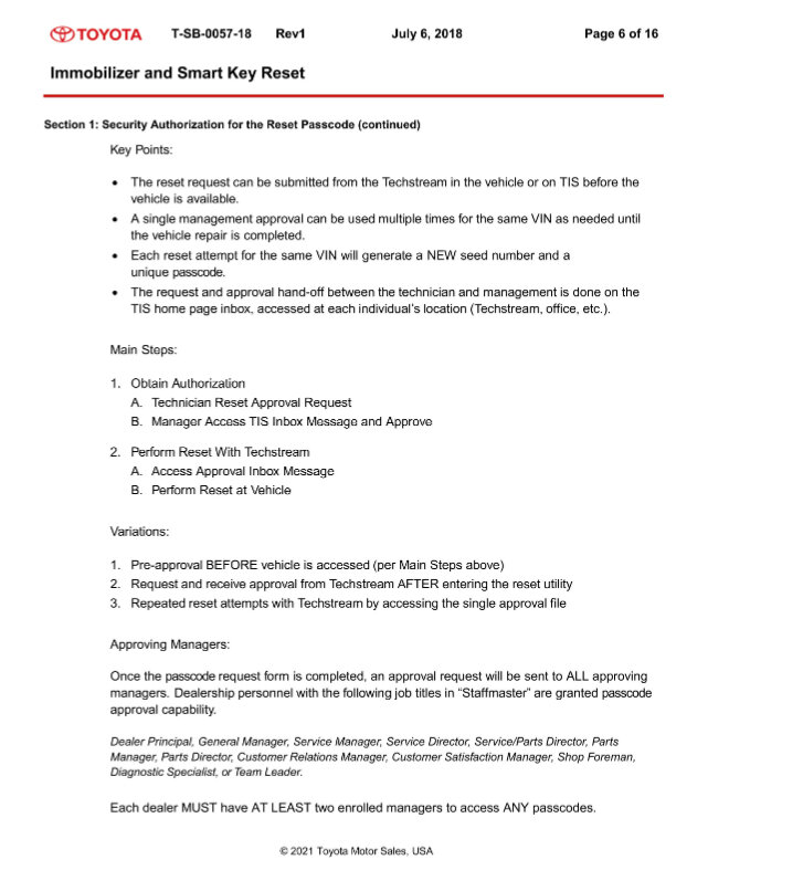

The key will need to be programmed by the dealer, here are the instructions on how to change the key out and how the dealer reprograms it to the car. Check out the images (below). Please let us know if you need anything else to get the problem fixed.
