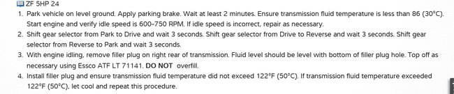

where is plug located and how do you refill?

there is no plug for drainage only one to refill which must be done on level ground or a hoist. the pan must be pulled to drain old fluid. if you have the ZF5hp transmission there is a filler plug at right rear of transmission. if a hydramatic it goes through the filler tube. THis guide will help walk you through the job
Check out the diagrams (Below). Please let us know what you find.
