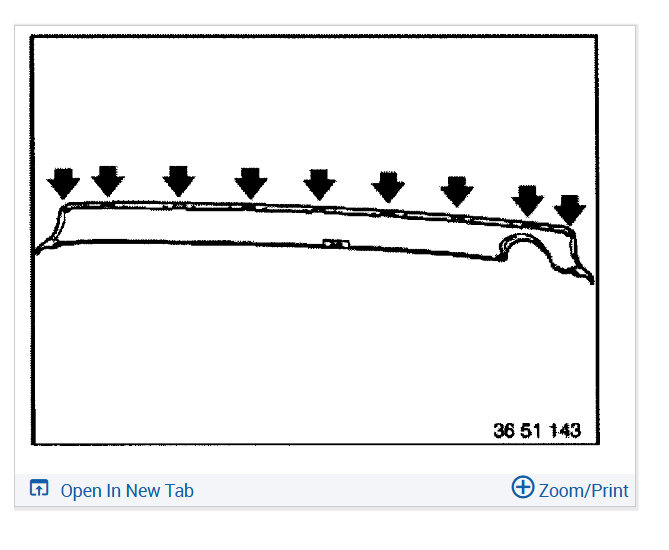

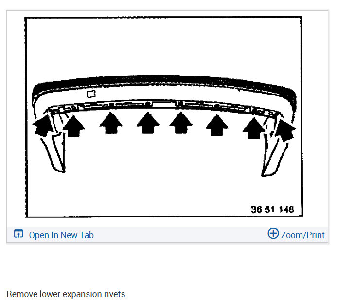

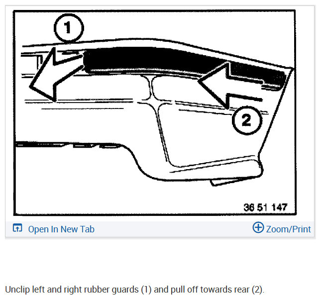

I have installed a 328i exhaust on my 320i and I need to replace the lower bumper rear trim panel with one that has a larger opening for the twin tips of the exhaust.
I have tried in vain to look for this tutorial online but there doesn't seem to be anything on how to change this particular panel.
You would look this up for a 328i from 1995/96, as the chassis for this model is the same as the one I have.
Oct 31, 2024 at 4:07 AM
  • 54,840 POSTS

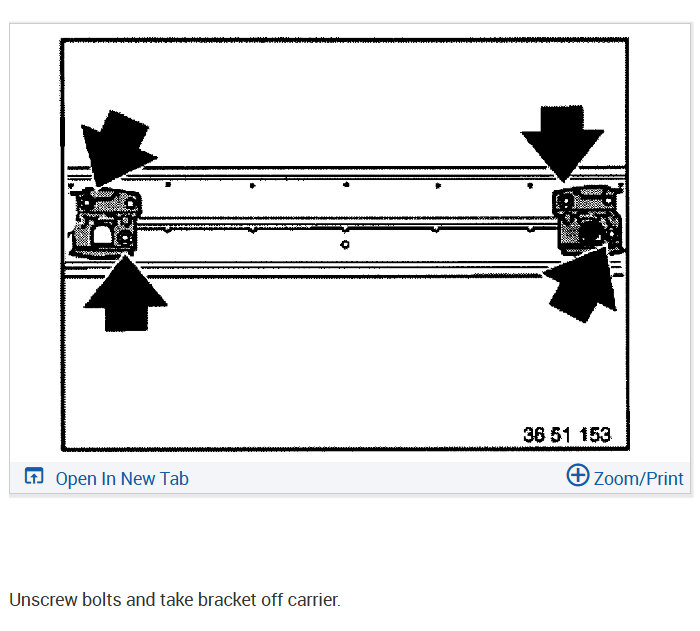

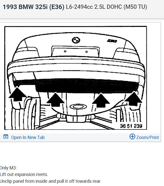

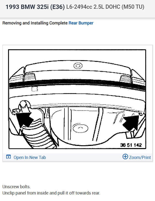

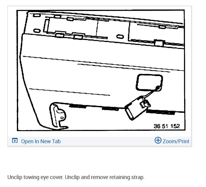

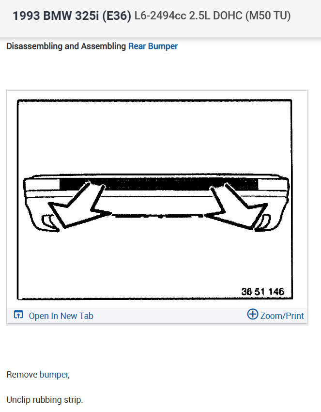

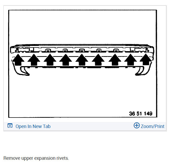

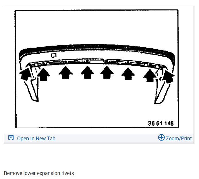

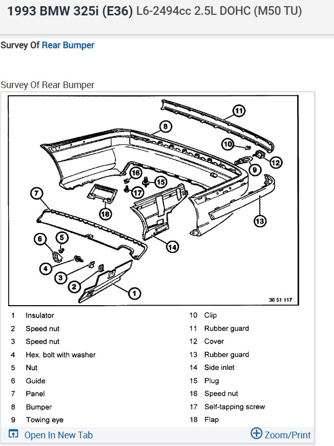

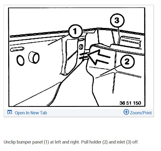

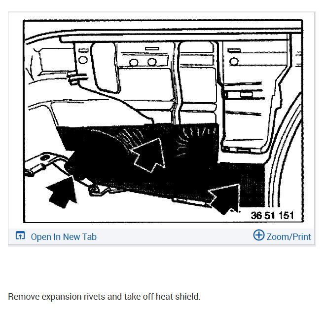

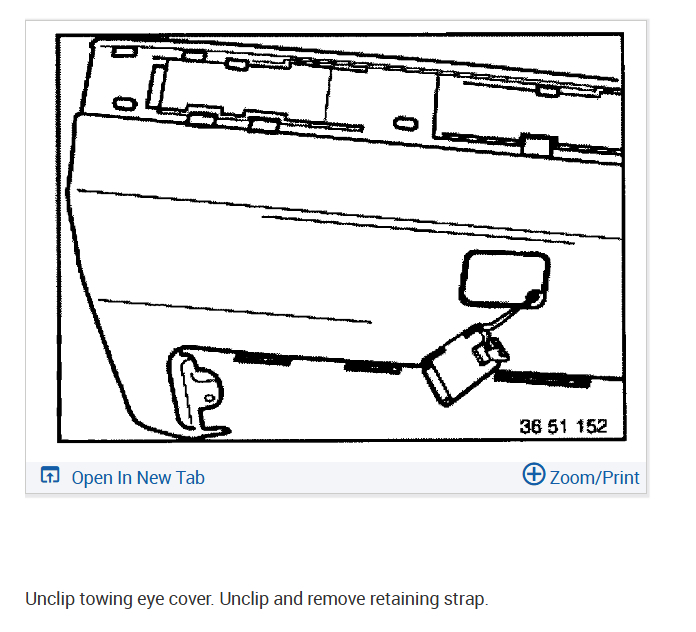

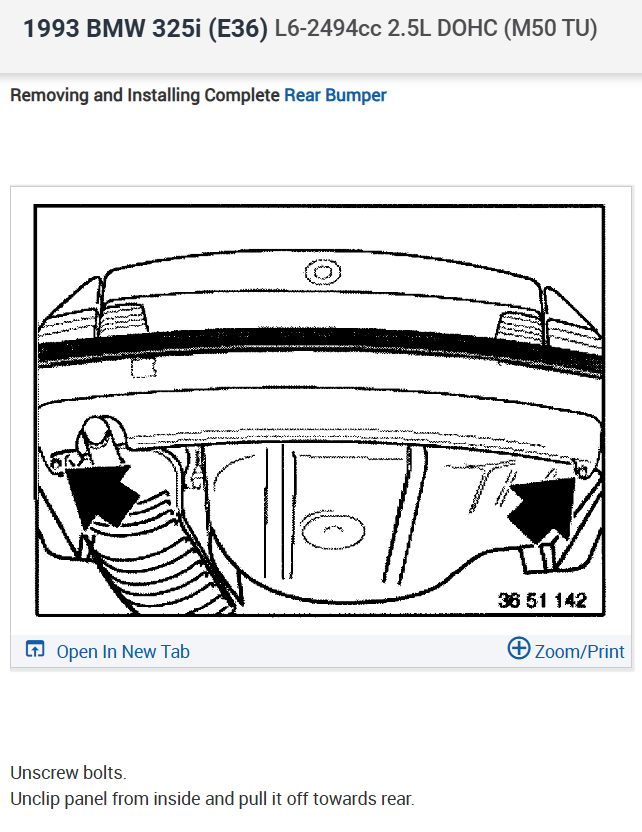

Sure, here is how to remove and install the lower bumper valance. Check out the images (below). Please let us know what happens.
