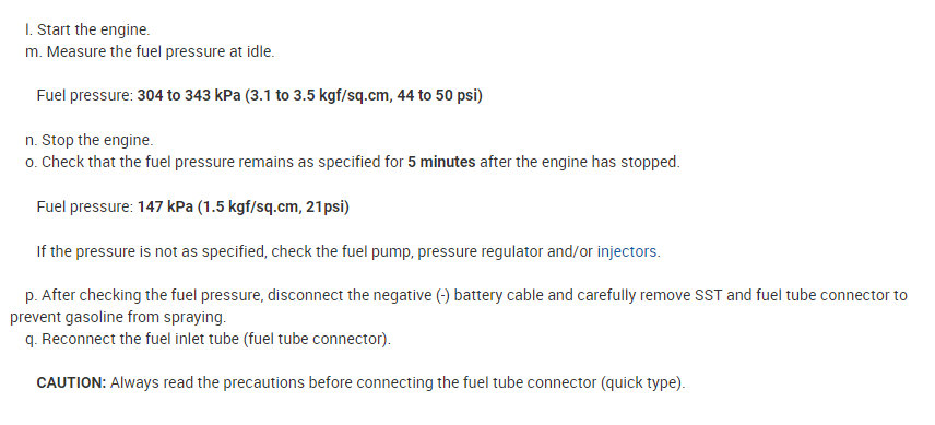

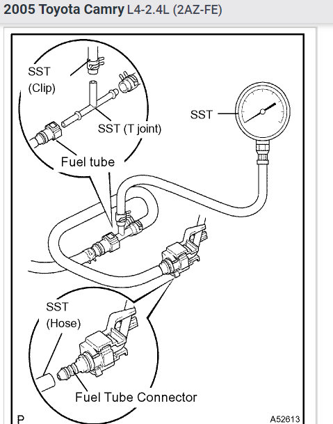

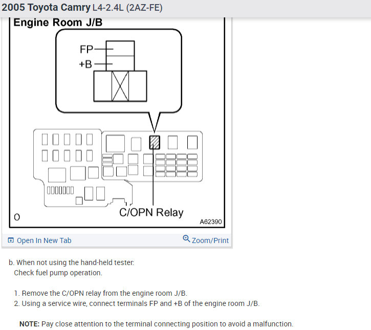

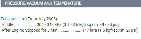

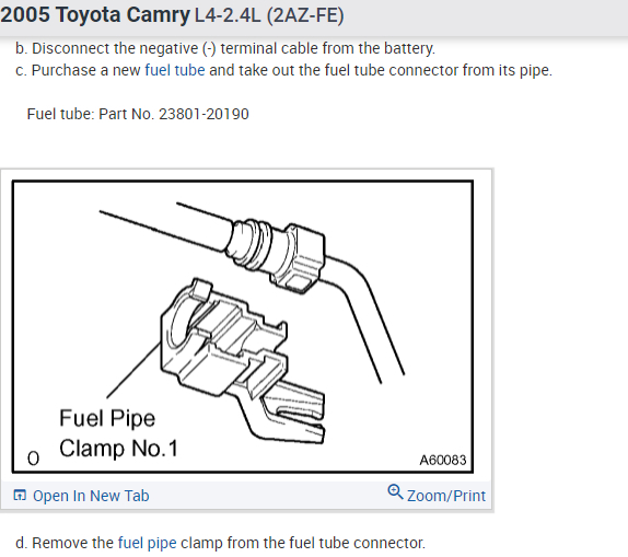

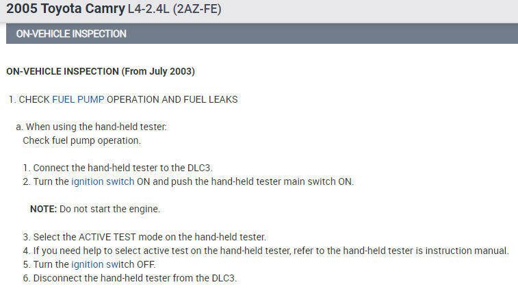

I have attached the fuel system diagnostics for your reference.
Let me know of any questions.
