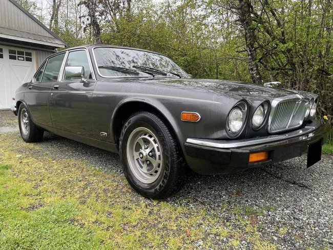

I am looking at purchasing this vehicle but would like to know beforehand how to troubleshoot it and get it running with the minimum of fuss and expense.
As far as I have been told, this car was parked in a barn under its own power and was running very smoothly at the time. It stayed there for 23 years, and the body and interior are still in great shape.
When I contacted the seller, they tried starting it and found that no power was going to the dashboard, and it could not be started.
What are the steps that can be taken to get it running with the minimum of fuss and expense?

Since this vehicle has been sitting for such a long time, there could be any number of issues you might have to fix.
So, it is nearly impossible to say what would be the minimum fuss/expense.
It could be any defective component(s).
The best course of action would be to first install a new battery, then test all the fuses and replace them as needed. That could help with not getting power to the dashboard. Also, all those relays need to be checked and tested.
If you are getting power but it is not starting, then check for sparks and fuel.
Also, there is a good chance that the fuel lines are dried out and could need replacement as well as all the vacuum hoses.
See if you can source a repair manual for this vehicle, as that can help with many issues.
In order for us to provide you with some insights, you will first have to inspect the vehicle and let us know what you have found and what is not working or missing. Then we will have an idea of which areas to diagnose and repair.
Let me know of any questions.
