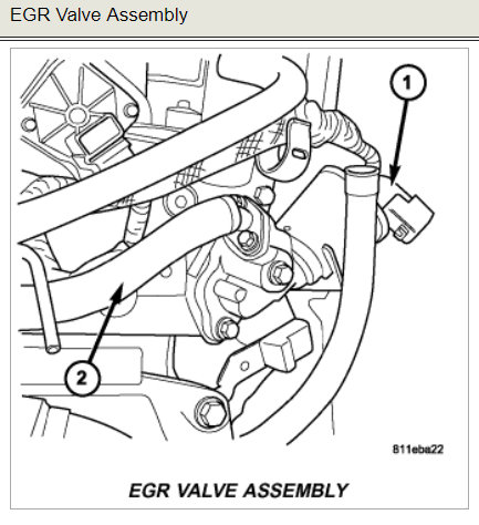

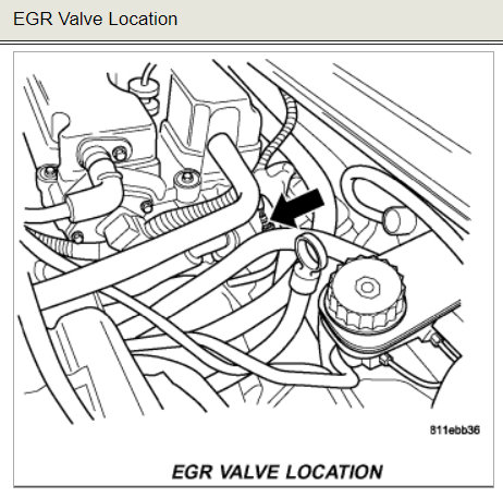

How do I tell if my car has an EGR valve
2005 CHRYSLER SEBRING
120,000 MILES • 2.7L • 6 CYL
RITA CAMERON
Need to buy an engine and I need to know that so I get the correct motor.
Nov 29, 2016 at 5:50 AM
WRENCHTECH
  • 20,761 POSTS
It looks like the six cylinder engine does not have an EGR but the four cylinder engine does here is the location for the four cylinder
Cheers
