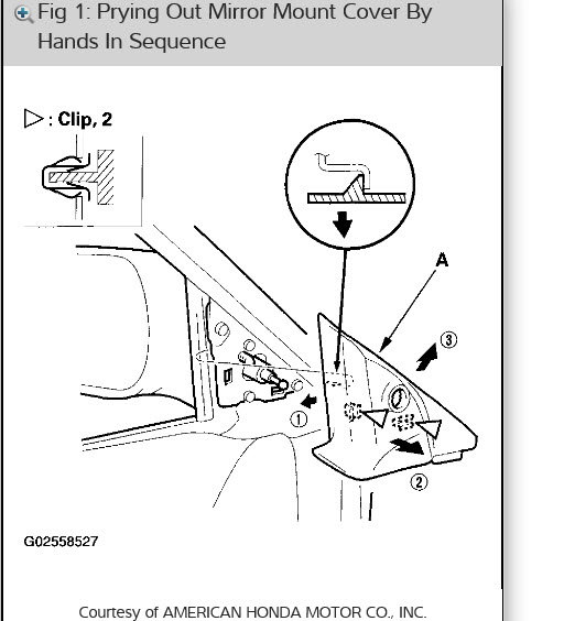

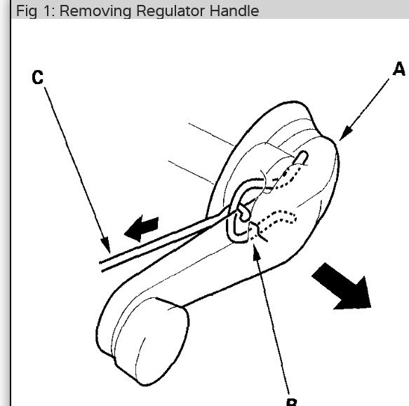

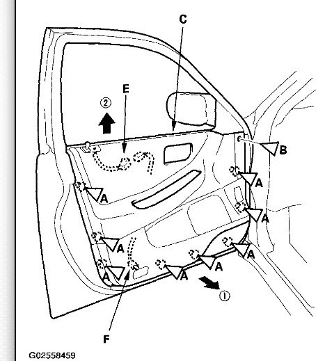

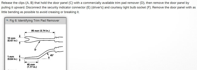

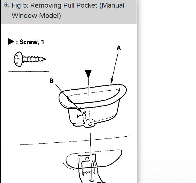

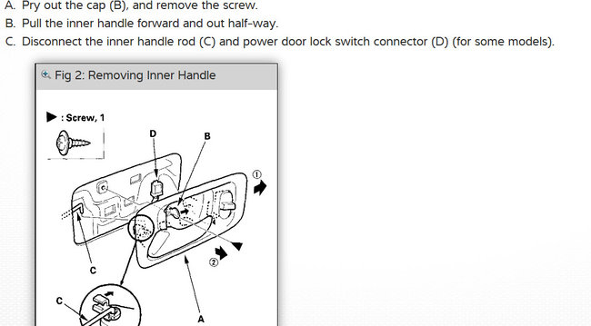

A couple of weeks ago when I put the key in the door the chamber slipped in. For a while I was not able to lock my door until I left my keys in the car, then it locked. Anyway I got in the car but now I cannot open the door from the inside or outside. Is there any way to take the door panel off with the door closed. If not what can I do and if so then how exactly do I do it?
May 7, 2017 at 7:08 AM
HMAC300
  • 48,601 POSTS
you can but it is not easy see pics this is for manual windows power windows slightly different.
