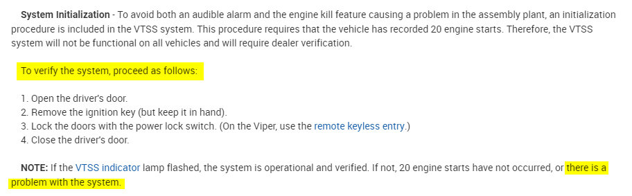

When this does not start, does the theft light blink? Try the attached procedure and see if the lamp flashes. If not, this indicates we have an issue with the system and will need a scan tool that can communicate with the theft system.
