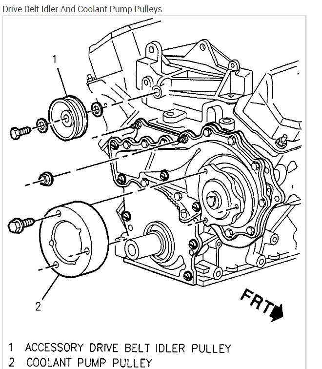

How do I replace the water pump in a 93 4.9 l Cad deville?
160,000 MILES • 4.9L • V8 • FWD • AUTOMATIC
DAVIDTERM

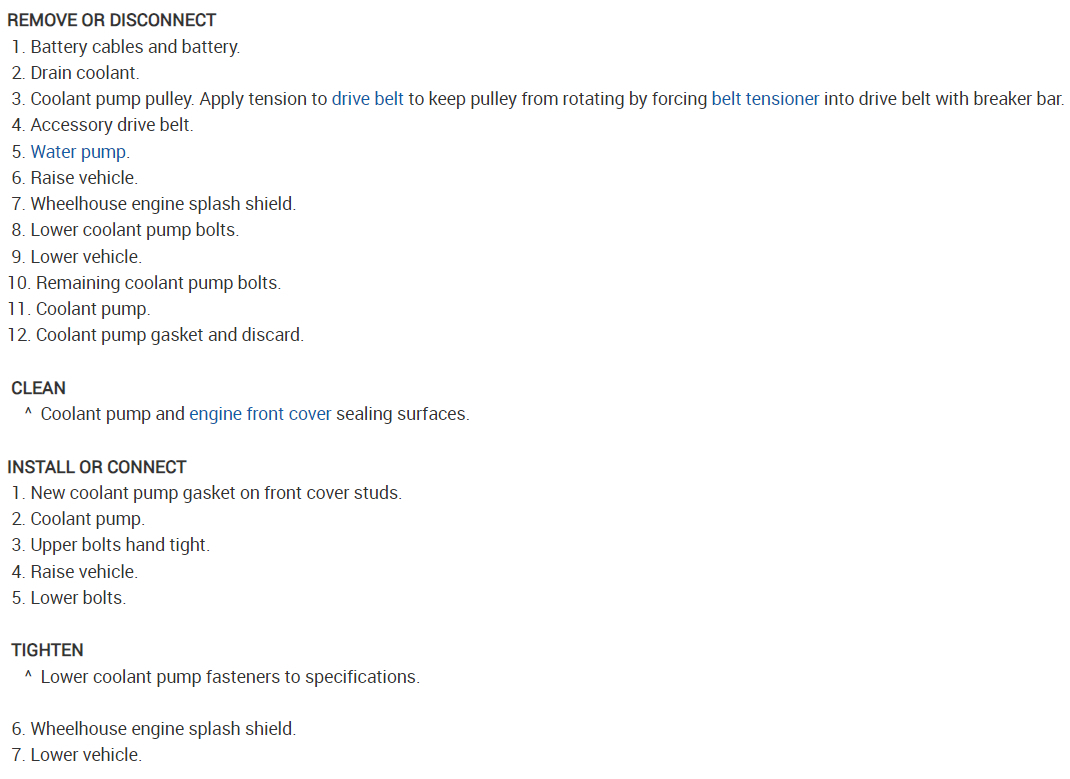

I need to know how to take out the old water pump and put in the new pump.
If possible, it would help if there was some kind of video to show how it is done.

That's a pretty involved procedure. Your best bet is to get a copy of the manufacturer's service manual, then read through the pages of instructions with line drawings to see if you want to pursue it. There will also be a section that shows any special tools that might be needed.

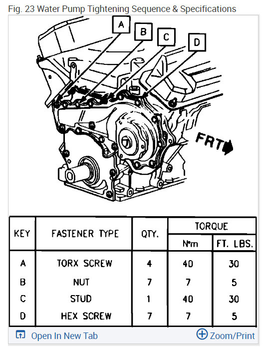

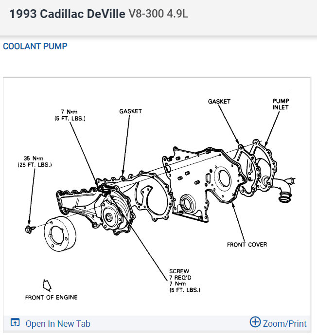

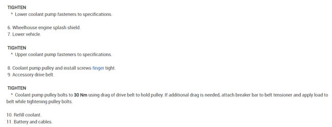

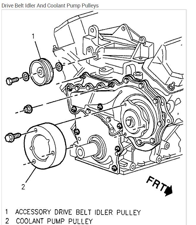

We don't have a video for it but here are the instructions and torque specs needed to do the job. It says it takes a little over two hours to do so be ready. Check out the images (below). Let us know if you need anything else.
