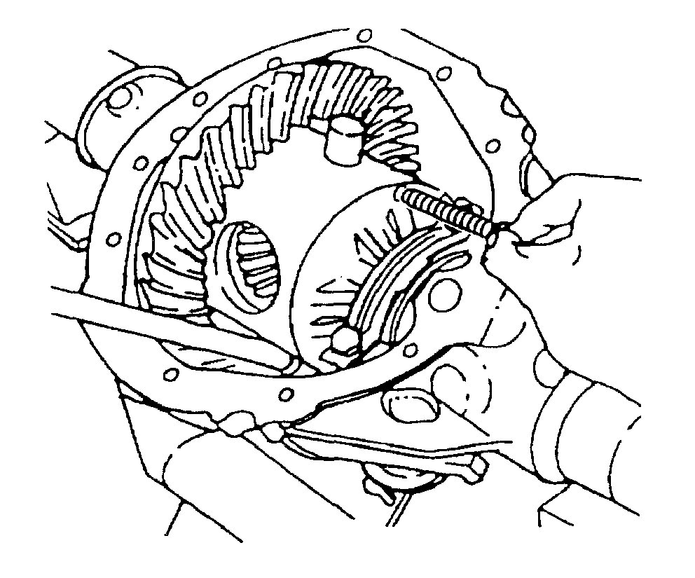

I need to replace the seal. Took it to a shade tree mechanic and believed he could do it, four hours later it still wasn't done. he claimed he needed a special part to get some clip off and he needed to be able to get the drivers side jacked up so he could get the axle off. Paid for a job that wasn't done.
Jun 16, 2019 at 9:13 PM
  • 110,194 POSTS
Welcome to 2CarPros.

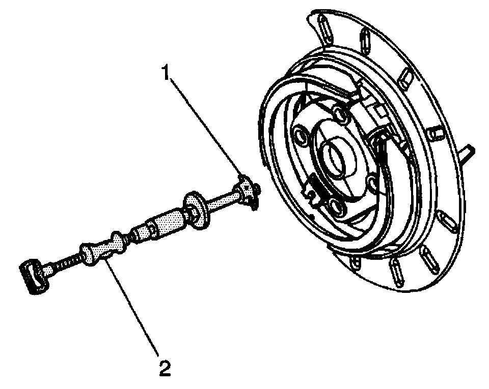

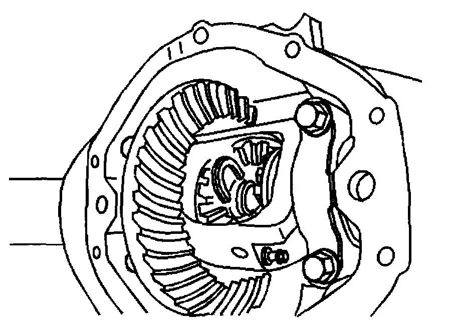

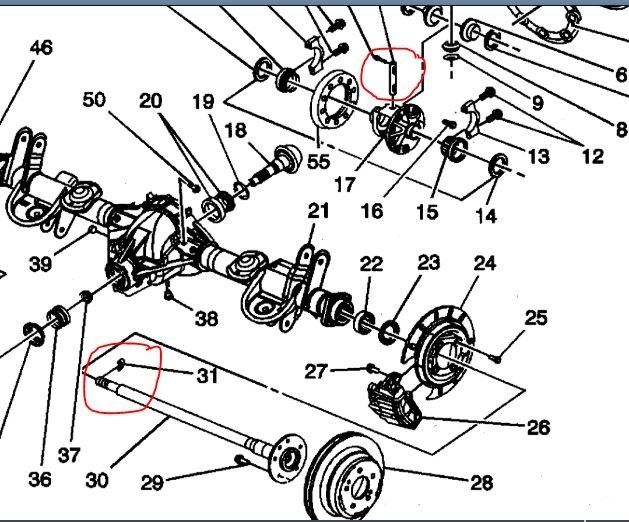

This is a somewhat involved job. However, other than a slid hammer and a bearing setter (which most parts stores will lend you) no major tools are needed. The axle shaft needs to be removed from the axle housing which does require the vehicle to be lifted, safely supported, in this case, the right tire to be removed, the brakes and rotor to be removed, and then the differential cover needs removed, which will cause the fluid to drain.

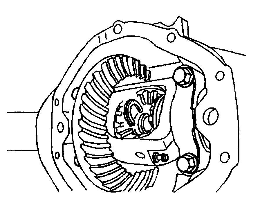

If you look at the first picture I attached, I circled two things. One is the axle itself but more importantly a C clip, and the second is the (toward the top of the pic) is the pinion gear shaft and bolt. Once the cover is removed, you first have to remove the pinion shaft bolt which will allow the pinion shaft to drop out of the pinion. At that point, you will need to gently push in on the axle (wheel side where you removed the tire, brakes and so on) and remove that C clip. Once that clip is removed, the axle will come out.
Okay, I had to try and explain that as best as I could because the directions for removal of the axle shaft are somewhat vague. They are basically what I already explained, but a bit vague. However, the pictures correlate with the directions, so that should help. Once the axle is out of the leaking side, then seal replacement is possible which I will provide after the axle information.

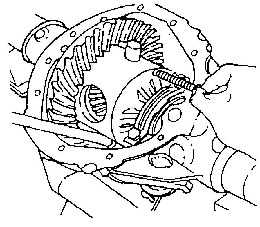

Rear Axle Shaft Replacement
Removal Procedure
pic 2
1. Raise the vehicle.
2. Remove the tire and wheel assembly.
3. Remove the brake caliper.
4. Remove the rear axle housing cover and the gasket.
5. Remove the pinion shaft locking bolt.

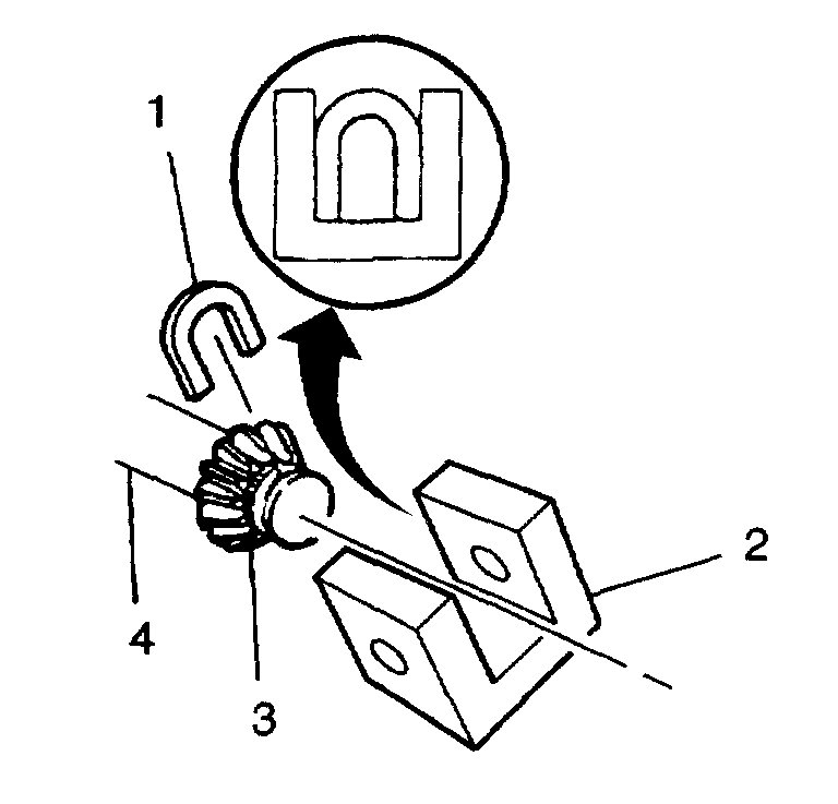

pic 3
6. On axles without a locking differential, remove the pinion shaft.

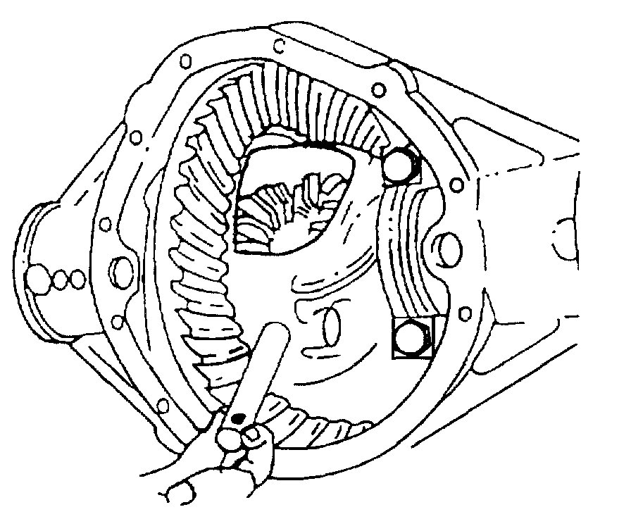

pic 4
7. On axles with a locking differential, remove the shaft part way. Rotate the case until the pinion shaft touches the housing.

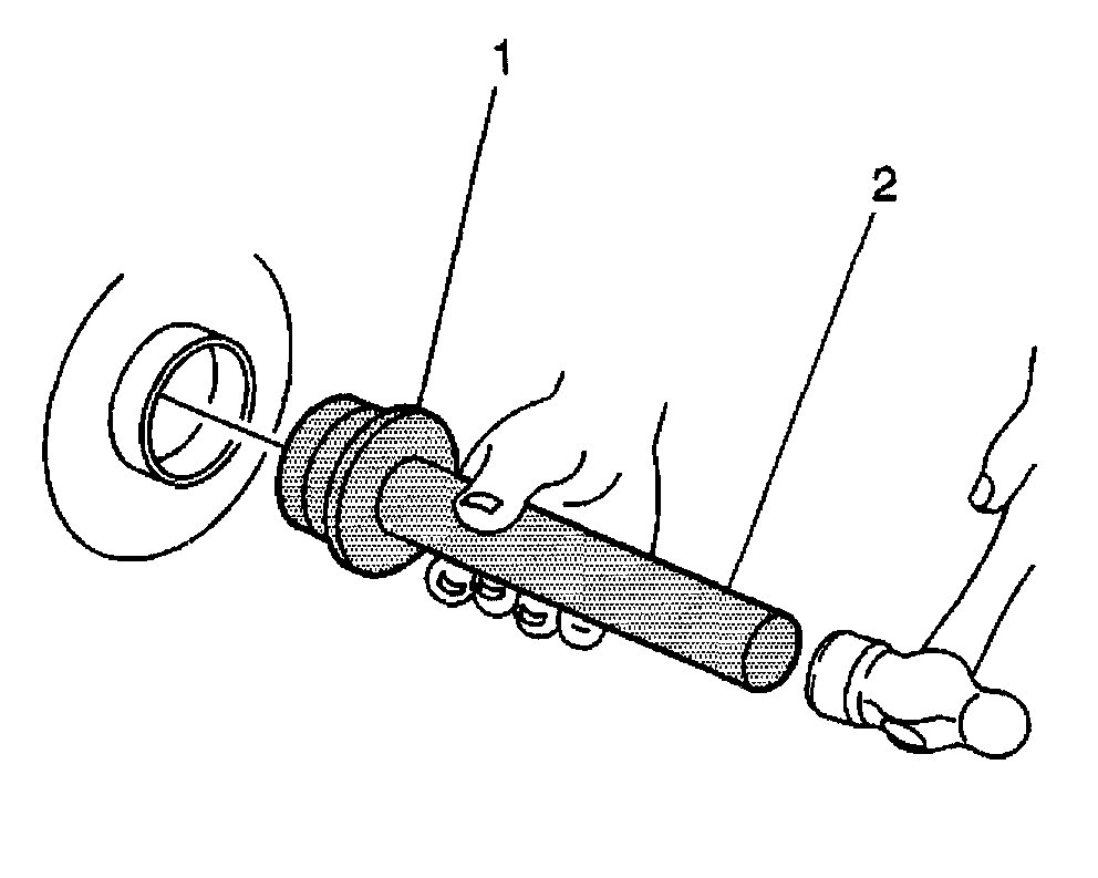

pic 5

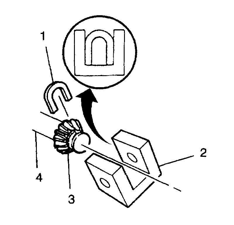

8. On axles with a locking differential, use a screwdriver, or a similar tool, in order to enter the differential case and rotate the C-lock (1) until the C-lock aligns with the thrust block (2).
9. Push the flange of the axle shaft (1) toward the differential.

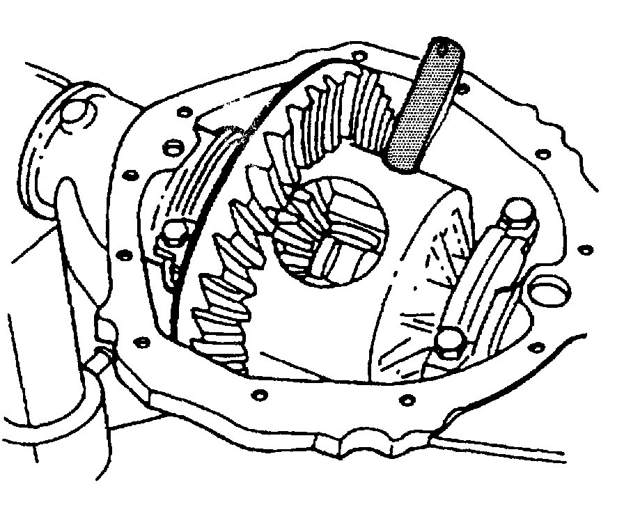

pic 6
10. Remove the C-lock from the button end of the axle shaft.

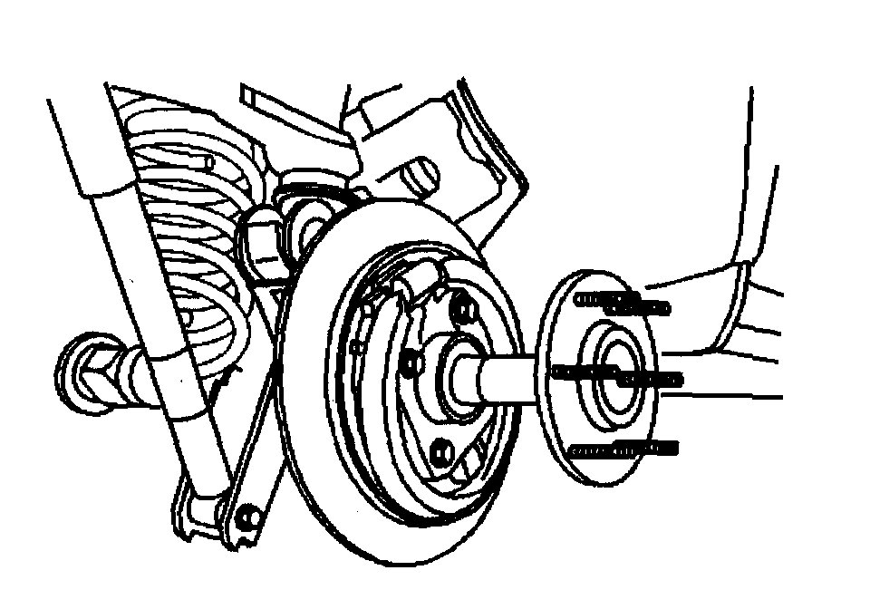

Important: When removing the axle shaft, do not rotate the shaft. Rotating the shaft will misalign the gears. Misaligning the gears will make the installing of the axle shaft difficult.
11. Remove the axle shaft from the housing.

pic 8

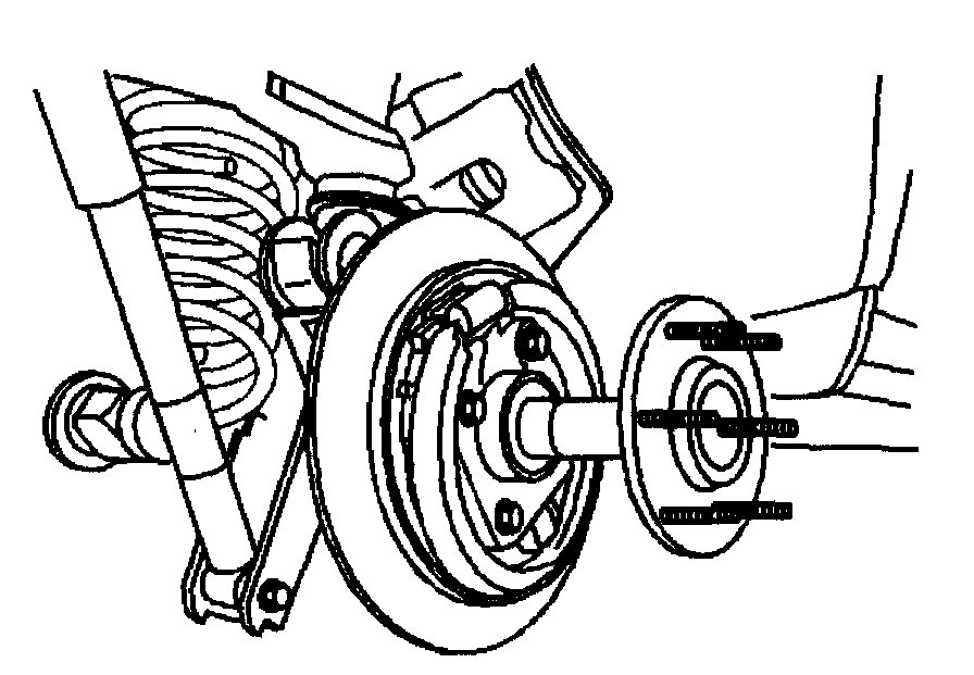

1. Install the axle shaft into the rear axle housing.
2. Slide the axle shaft into place allowing the splines to engage the differential side gear.
pic 9
3. On axles without a locking differential, place the C-lock on the button end of the axle shaft.
4. On axles with a locking differential, keep the pinion shaft partially withdrawn.
pic 10
5. On axles with a locking differential, place the C-lock (1) on the axle shaft (3) so that the ends are flush with the thrust block (2).
6. Pull the shaft flange outward in order to seat the C-lock in the differential gear.

Once the axle is out, follow these directions for seal and bearing replacement. I have to be honest, since it is this far, replace the bearing at the same time. Often times, a bad bearing will be the cause of seal failure.
These directions start at the point when the axle shaft is removed. The tools being used are basic tools in a shop, but not the type everyone has at home. If you don't have them, most nationally recognized parts stores will lend them to you. The remaining pics correlate with these directions.

pic 12
3. Remove the rear axle housing cover and the gasket.
4. Remove the axle shaft.
5. Remove the axle shaft seal and/or the bearing from the axle housing using the J 44685 (1) and the J 02619-1 (2).

pic 13

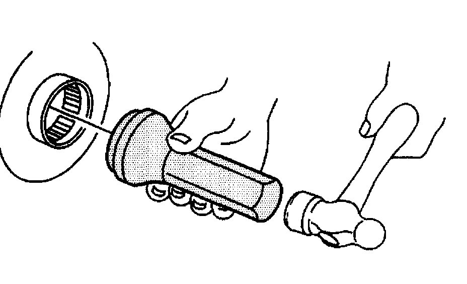

1. Install the axle shaft bearing using the J23690 (1) and the J 8092 (2).
2. Drive the axle shaft bearing into the axle housing until the tool bottoms against the tube.
pic 14
3. Install the axle shaft seal using the J 21128.
4. Drive the tool into the bore until the axle shaft seal bottoms flush with the tube.

That was great. So i am at the mechanic now. A different one. Everything was done and when he was trying to put the c clip back in my gears fell out. And now he can't seem to get them back in. Now what? Shoot me please.
Jun 17, 2019 at 7:24 AM
  • 110,194 POSTS
Ugh!! That can be a nightmare. LOL Kellie, I believe you are referring to the spider gears. Are there four of them? What I need to know is if the vehicle has an open or closed differential. Can you ask him?
I don't know if you remember reading this:
"Important: When removing the axle shaft, do not rotate the shaft. Rotating the shaft will misalign the gears. Misaligning the gears will make the installing of the axle shaft difficult."
I have a feeling he didn't. He turned the differential or axle when one or both of the axles was pulled clear of the carrier. Then the gears just fell out.
Jun 17, 2019 at 1:21 PM
KELLIE BAILEY
That is exactly what happened. He was under the truck. I was sitting by the rear left tire he took off and he asked me to turn it slowly.. Then all of a sudden i heard" that can't be good" and here we are. That wasn't nothing. Next. The last person who worked on this truck stripped the differential filler cap thing. So now we can't get the cap off to fill it back up. It is stripped. No extractors. Just plain bad luck. Finally i took a walk and said a prayer. Did some crying and came upon a real legit shop. went in and they were slammed. I explained to the gentleman my situation. This was at 11:15 this morning. After hearing all of this he said he really did not have the time and he shouldn't but can't watch me go through this. And said as long as i could get the truck there he would handle it for $50.00. And he said it would be fine to drive it like thirty seconds up the road. And that is what i did. Now we are good. I will never try and save money again. Because i ended up spending more. lol. Thank you for all. You guys are amazing!
