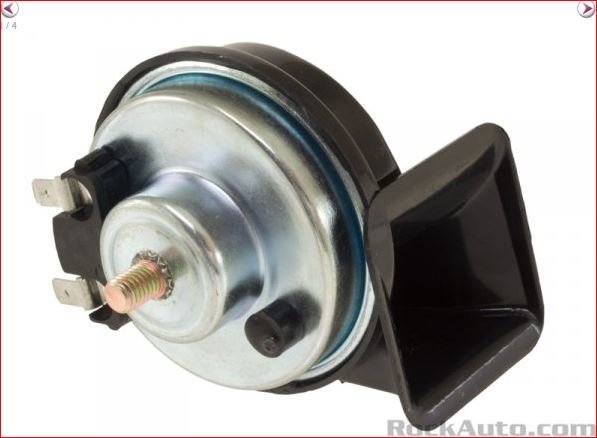

Not saying the horn does not work when you press the button. I'm trying to find where the horn is.
Jun 4, 2019 at 1:41 PM
Hi John,

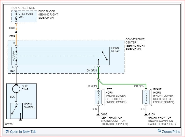

Are you talking about the part of the horn that actually produces the sound? If so, it will be a little speaker in the engine compartment. Unfortunately there is not a diagram that shows them but the wiring diagram lists they are in the left and right front lower side of the engine compartment.
I attached a picture of what they look like.
If you are referring to another component please let me know.
