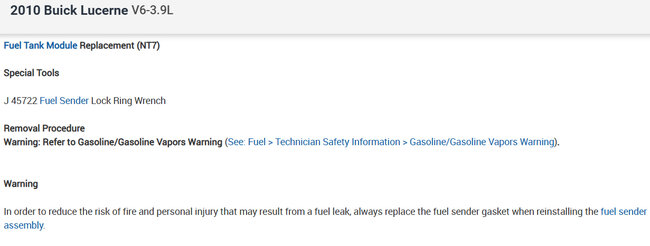

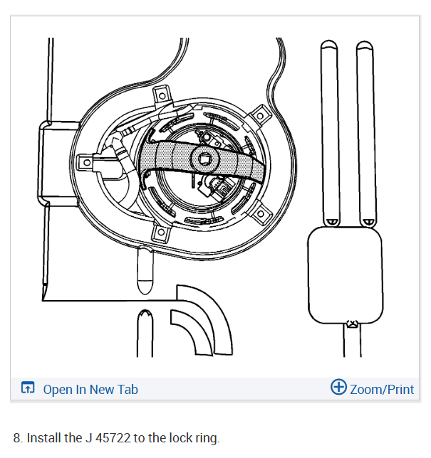

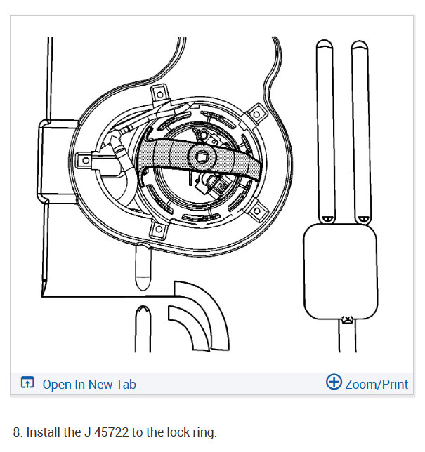

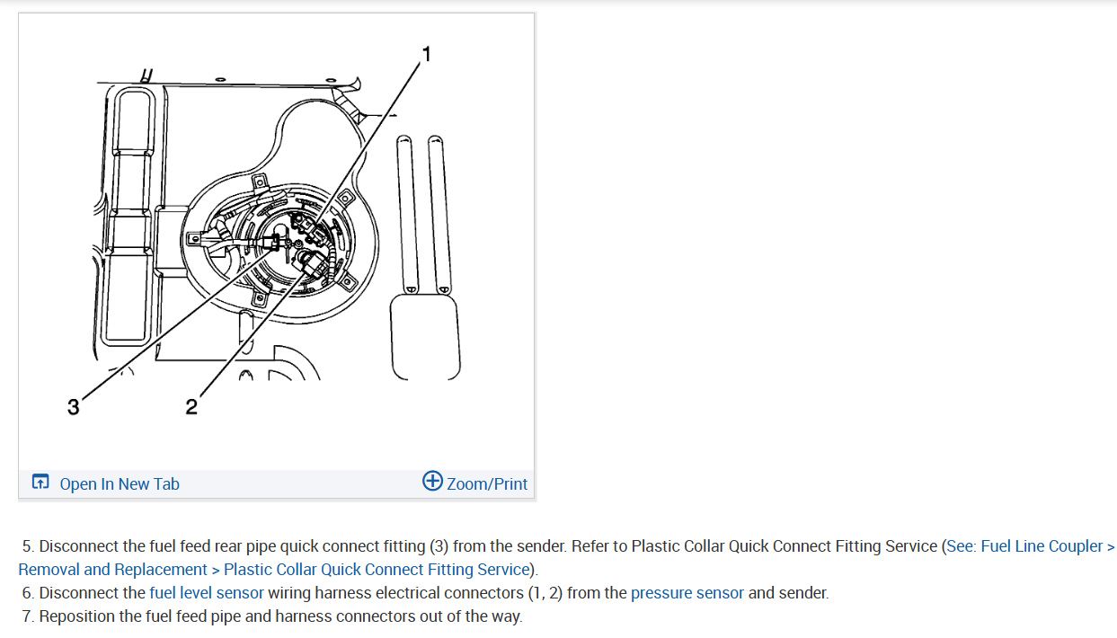

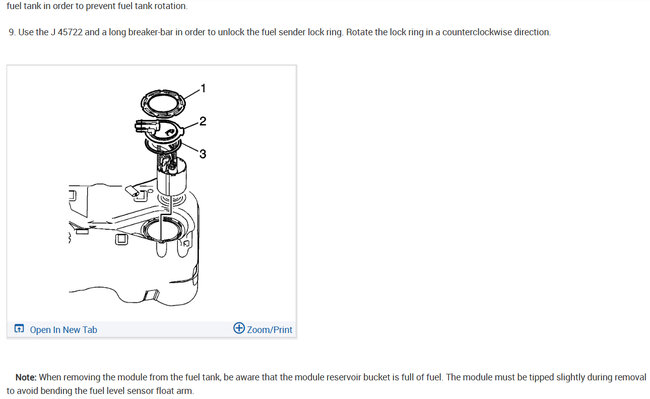

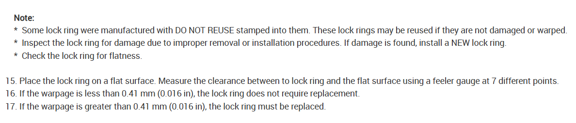

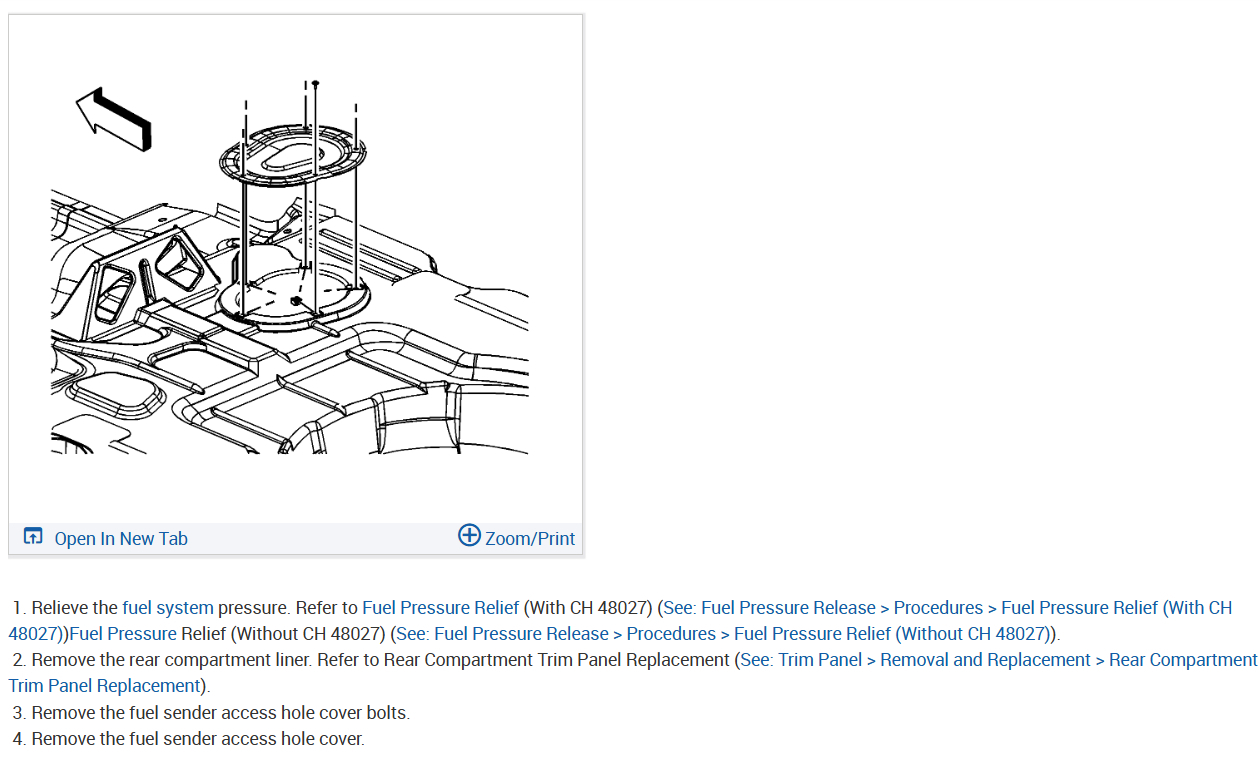

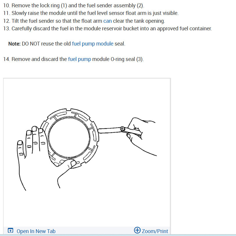

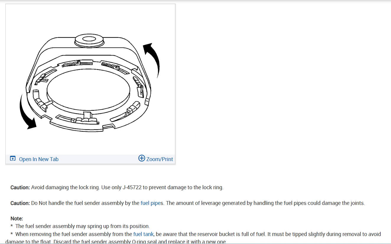

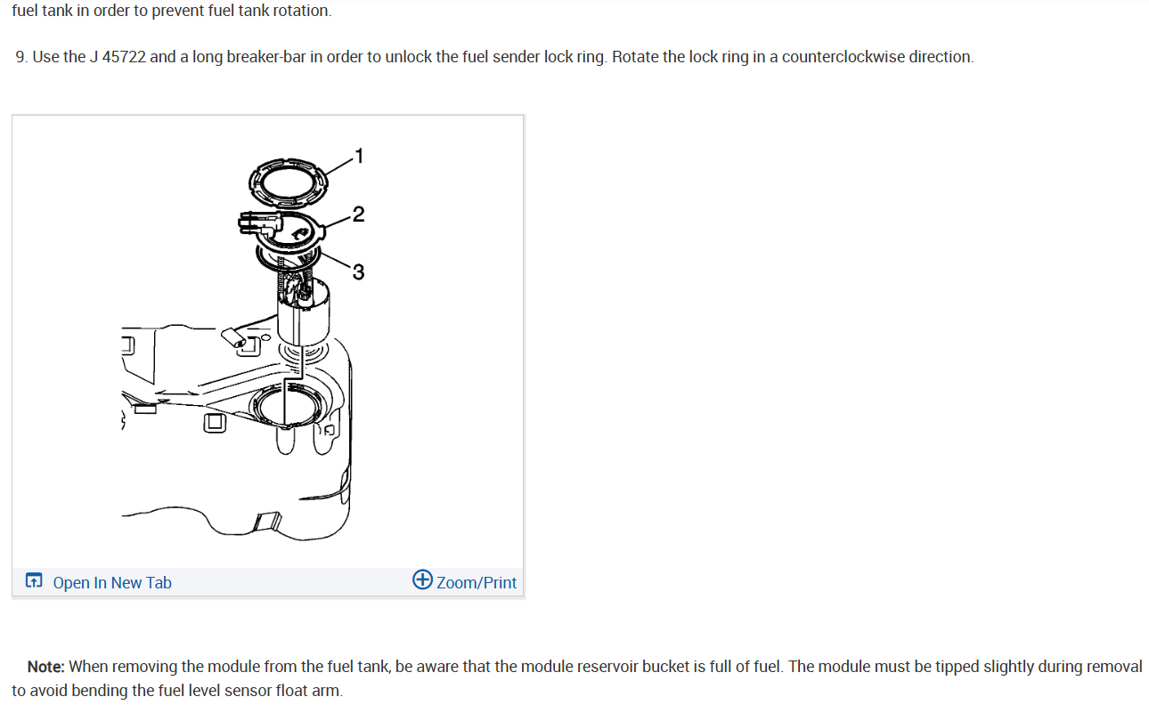

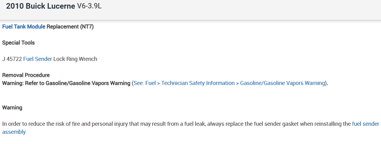

Excellent work on the fuel pump relay, I would get a small pic or Exatco knife to clean and enhance the connection for the fuel pump relay in the fuse panel. Also, the fuel filter is on the end of the fuel ump, they call it a fuel strainer, there is no fuel filter on the frame rail like older cars have. Here is how to change the fuel pimp out which I recommend as well. Thanks for the video, it helps. Check out the images (below). Let us know if you need anything else.
