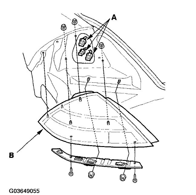

I need instructions on how to replace this tail light bulb assembly located in the trunk lid. I can't find any instructions on how to take out he old bulb

this is for a 2 door 4 door is similar
Remove the rear bumper (see REAR BUMPER REMOVAL/INSTALLATION ).
Open the trunk lid and remove the trunk side trim panel (see TRIM REMOVAL/INSTALLATION - TRUNK AREA ).
Disconnect the connectors (A) from the taillights (B).
Fig. 41: Disconnecting Connectors From Taillights ('03-05 Models)
Fig. 42: Disconnecting Connectors From Taillights ('06-07 Models)
Remove the mounting nuts and screws, then remove the taillight.
Turn the turn signal light bulb socket 45° counterclockwise to remove the bulb.
Turn Signal Light: 21 W
Fig. 43: Turning Signal Light Bulb Socket Counterclockwise
Inspect the gasket; replace it if it is distorted or stays compressed.
Install the taillight in the reverse order of removal and tighten the nuts to 5 N.m (0.5 kgf.m, 4 ldf.ft).
After installing the taillight, run water over it to make sure it does not leak
