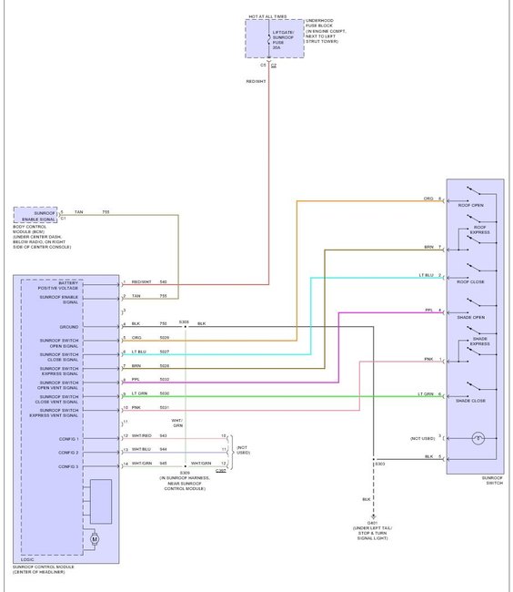

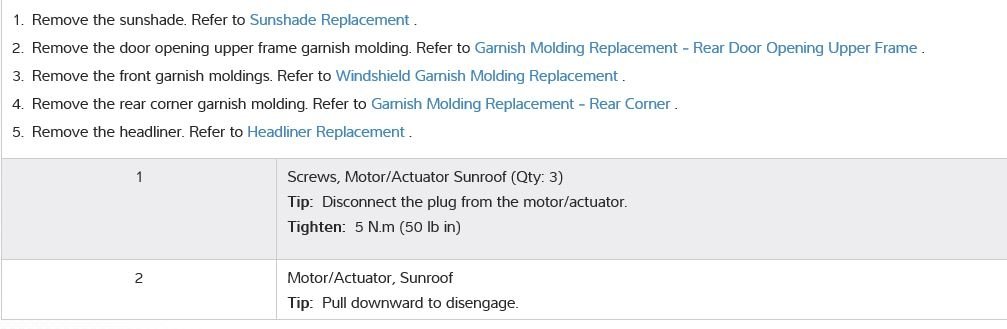

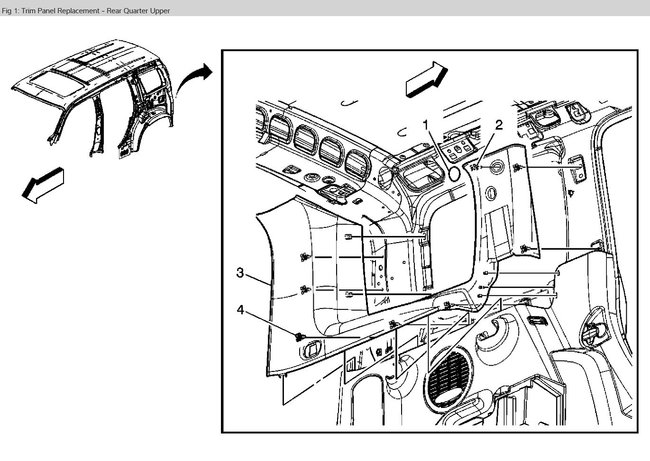

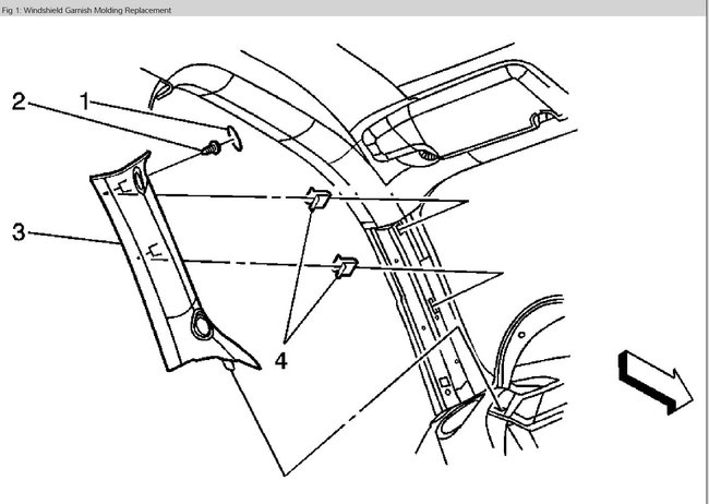

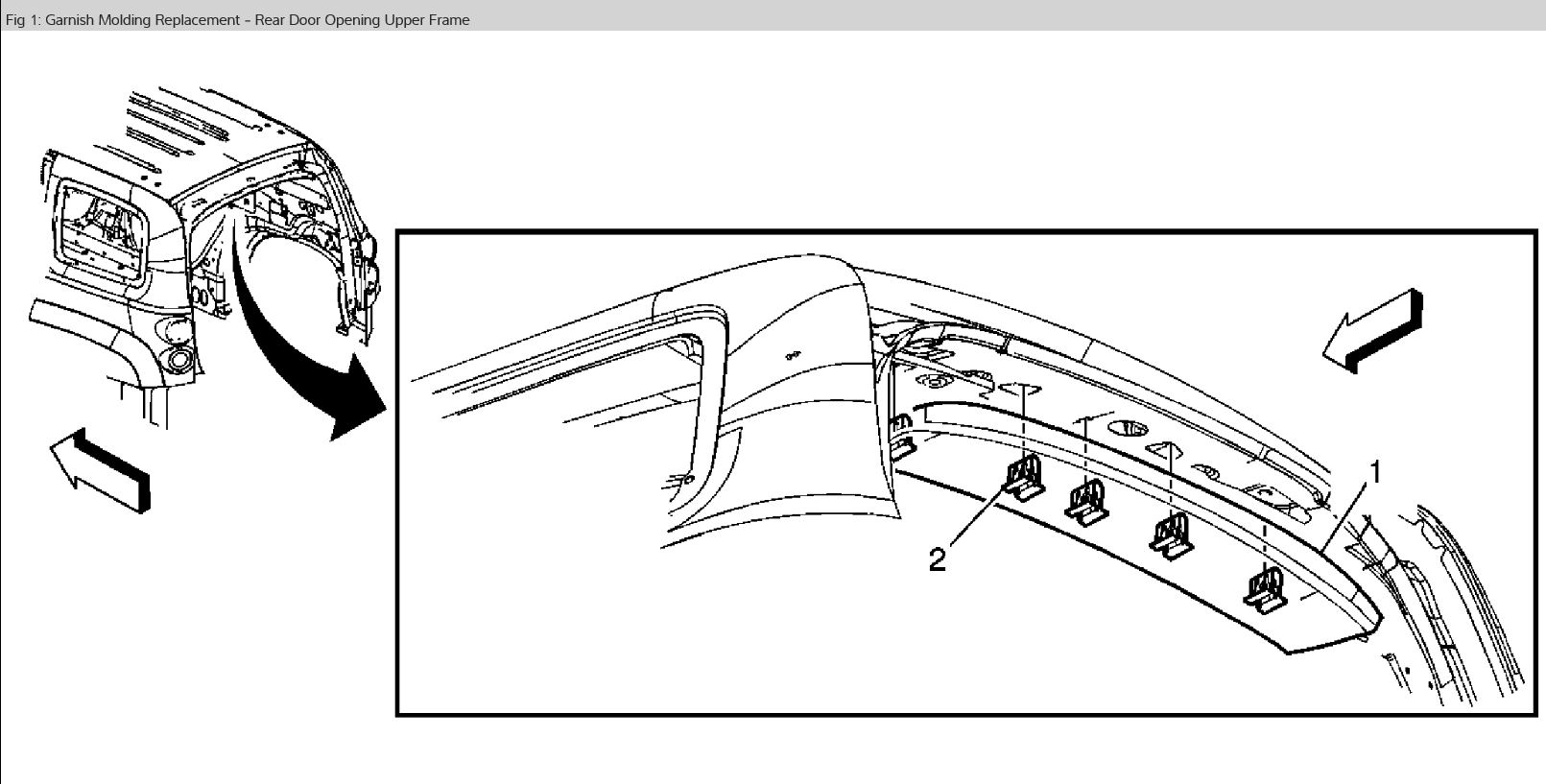

The sun-roof won't open, or close. It might be the switch, or the motor itself. You guys are the experts and I value your opinion. BOB
May 30, 2019 at 11:12 PM
PATENTED_REPAIR_PRO
  • 1,853 POSTS

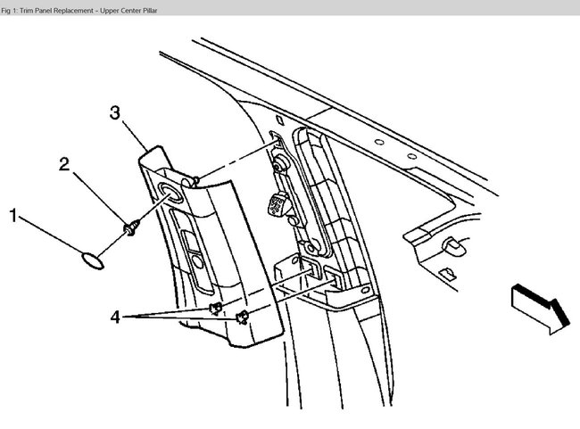

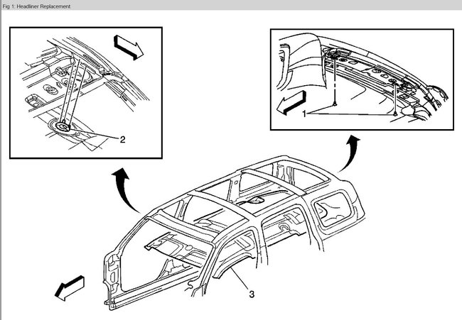

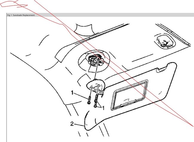

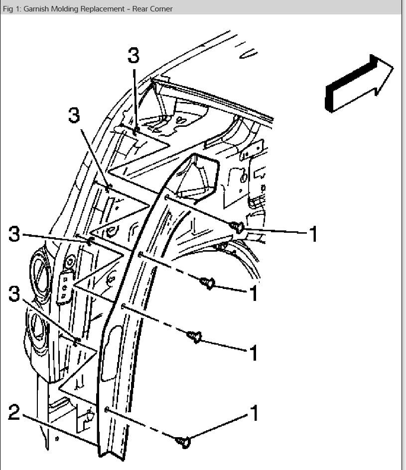

Here are those instructions for replacing that sunroof motor.
In case you didn't check the fuse, it's a "lift-gate/sunroof" fuse in the under hood fuse block. Here is also the wiring diagram:
