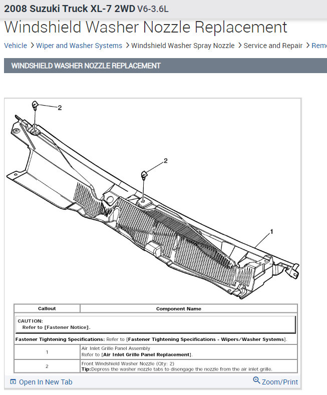

My washer fluid is clogged I tried to unclog it without taking off the spray nozzles and made it worst. in order to remove clogged windshield sprayer nozzles?
Dec 19, 2015 at 2:52 AM
SQM
  • 6,383 POSTS

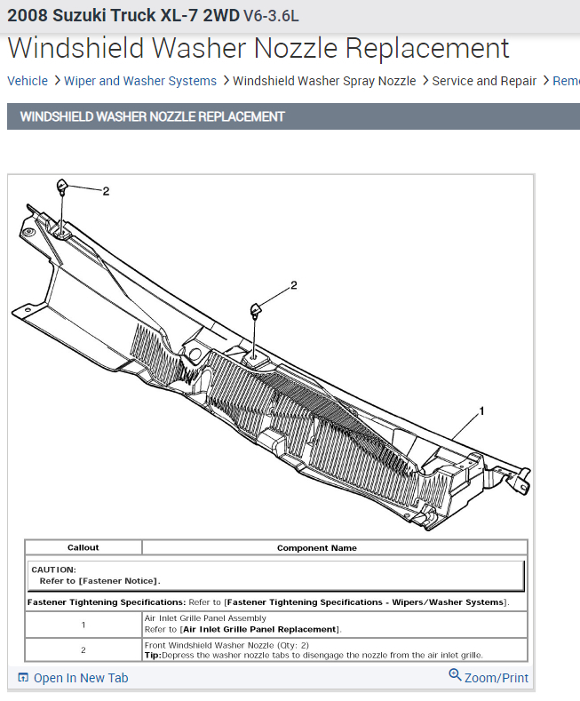

In order to replace the washer nozzle you will have to take off the air inlet grille panel assembly at the bottom of the windshield.
It will come off as you take off the plastic fasteners.
Then you will be able to release the clips from the bottom that is holding the washer nozzles in place.
https://www.2carpros.com/articles/how-to-replace-windshield-wiper-blades
I have attached diagram for your reference.
