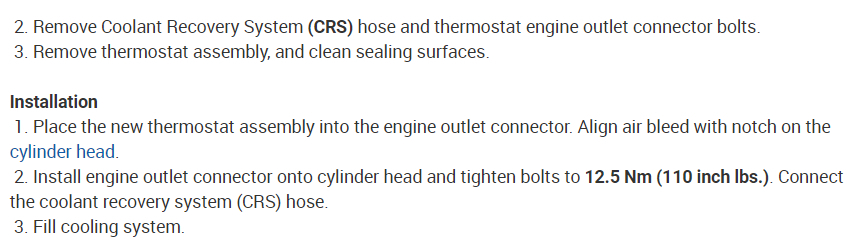

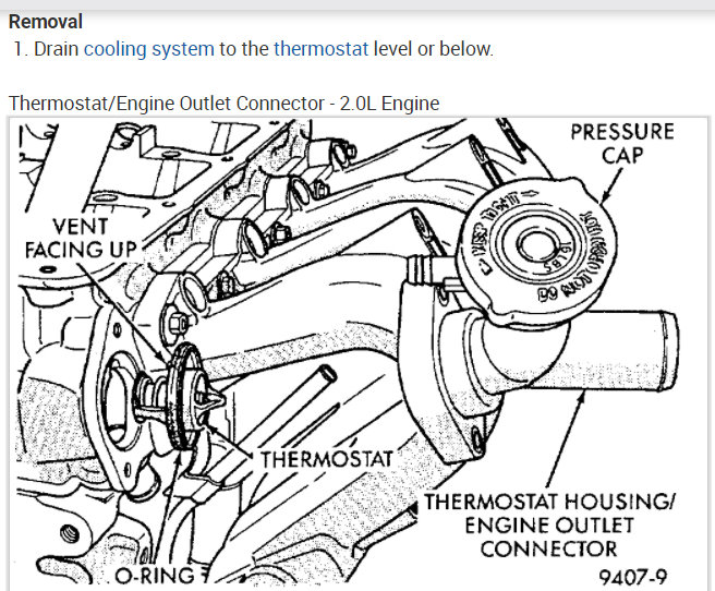

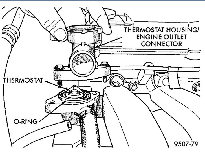

I can't seem to remove thermostat to replace it? What do i do step by step?

Hello again.
Here is a tutorial showing removal and replacement of a thermostat:
I've attached picture replacement steps below for your car. Hope this helps and thanks again for using 2CarPros.
