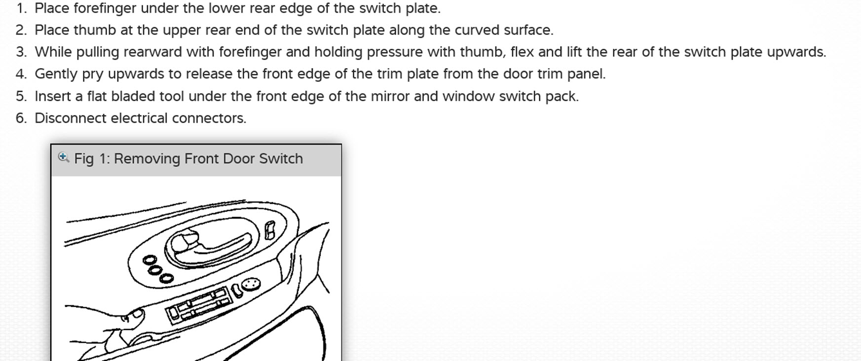

How do I remove the switch assembly from the drivers door? Windows will not open and only the drivers door lock opens.

check fuses and circuit breakers inside car and under hood first. for door locks check relays under hood.

see picture for switch removal.
