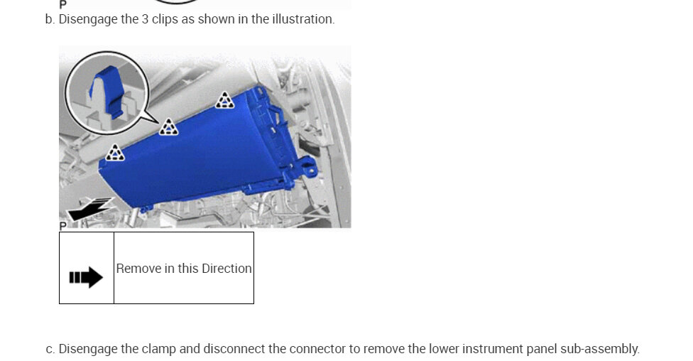

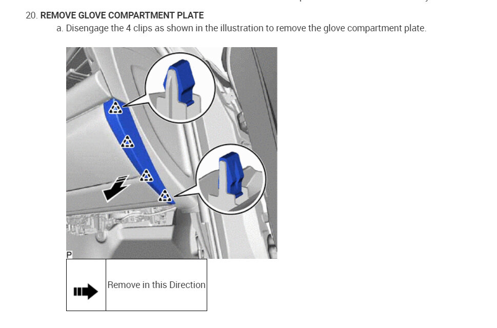

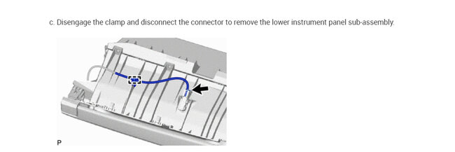

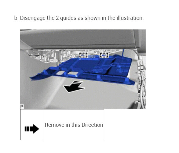

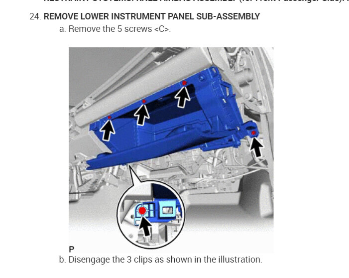

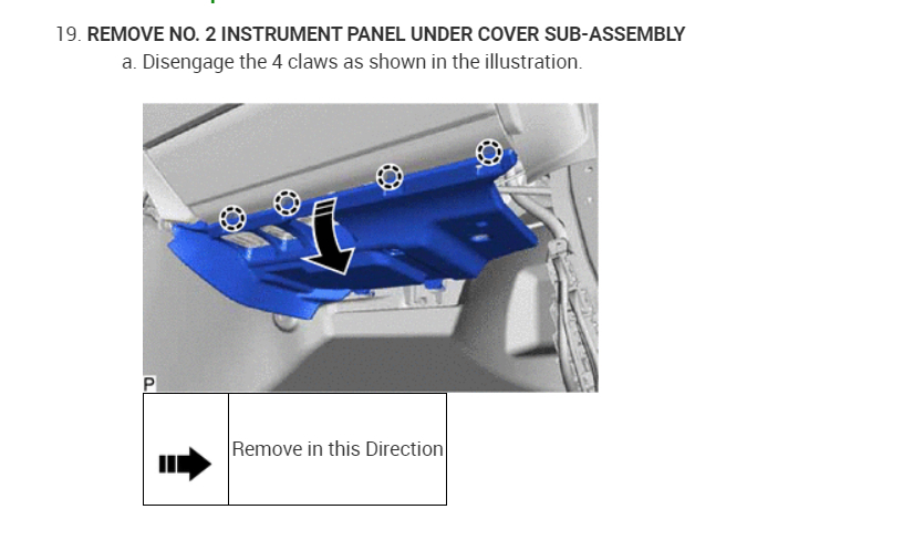

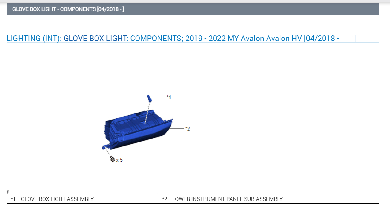

I’m trying to access the Driver support unit on my car listed above. How do I remove the glove box compartment to access it?
Jan 27, 2023 at 10:40 PM
  • 55,423 POSTS

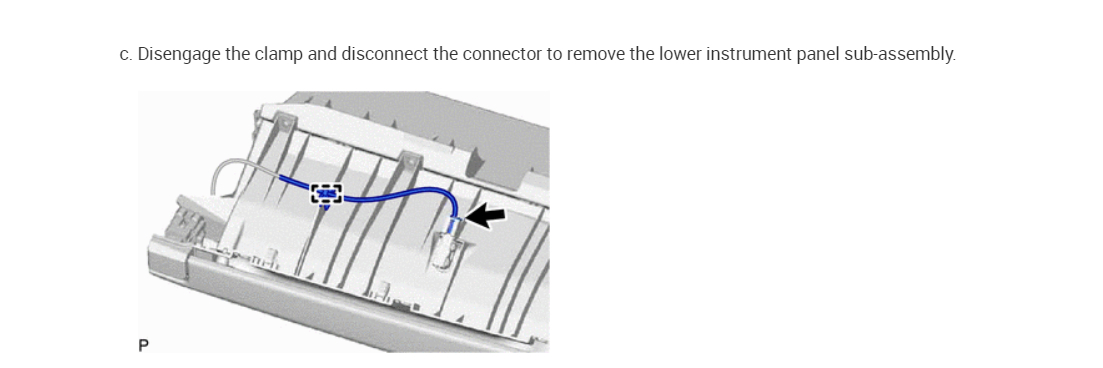

The glove box is a signal unit which is held in by Phillip head screws on the bottom and door jamb of the glove box cover, here is the location of the screws in the image below. Let me know if you have any questions and please upload a picture or short video of any problems you have so I can help walk you through the repair.
