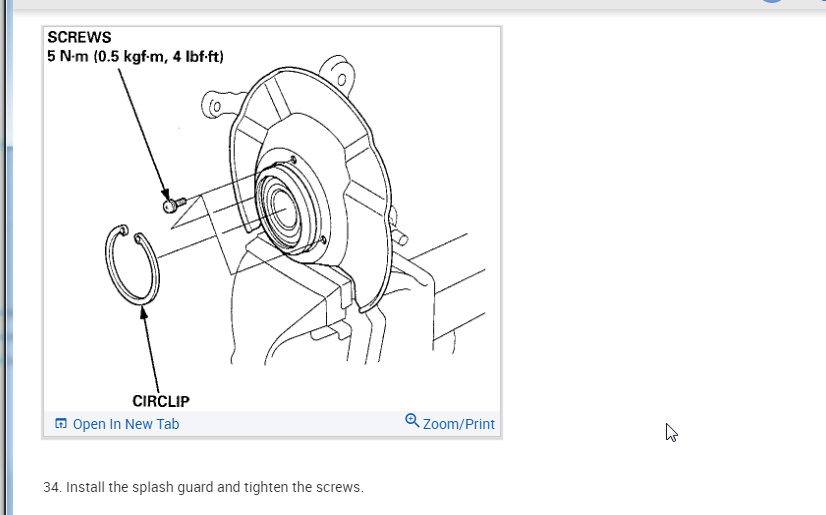

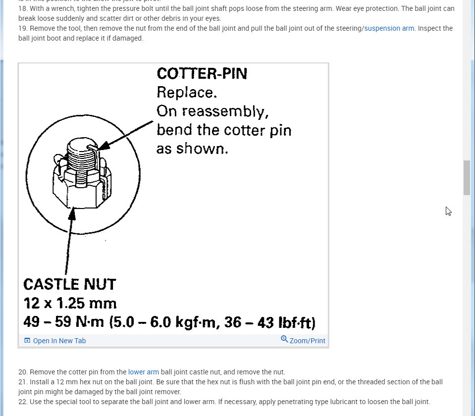

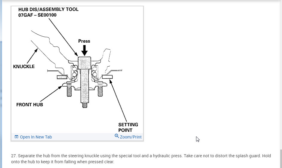

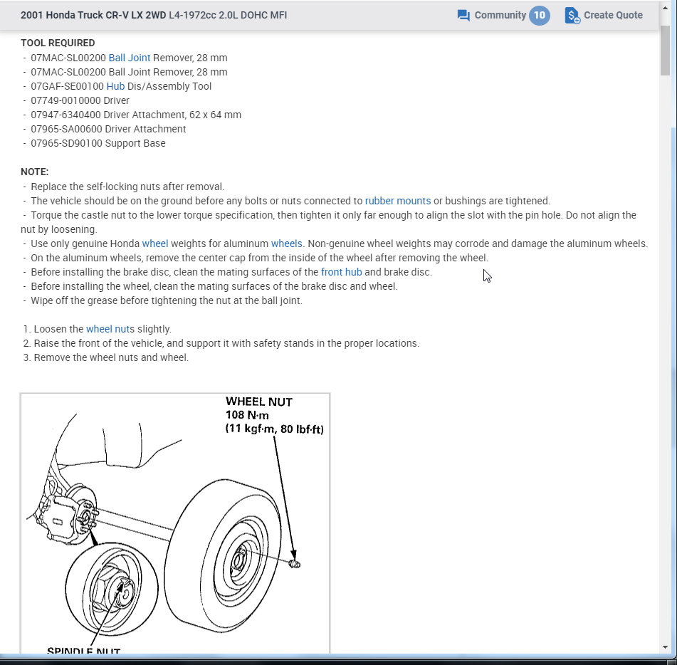

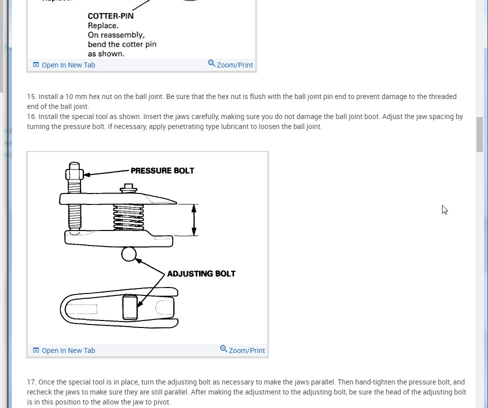

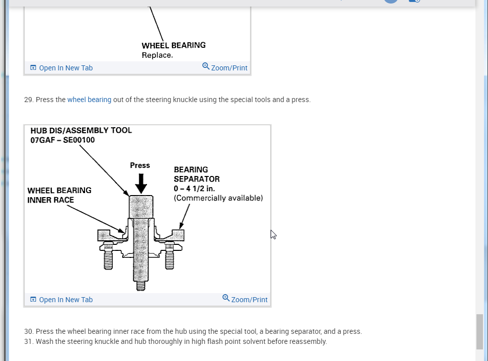

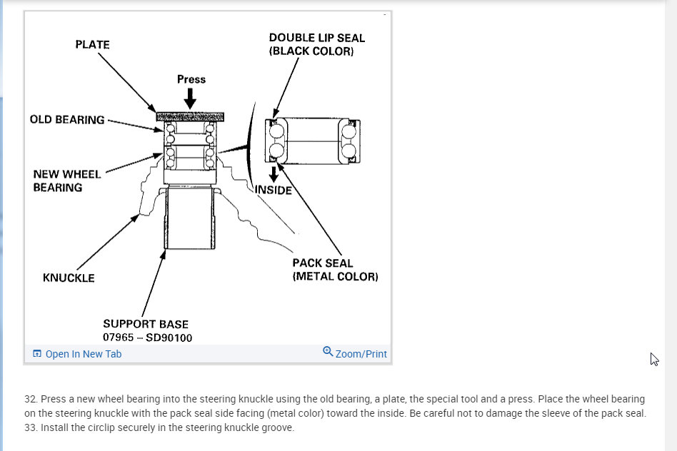

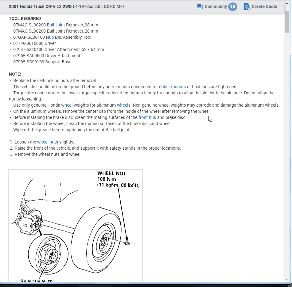

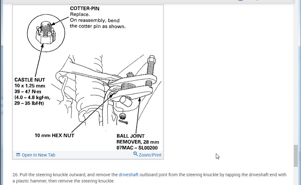

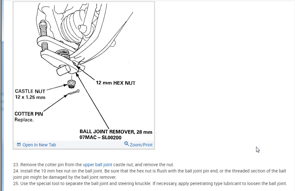

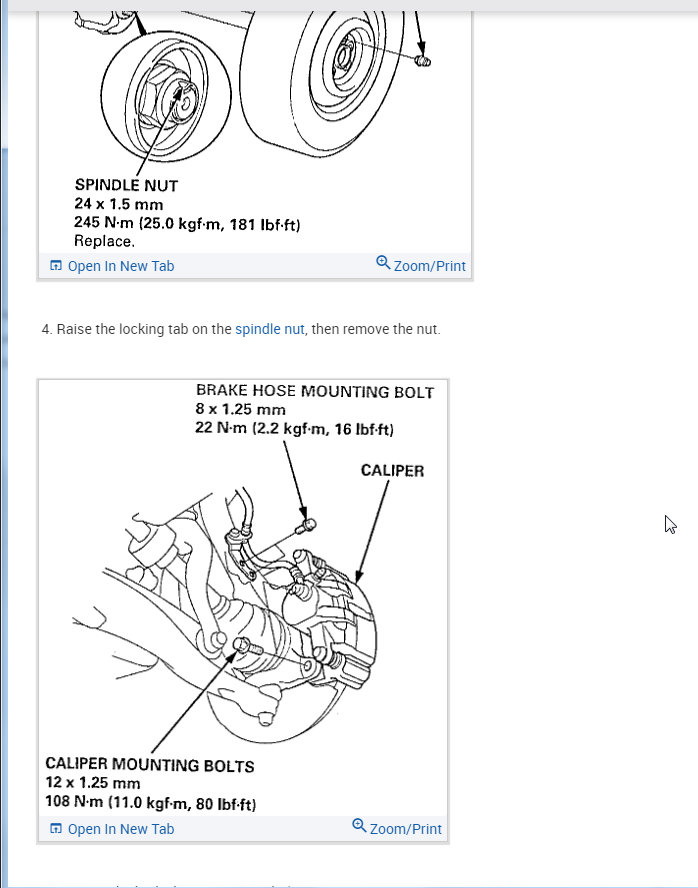

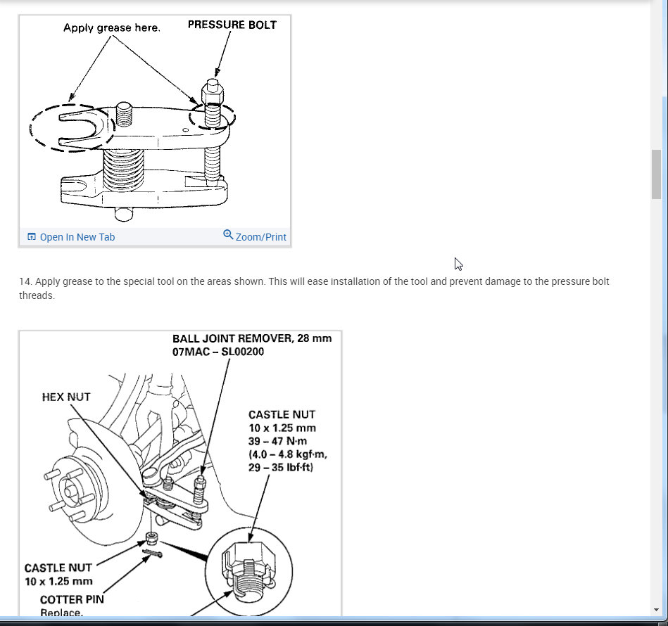

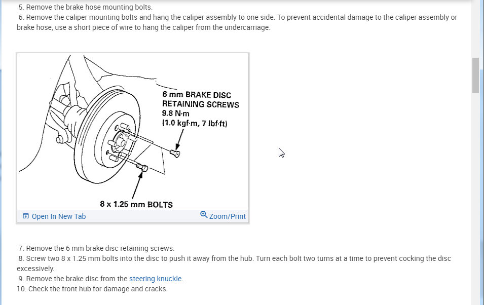

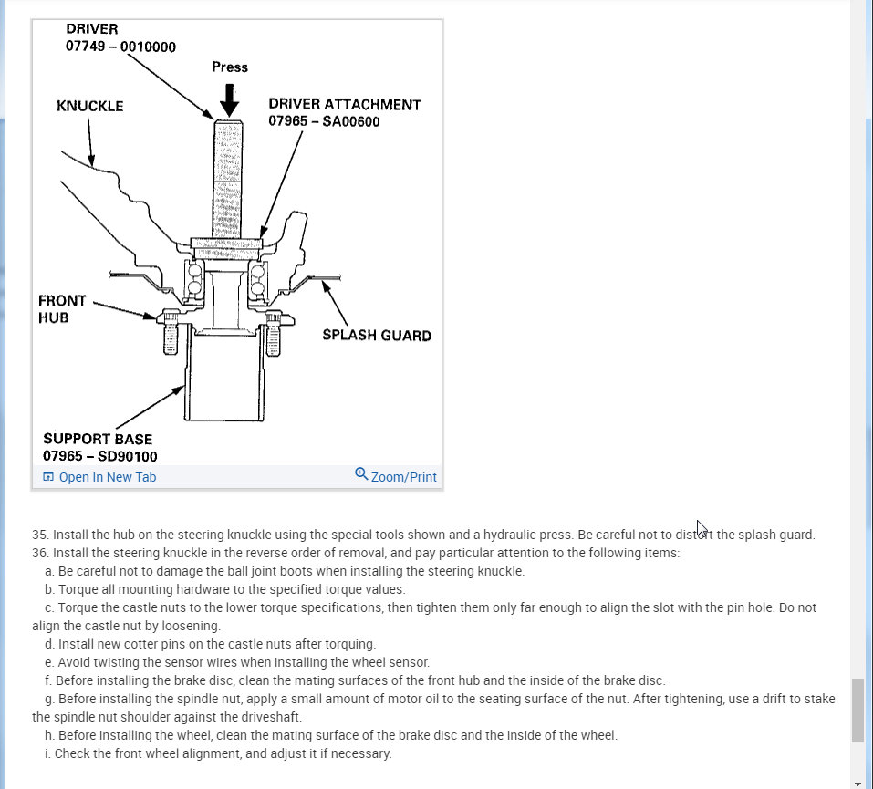

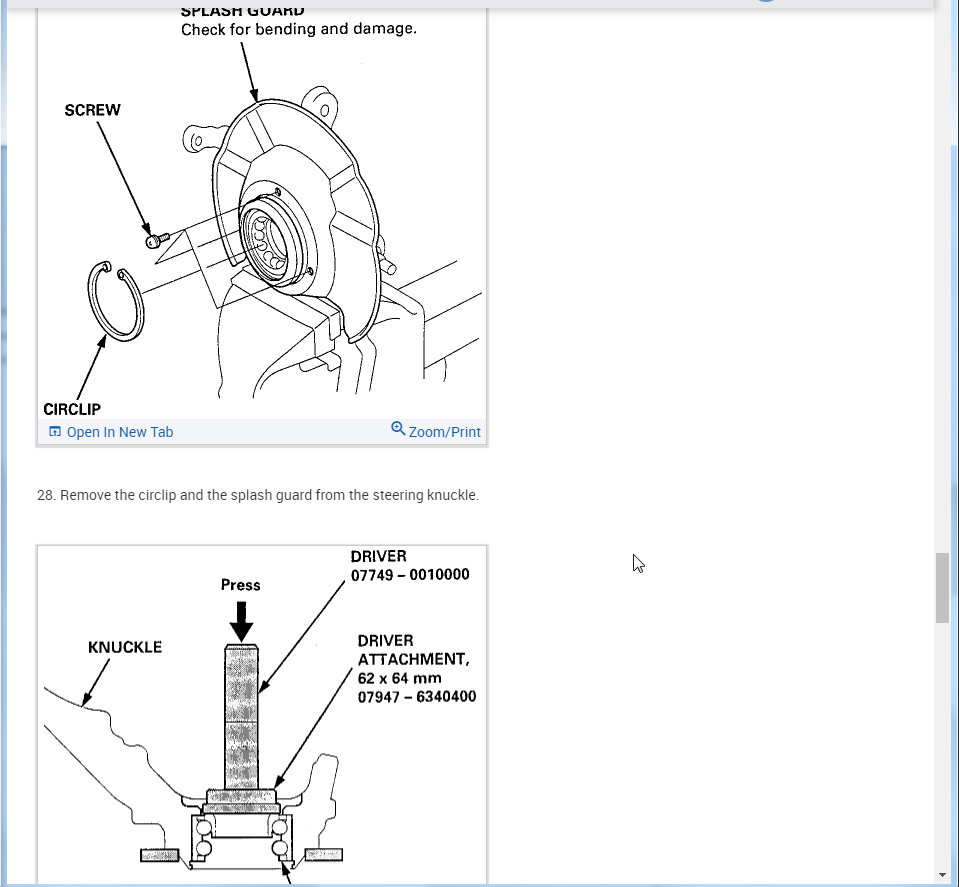

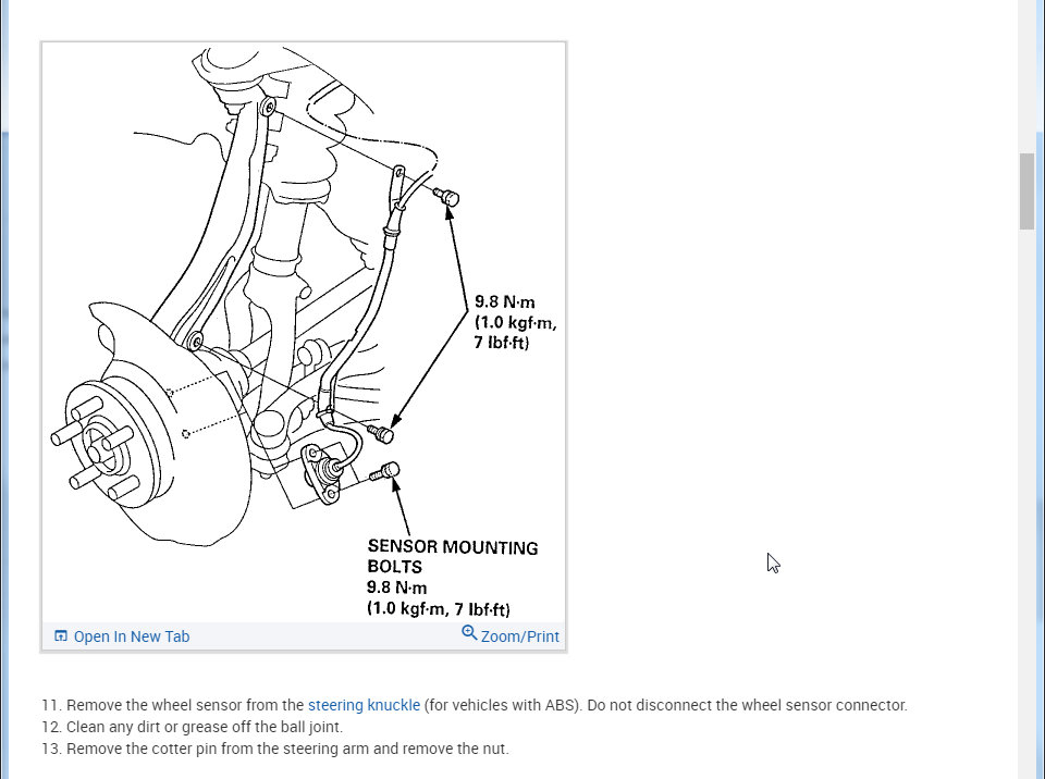

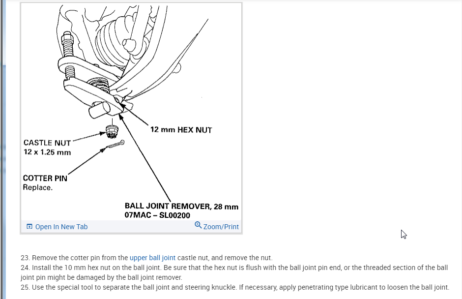

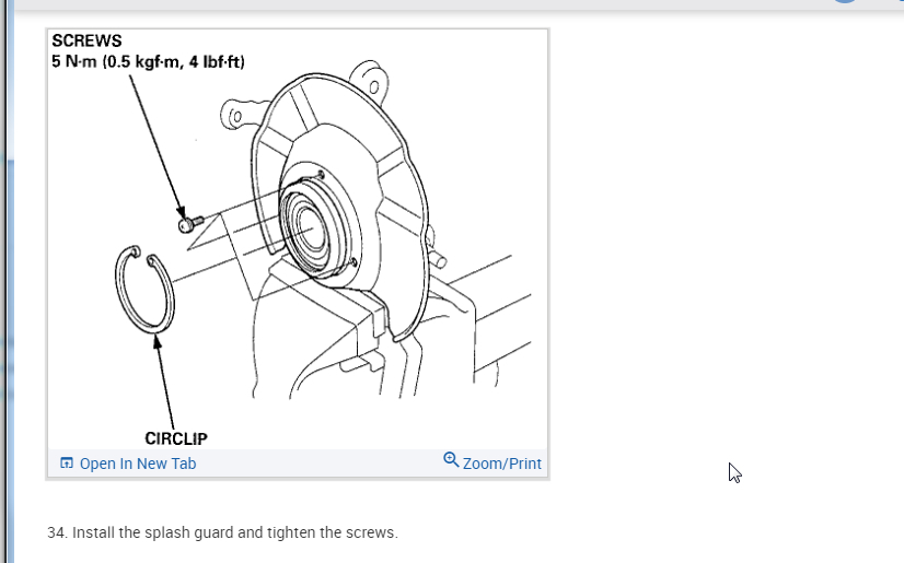

I need to remove and replace the front passenger side wheel hub and I have never taken a wheel hub off before. How do I do it and what tools do I need?
Aug 3, 2020 at 6:29 AM
I attached the process for the wheel bearings on the front. Take a look at this material and let me know if there are questions. Check out the diagrams (Below). Please let us know what happens. Thanks
