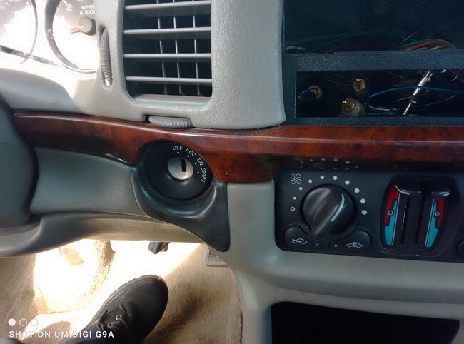

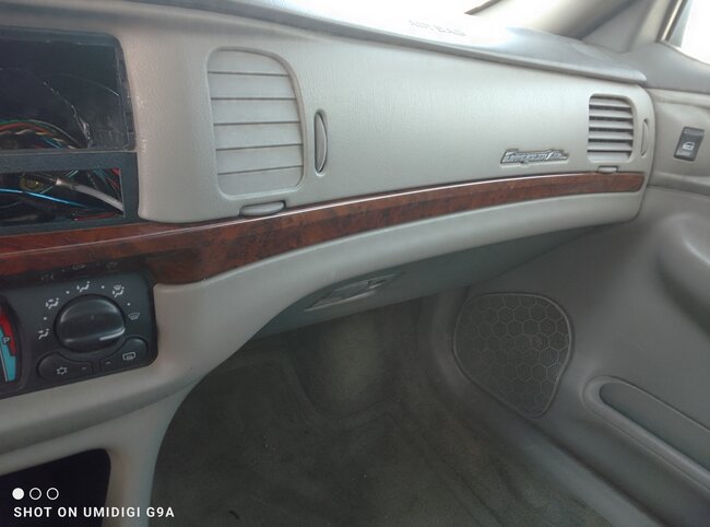

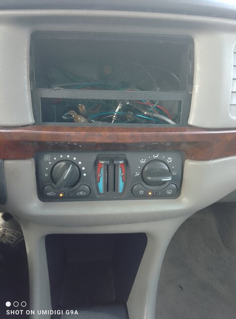

I am wanting to install a stereo in my car listed above, and I can't figure out how to remove the wood looking, trim piece that goes from the steering wheel all the way to the passenger side door. It's one whole piece and I can't find a clip or screw or anything. I tried giving it a firm tug but that didn't jar anything loose.
Any suggestions?

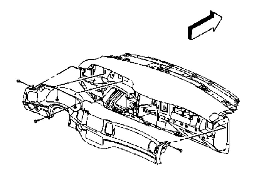

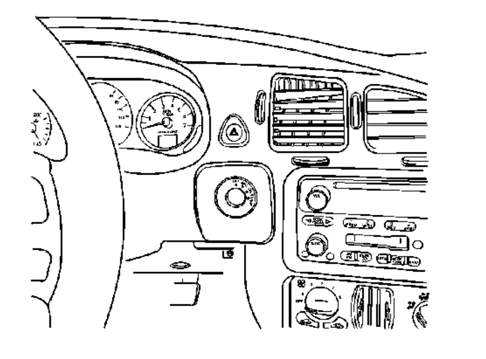

Hello, this piece is made into the instrument cluster bezel, and cannot be removed. You will need to remove the entire front plate to accomplish this. However, this is not necessary to install a new radio, unless your aftermarket stereo is much bigger than the spaces shown in your photos. Nevertheless, I will provide instructions to remove this bezel for you with pictures.
Removal Procedure
1. Apply the parking brake.

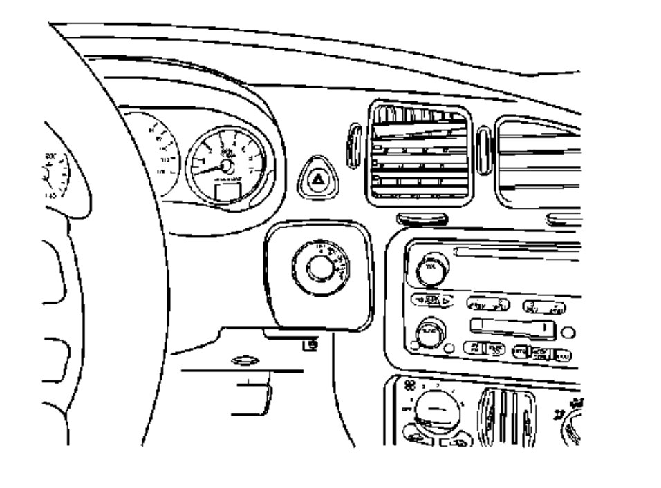

2. Using a small flat-bladed tool, remove the bezel from the ignition switch cylinder.
(image 1)

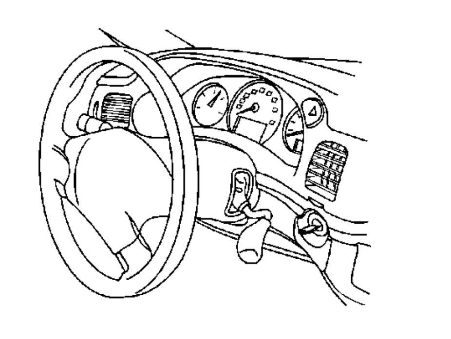

3. If the vehicle is equipped with a column shift, position the transaxle shift control indicator to 1. Keep the key in the ignition switch cylinder.
(image 2)
4. Adjust the steering wheel for access.
5. Remove the steering column filler panel.
6. Remove the instrument panel (I/P) fuse block access hole covers.
(image 3)

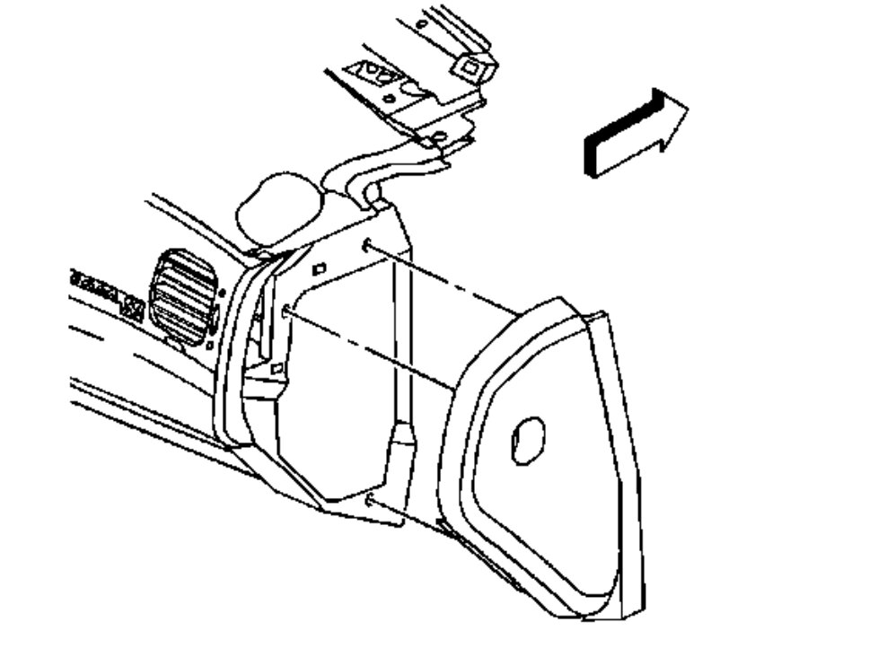

7. Remove the screws from the I/P cluster trim plate.
8. Starting at the right end of the I/P cluster, grasp the trim plate and pull rearward.
9. Continue working around the I/P cluster trim plate until all of the retainers are released from the I/P trim pad.
10. Disconnect the electrical connectors from the hazard switch and from the traction control switch, if equipped.
11. Remove the I/P cluster trim plate.
(image 4)

Thank you for those tips. It made takin out the dashboard super easy.
After I got off and had a look, I figured I could fit a 9" doubleDIN android stereo. It's taken me this long to modify, fabricate a couple pieces, refit , repeat, and now just today i finally hooked up the power and rear speakers...I will take a couple pics and post them here.
