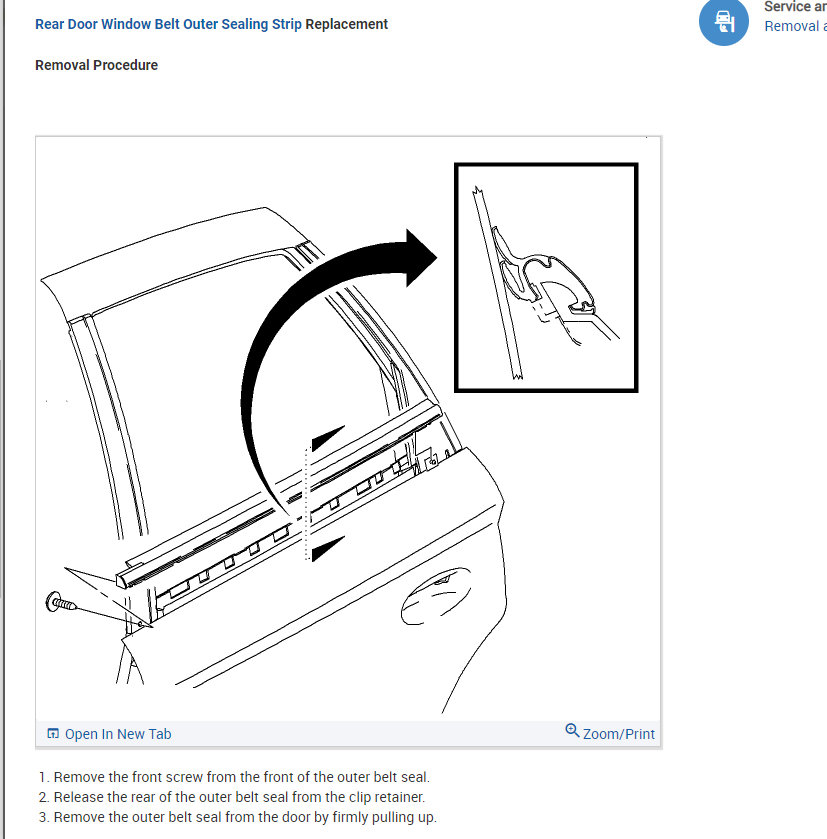

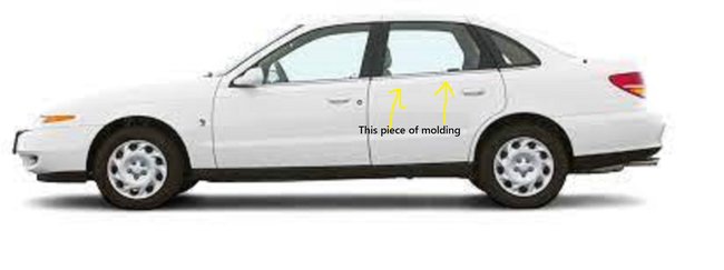

Trying to replace a broken black piece of trim on my car listed above.
Part Number Part Name
22671222 Applique
I need to remove the rear door outside window belt molding to install it.
I have no Idea how to remove this piece of molding. Any help?

I am referring to the window belt molding trim that is chrome and rubber that spans the window opening on the outside of the door.
Sep 28, 2021 at 1:45 PM

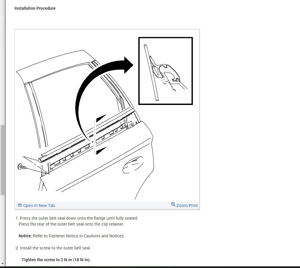

Just to jump in, this is called the belt outer sealing strip.
I am attaching the info below on how to remove this.
You need to remove the screw from the front of the strip that I think you need to remove the door panel to access.
https://www.2carpros.com/articles/door-panel-removal
Then it slides backwards and pulls up.
Please run through this and let us know what other questions you have. Thanks
