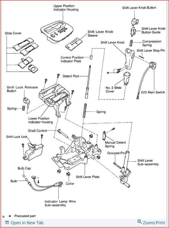

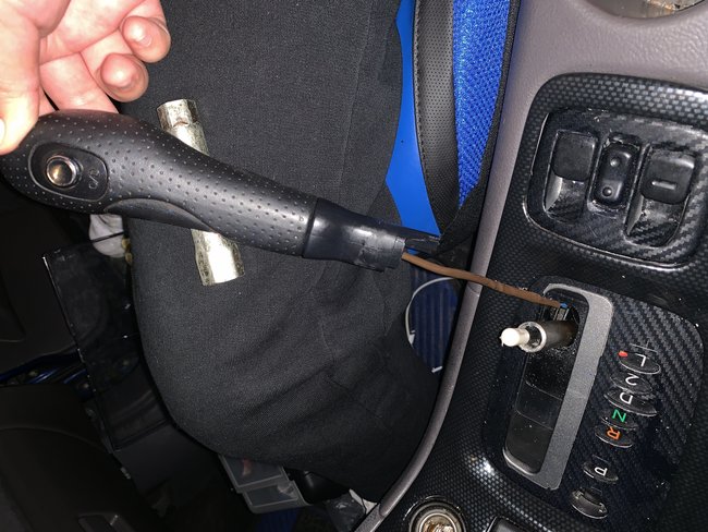

There is a cable attached to it and I don’t know how to remove it. may someone please help? My car is the GTS model.
May 2, 2019 at 10:31 AM
Hi Elsy,

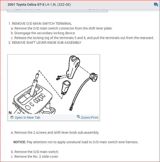

Looks like that is the wiring harness that goes to your O/D button on the shifter.
Here is the procedure but if you don't need to take the shifter apart, you can unhook it from down on the transmission and just pull it out as one piece. That may be easier.
Let me know if you need more info or help and I can get it for you.
