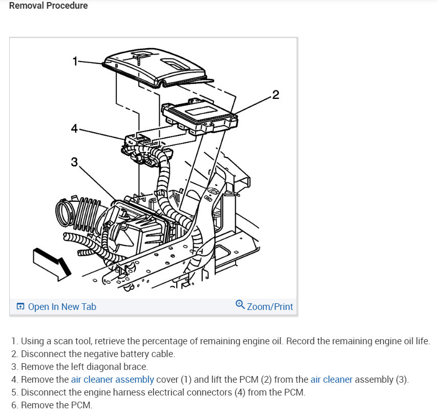

I just got a new PCM for the Buick, the old one is removed. How do I install the new one? Do I leave the battery detached for an hour? Do I have to reset anything? Please help. 22-year-old confused female.

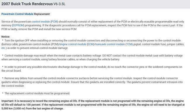

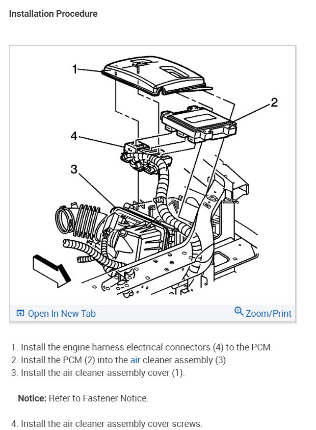

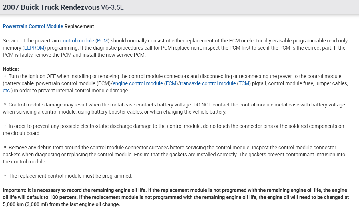

Do you have the old PCM? You might want to take the new PCM back and get a preprogrammed unit by searching Google or Ebay. The old PCM has a setup program that needs to be transferred to the replacement PCM. Here are the official instructions but like I say if you get a preprogrammed unit, you can bypass the programming step unself.
Powertrain Control Module Programming and Setup
The following service procedures require either a programming or a setup event performed for a complete repair.
PCM Replacement
If the powertrain control module (PCM) is replaced, the following procedures must be performed:

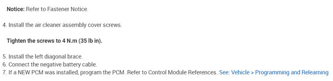

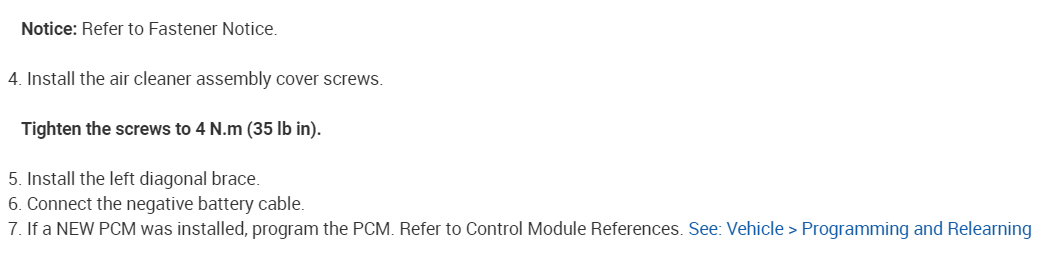

1. PCM Reprogramming-Refer to Service Programming System (SPS). See: Vehicle > Programming and Relearning
2. Crankshaft Position (CKP) Variation Learn-Refer to Crankshaft Position System Variation Learn.
3. Theft Deterrent-Refer to Programming Immobilizer System Components. See: Vehicle > Programming and Relearning
The PCM will learn the incoming fuel continue password immediately upon receipt of a password message. Once a password message is received, and a password is learned, a learn procedure must be performed to change this password again. A PCM which has been previously installed in another vehicle will have learned the other vehicle's fuel continue password, and will require a learn procedure after programming to learn the current vehicle password.
4. Engine Oil Life Remaining-When available, use a scan tool to reset the Engine Oil Life Remaining back to the original percentage recorded before the module was replaced.
5. Transmission Fluid Life Remaining-When available, use the scan tool to reset the Transmission Fluid Life Remaining back to the original percentage recorded before the module was replaced.

Check out the images (below). Let us know how it goes.
