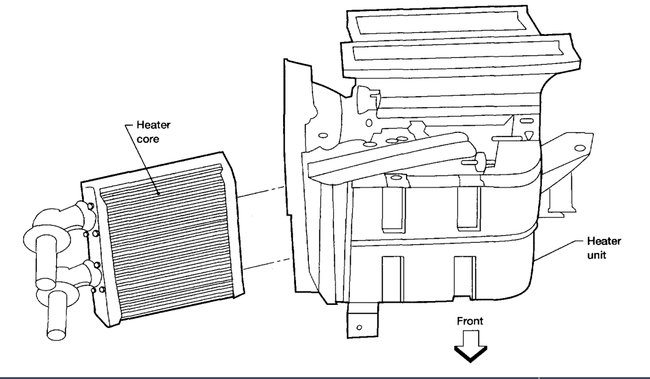

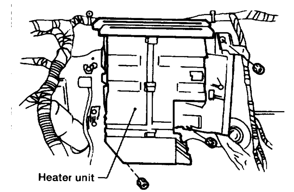

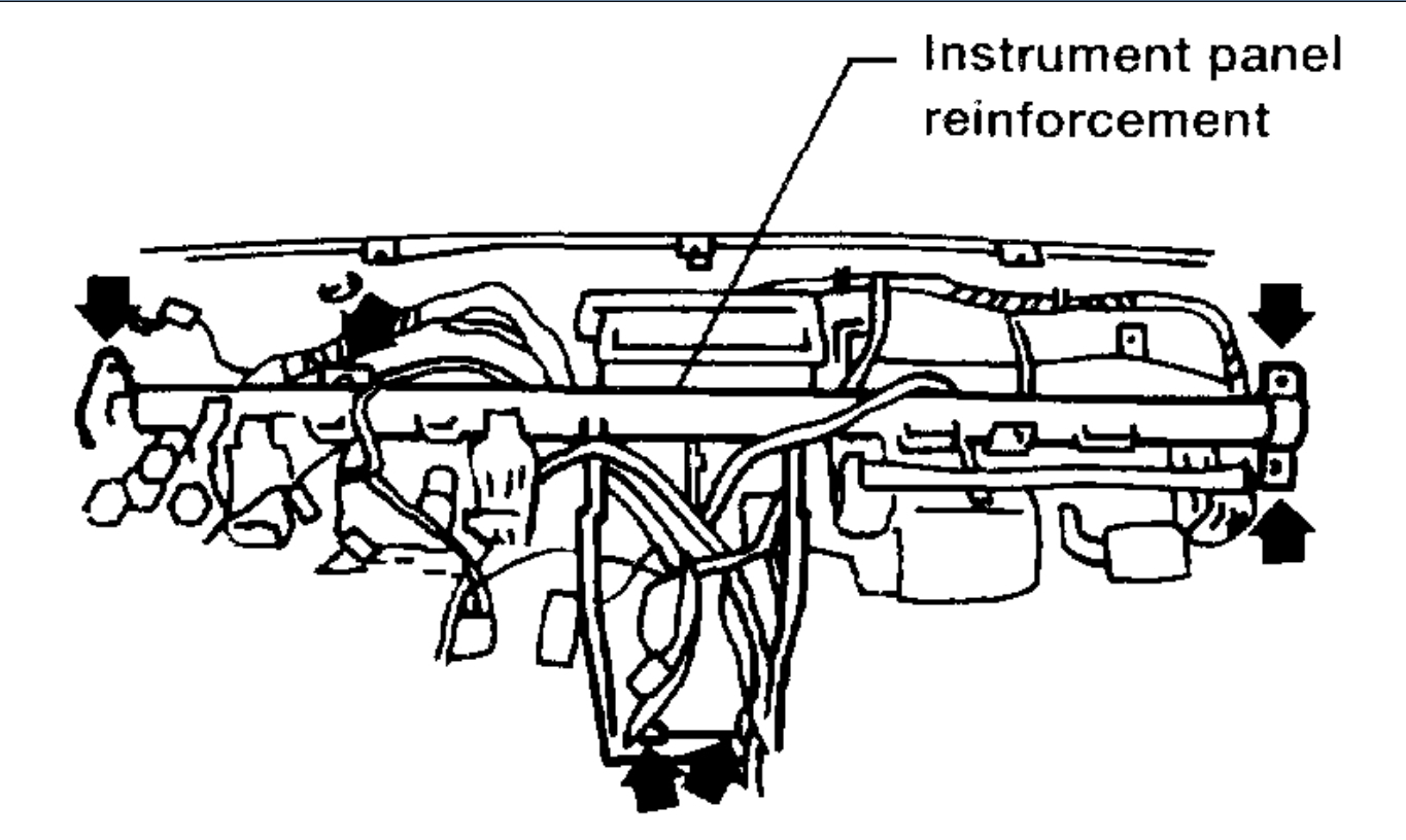

How do I get the heater core out?
1998 NISSAN SENTRA
228,768 MILES • 1.6L • 4 CYL • 2WD • AUTOMATIC
AZDANNO04
  • 343 POSTS
I found pieces of the inlet pipe. Went under dash passenger side. Removed the glove compartment. Removed the first big black box from the A/C lines. saw the cable from the climate switch cable. Looks like I have to disconnect that as well in order to this black casing out.
Dec 20, 2020 at 1:38 AM
  • CAR REPAIR CONTRIBUTOR
Good morning,
I attached pictures and procedure for the replacement for you.
https://www.2carpros.com/articles/replace-heater-core
It is a tight fit to get the box back enough to release the lines.
REMOVAL
1. Drain cooling system.
2. Discharge the A/C system. Refer to "DISCHARGING REFRIGERANT".
3. Disconnect the heater hoses from the engine compartment.
4. Remove the instrument panel.
5. Remove the instrument panel reinforcement.
6. Remove the cooling unit..
7. Remove the heater unit.
8. Remove the heater core.
INSTALLATION
Installation is the reverse of removal. Inspect cooling system for leaks.
Inspect A/C system for refrigerant leaks.
