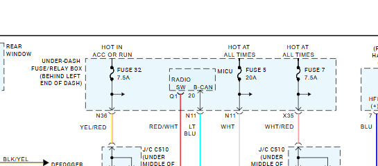

hi i have an 04 acura tl 6speed manual and i just recently did an engine swap using a motor from an automatic donor car i got a new engine trans harness as well and when every thing was done the car runs but i have no power to my radio nav or climate controls and its stuck blowing cold air since last time it was driven was summer
Jan 21, 2026 at 2:10 AM
  • 55,433 POSTS

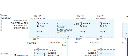

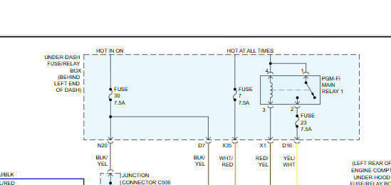

Did you check the fuses? If not I would check the 3 fuses that run the system, here is a guide to help and the fuse locations in the image below.
Have the key on on when checking the fuses. Check out the images (below). Let us know how it goes
