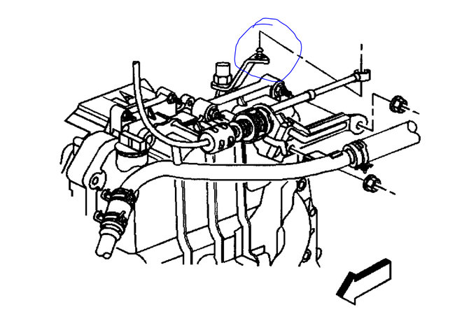

My car is parked in a position that cannot get to it without being able to put me in neutral and move it to put it on a trailer. I need to know how to get it shifted from Park to Neutral so that I can move the car and get it put on a trailer. I lost my keys and do not have my keys. how can I do this without breaking my car completely. quickest and easiest fastest way. please help me with this problem. thank you for your time and consideration in this matter.

Good afternoon,
I attached a picture of where the shift cable attaches to the transmission. The end of the cable just releases with a screwdriver. It pops up in the air. Then you can turn the lever manually to get it out of the park.
