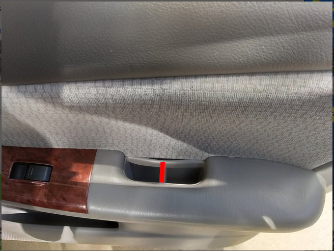

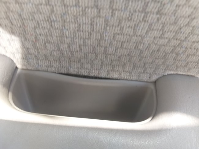

It came slightly off. I am guessing I will be asked to attach a picture, so I attached two pictures.

Most likely that portion was glued on and has just come loose. What I would do is remove the door panel and just find out if there are screws or bolts that hold that handle on. More then likely there will be two but I doubt they will tighten enough to remove that.
https://www.2carpros.com/articles/door-panel-removal
If it does not then I would put some sort of glue or adhesive in there and push that portion back in place. Then set something up so that it stays in place until it dries. Otherwise, you would need to replace the door panel or handle if they are available.
Thanks for the pictures that really does help. Let me know if you have questions on this and we can go from there.

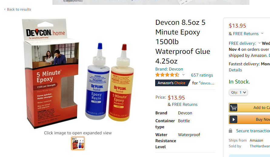

I think the issue is you are trying to adhere it to fabric. That does not make a good mating surface. However, I would try this stuff. It is not specific for fabric but they use this for making handle material on custom knives and most of the time they are some sort of fabric or natural material.
If this doesn't work, then it is warped so bad that it will not hold.

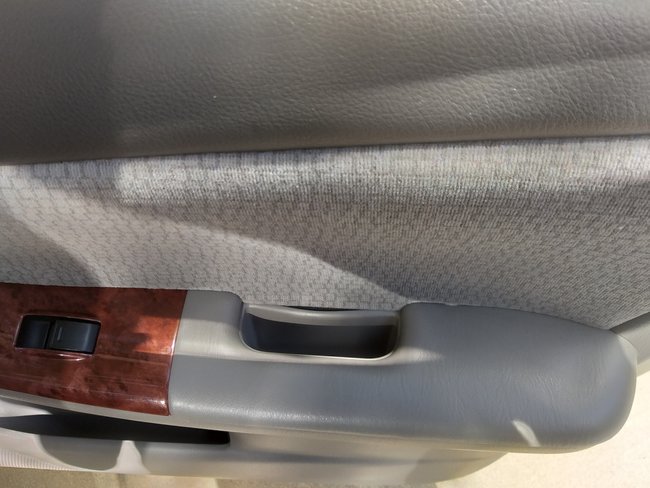

I would wedge something in the door handle to force this part of it down.
Take a look at the picture.

I would just use a piece of wood so that you can cut it to the length you need to get the panel flush. Just test it before you put the adhesive in there. If you need to make it wider to just to make sure the hole thing is flat against the door panel.

I tried fixing the issue, but it just made it a little worse. I ultimately decided that I am fine with how it looks and that it is not worth my time and money to try to "fix" it.
Friday, November 20th, 2020 AT 4:23 PM
Haha, I understand. Unfortunately that is probably the best option with this type of issue. These types of things were not made to be "repaired" so replacing them is really the best and only option. Sorry it didn't work out. Thanks for using 2CarPros and please come back in the future if you need more help with other things. Thanks
