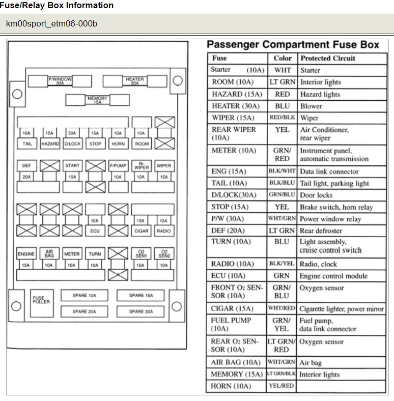

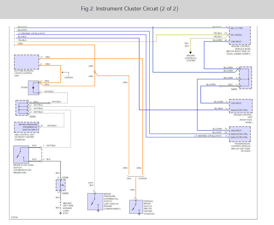

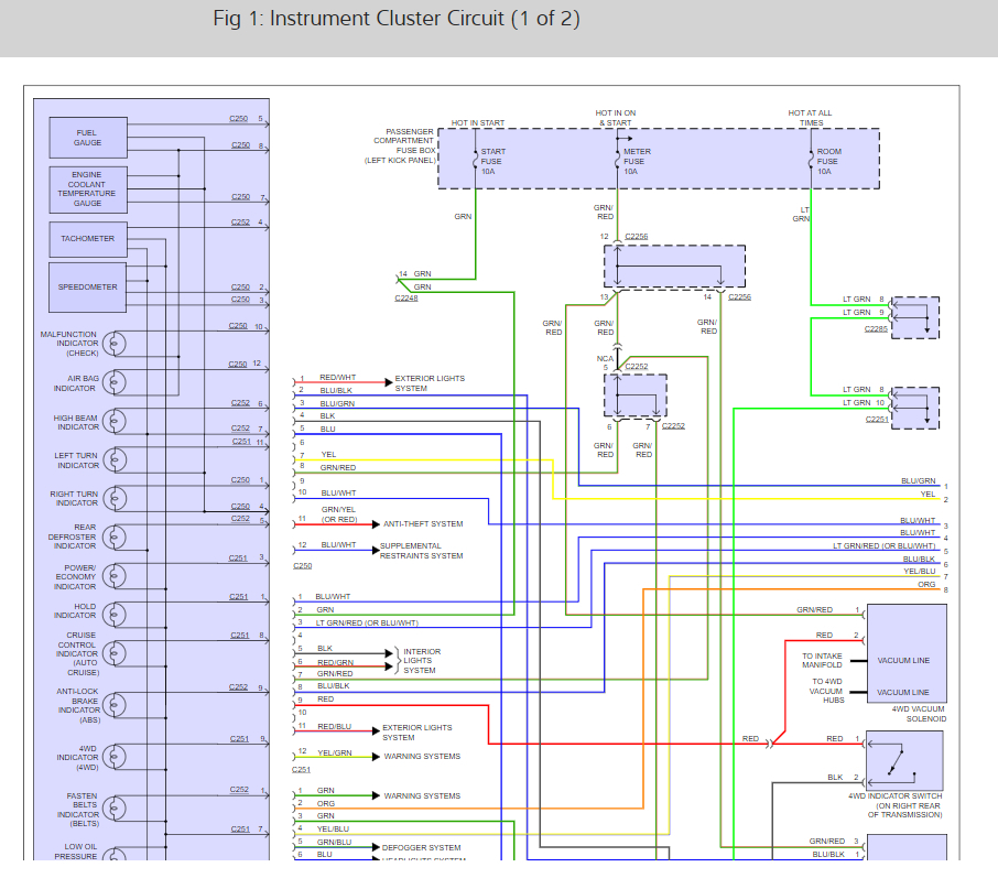

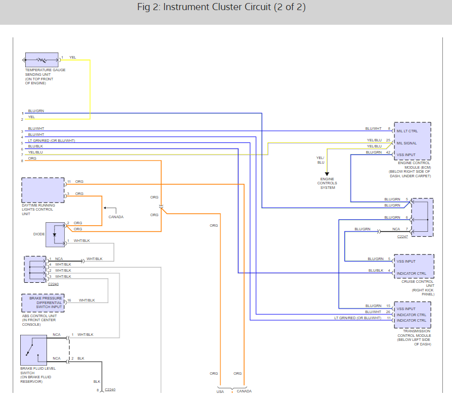

Gauges stopped working and no power in overdrive. How do I fix my gauges?
Oct 4, 2018 at 3:14 AM
  • 54,840 POSTS

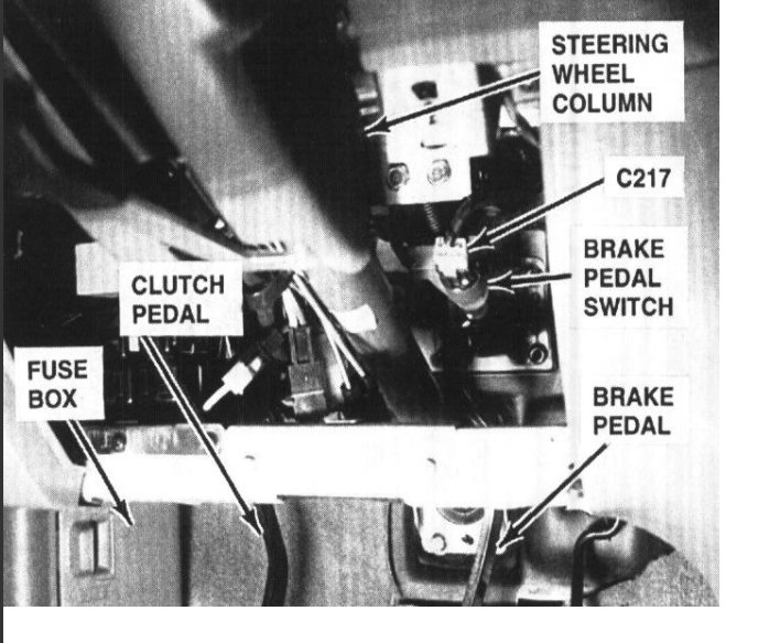

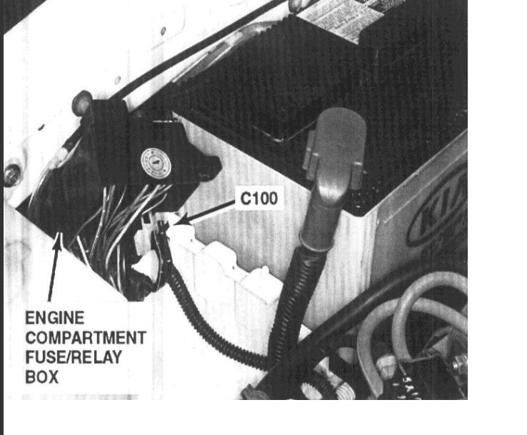

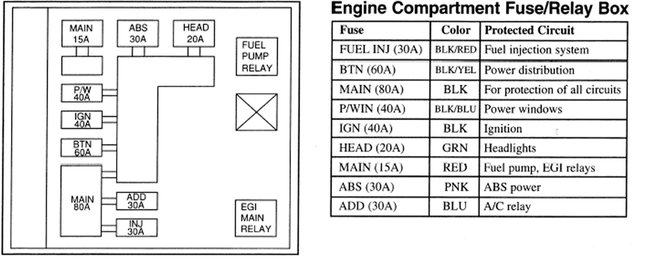

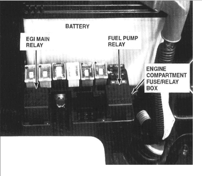

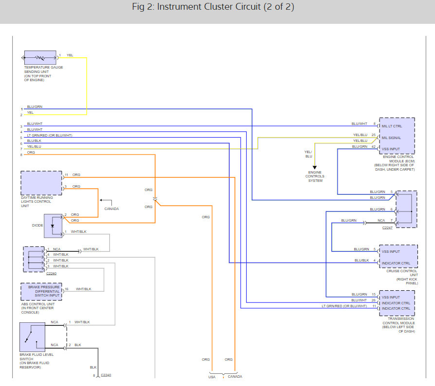

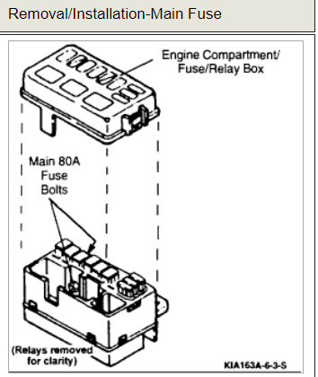

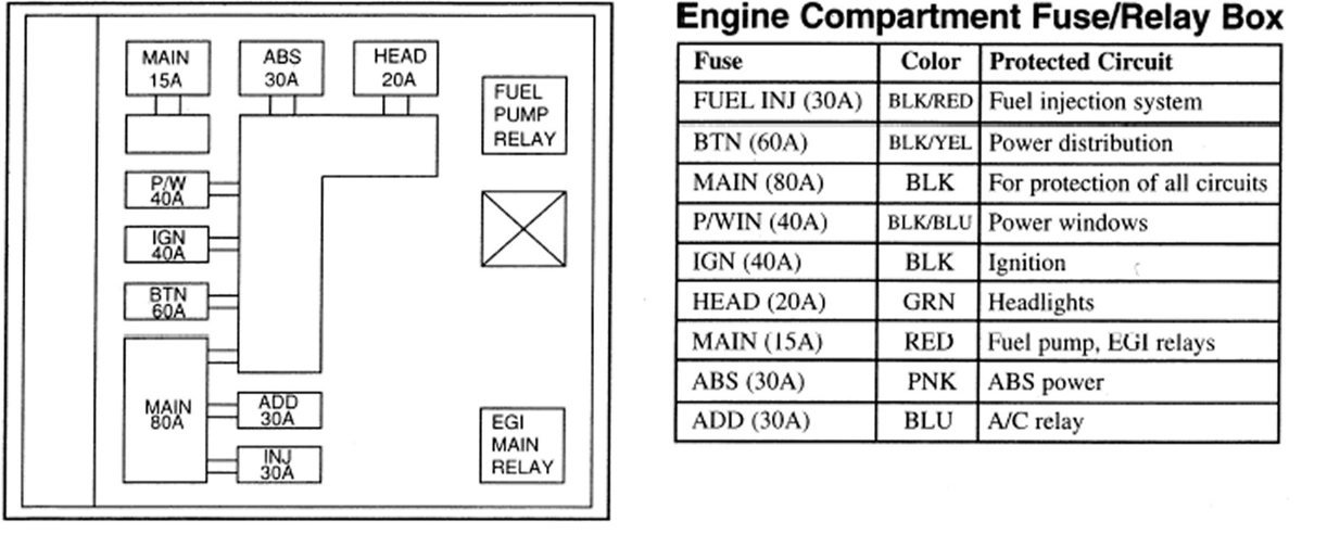

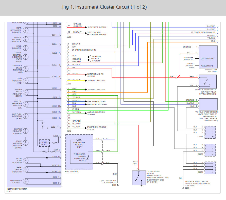

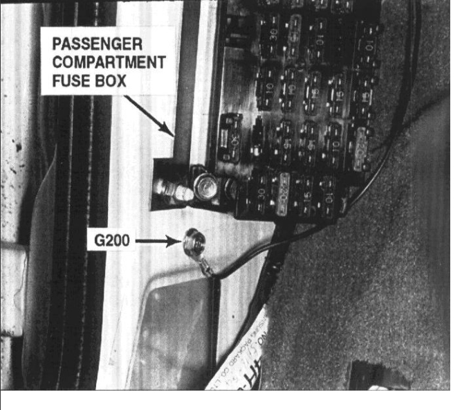

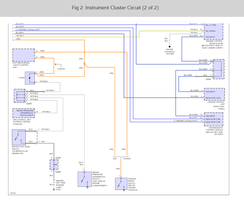

There are three fuses (start, meter, room) that run the cluster. Here is a guide to help you test them and the wiring diagrams so you can see how the cluster works and the fuse location as well:
