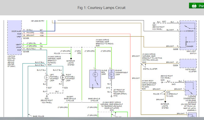

how do i find the connection to the map/ticket light
2003 FORD CROWN VICTORIA
150 MILES • 0.5L • V8 • 2WD • AUTOMATIC
JAY DESMOND
the ticket light wont come on even with a new bulb.
May 19, 2019 at 4:41 AM
SCGRANTURISMO
  • 4,897 POSTS

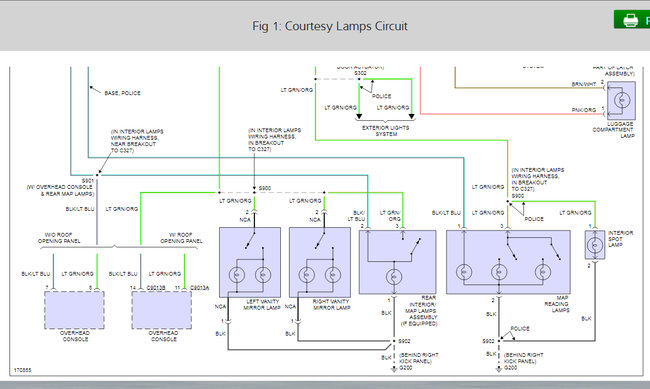

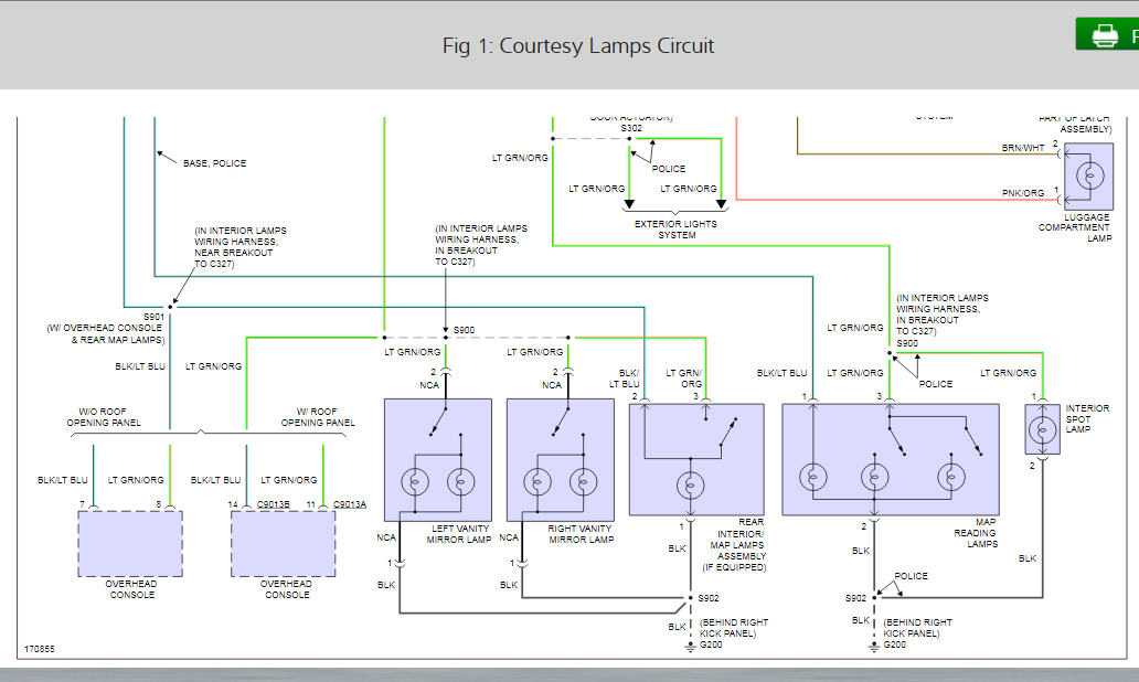

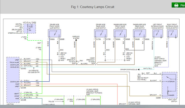

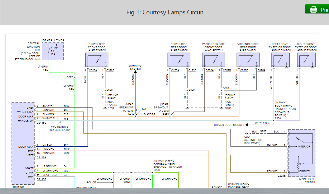

Does your vehicle's Glove Box Lamp illuminate? I have included a wiring diagram of your vehicle's interior lighting system in the diagrams down below for reference. Please get back to us with what the Glove Box Lamp is doing and we will go from there.
Thanks,
Alex
2CarPros
May 19, 2019 at 8:16 AM
JAY DESMOND
The glove box does illuminate.
May 20, 2019 at 4:31 AM
JAY DESMOND
Is it a bad wire?
May 20, 2019 at 4:56 AM
  • 55,433 POSTS
Lets use a test light to see if power is making it to the socket.
Let us know
