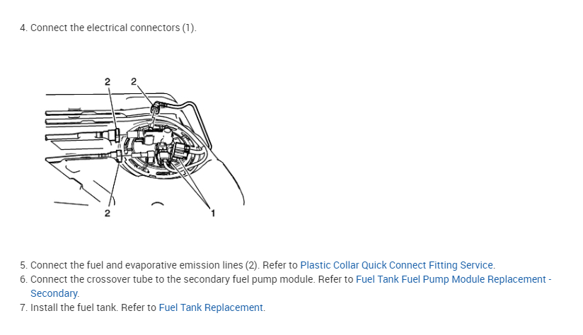

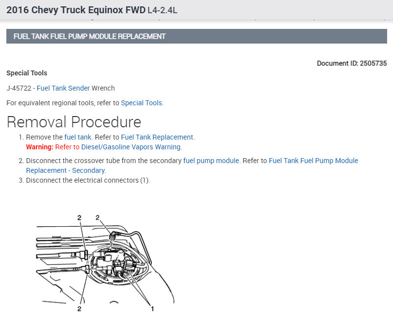

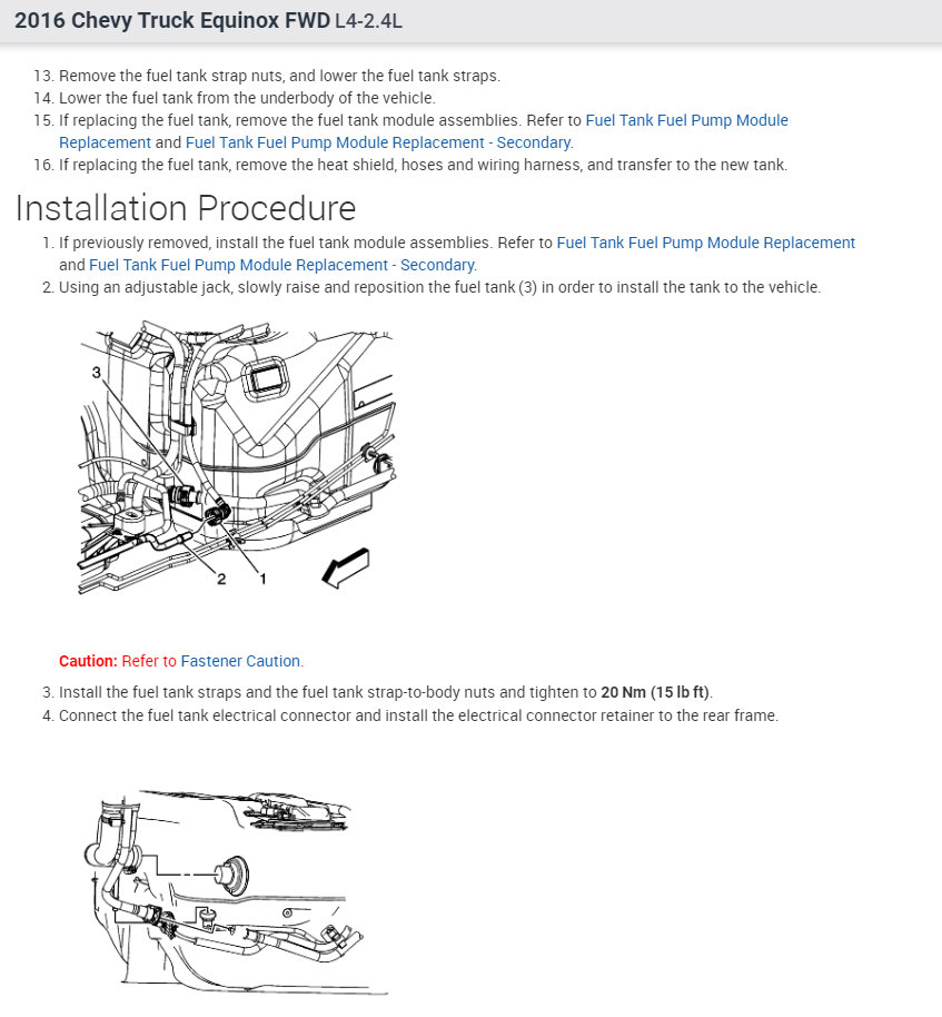

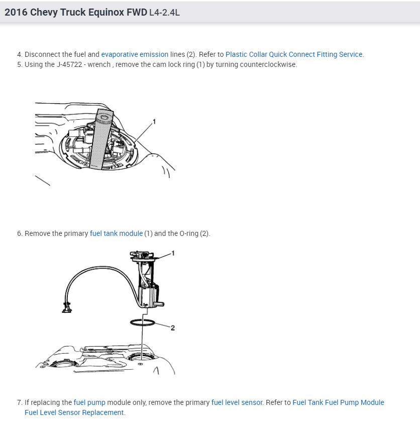

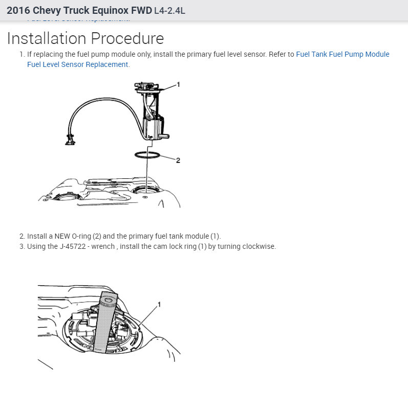

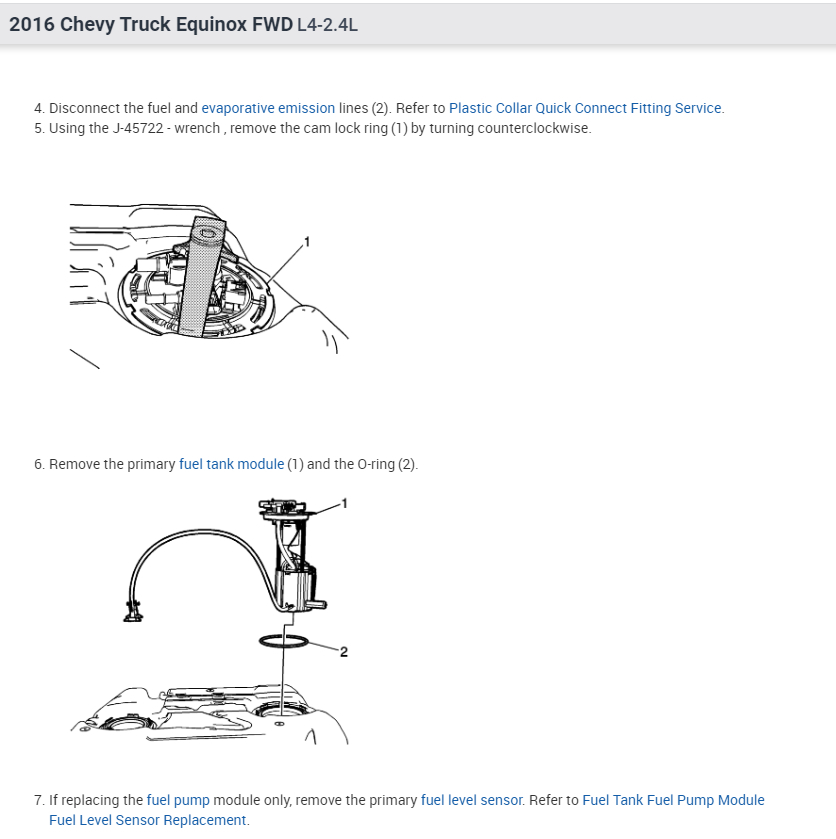

How to change fuel pump kit?
Jul 3, 2022 at 5:16 PM
SQM
  • 6,383 POSTS
On this vehicle you will have to remove the exhaust to drop the fuel tank.
I have attached the fuel pump, fuel tank and exhaust removal and installation procedure below for your reference.
Let me know of any questions.
https://www.2carpros.com/articles/how-to-replace-an-electric-fuel-pump
