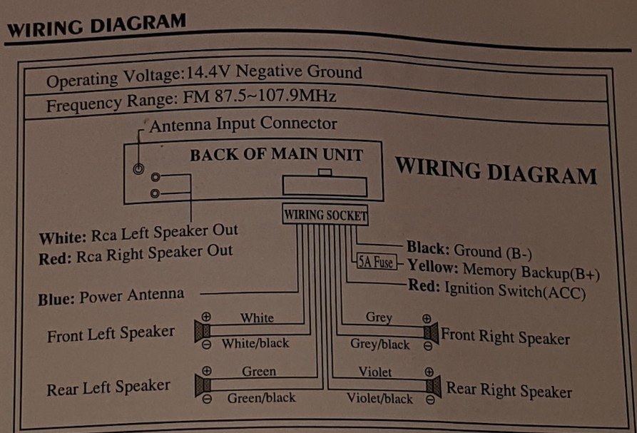

Do you have the circuit diagram of the new radio? We need to understand what each wire is for and colors alone do not tell us what they are for.
Nov 17, 2017 at 10:20 AM
ROYCAR71
  • 359 POSTS
Nov 17, 2017 at 7:19 PM
KHLOW2008
  • 41,814 POSTS
The circuit diagram do not show any blue white wire. The blue wire for antenna should be left alone unless you have power antenna and is for it to automatically extend and retract when turning on/off radio.
For the speaker wires, ensure the polarity is correct for each and every speaker.

Actually it is standalone on ford expy connector. I connected to red wires and there is sound now.
