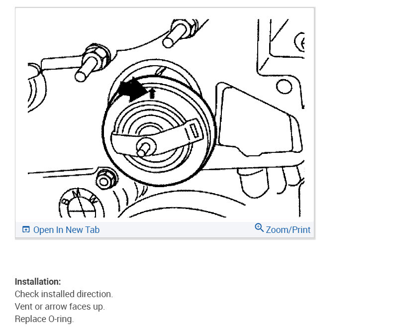

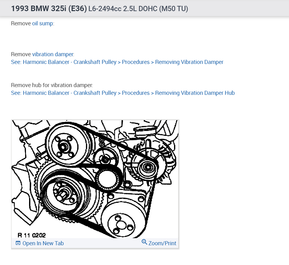

How do I change the VANOS chain tensioner?
1993 BMW 320I
116,000 MILES • 2.0L • 6 CYL • 2WD • MANUAL
CHRISTOPHER SA
  • 255 POSTS

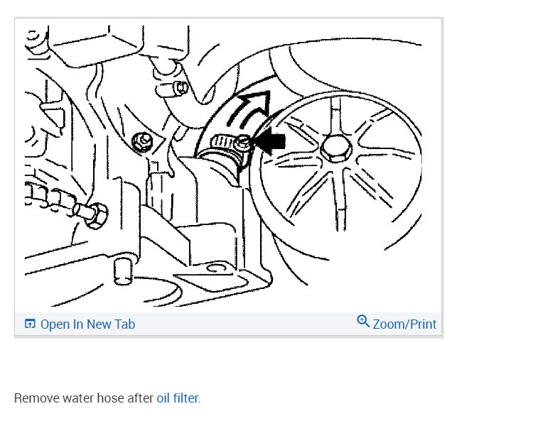

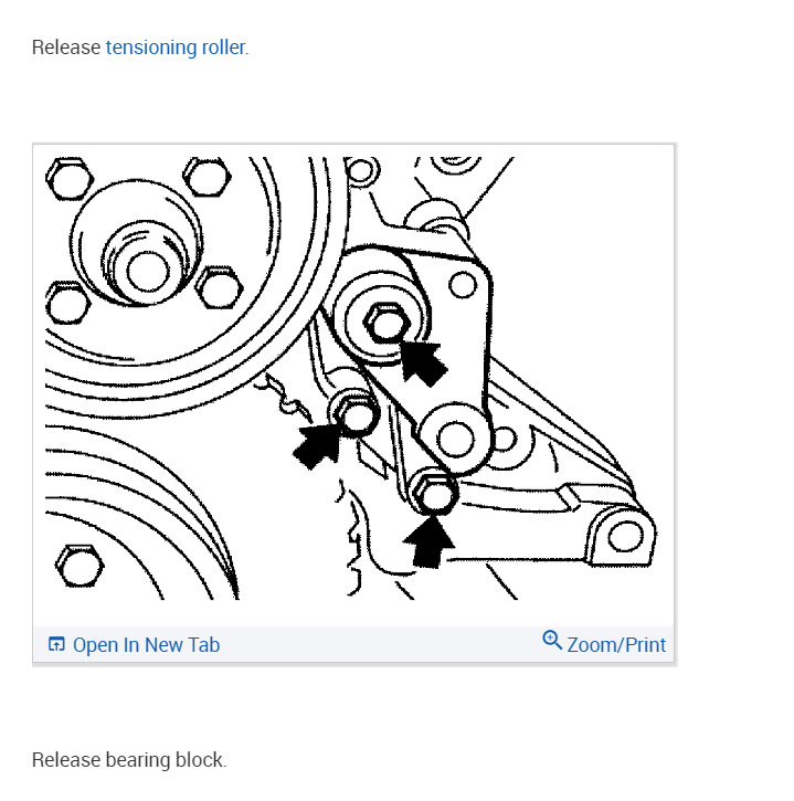

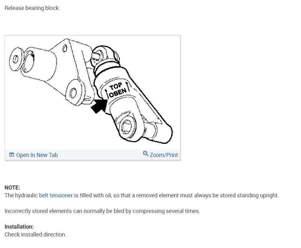

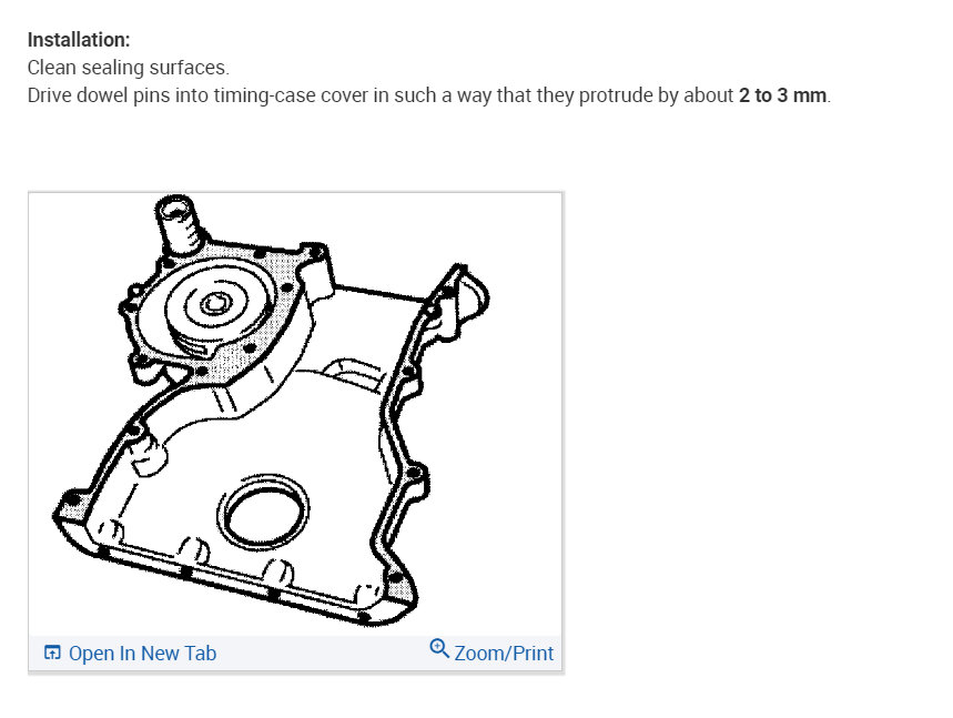

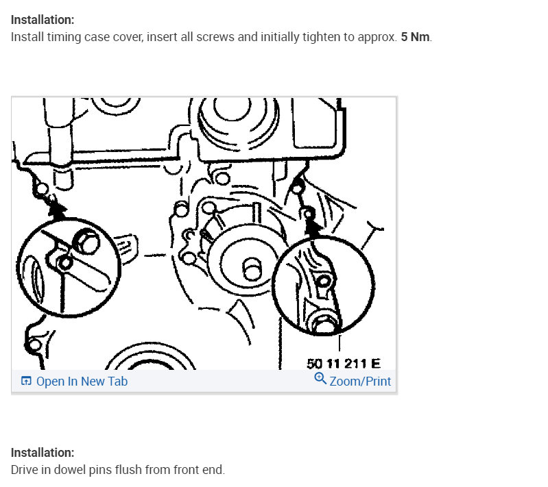

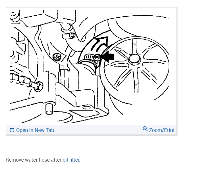

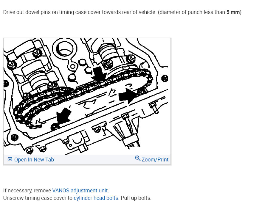

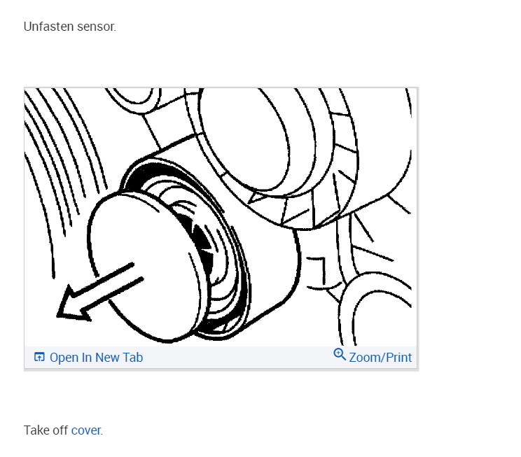

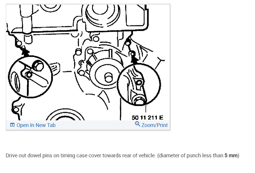

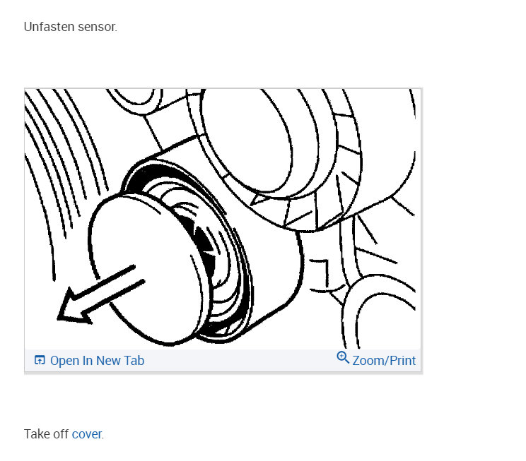

This engine is the same as the 325. Since I will be taking the head off soon I thought it would be a good idea to change the tensioner as I have seen many videos that state that it will fail at some point.
Sep 28, 2022 at 3:51 PM
  • 55,433 POSTS

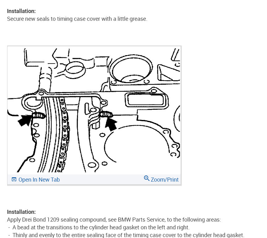

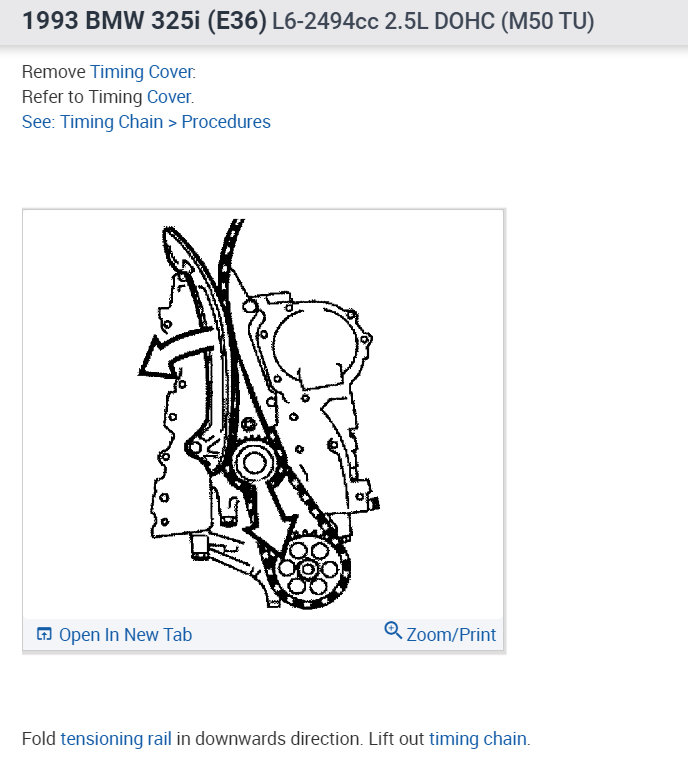

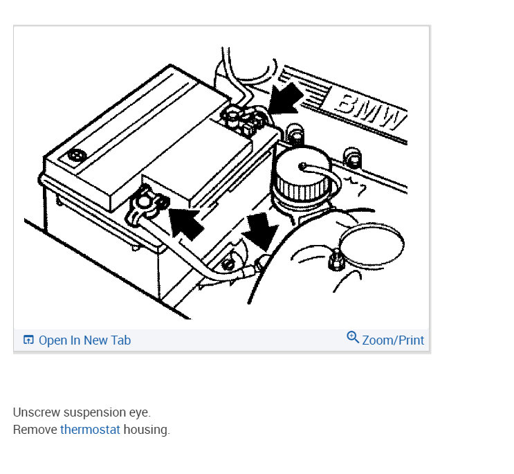

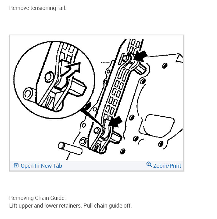

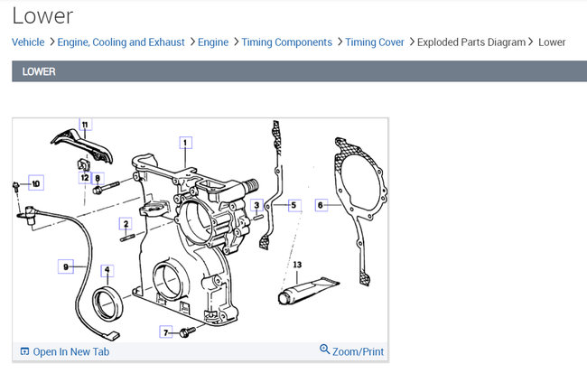

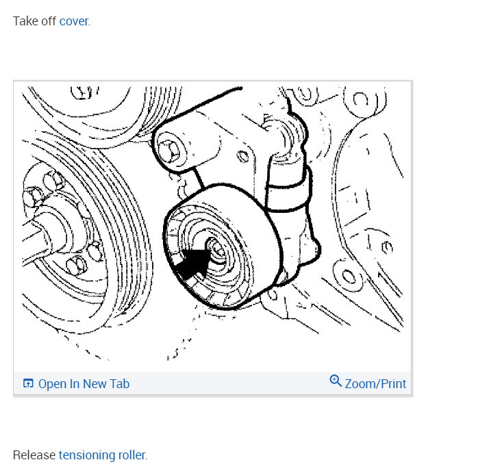

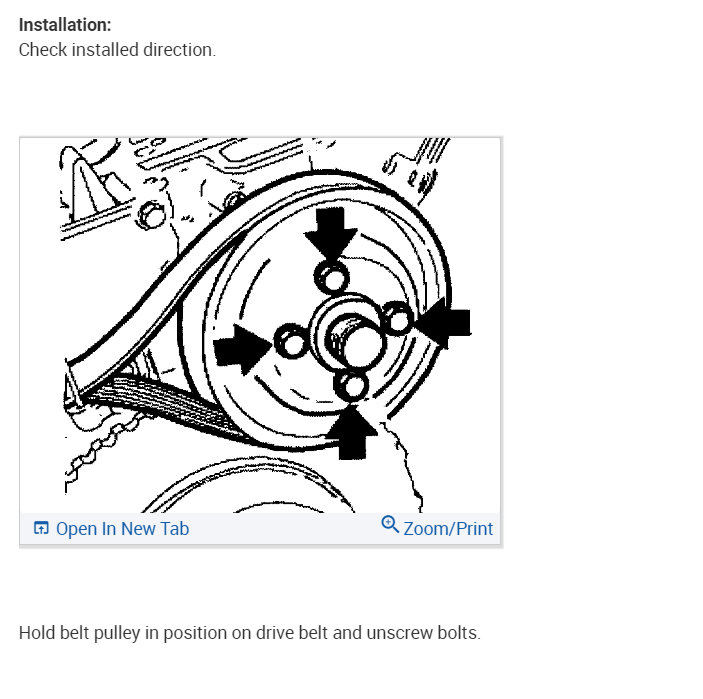

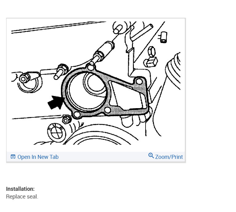

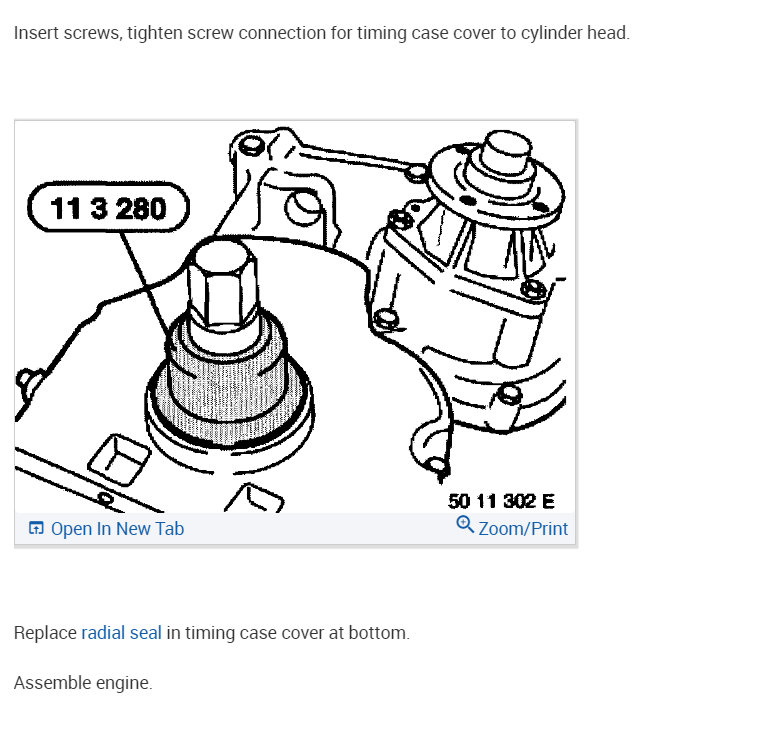

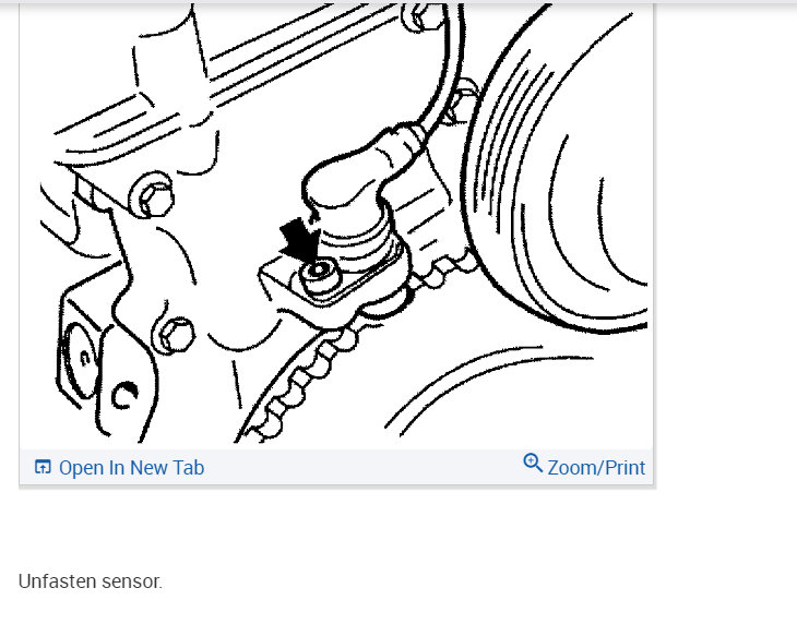

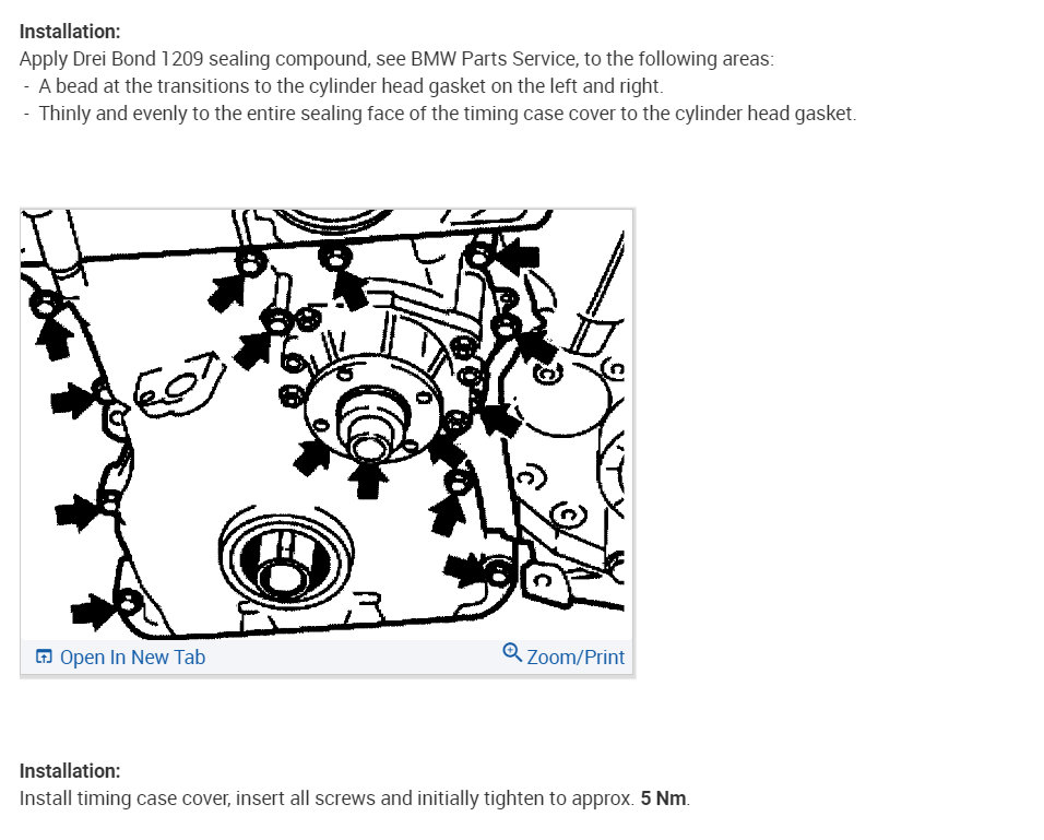

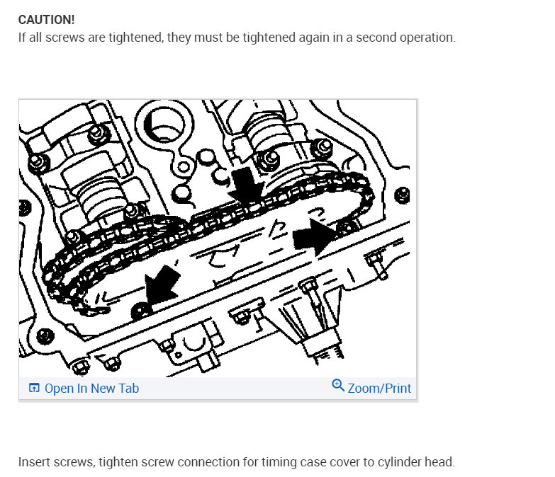

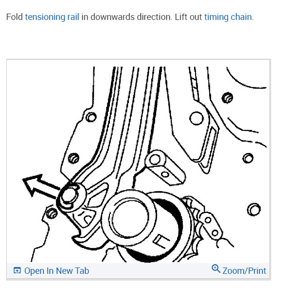

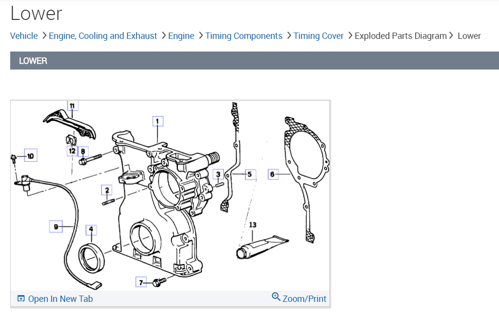

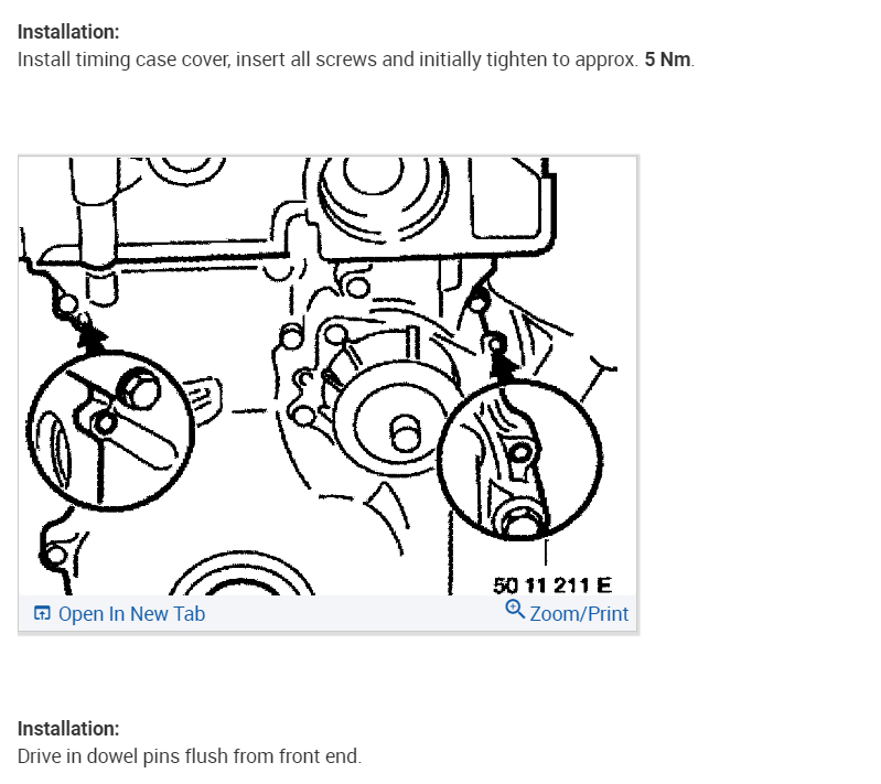

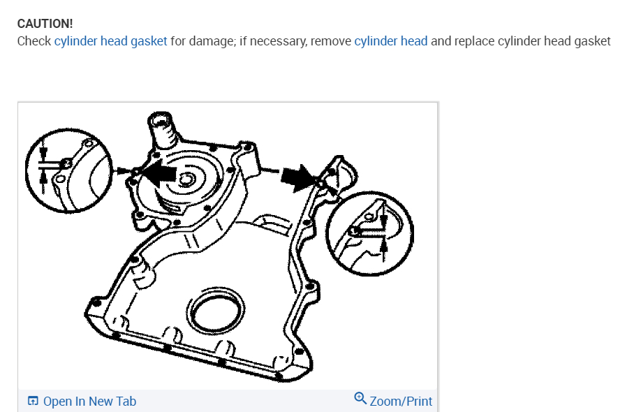

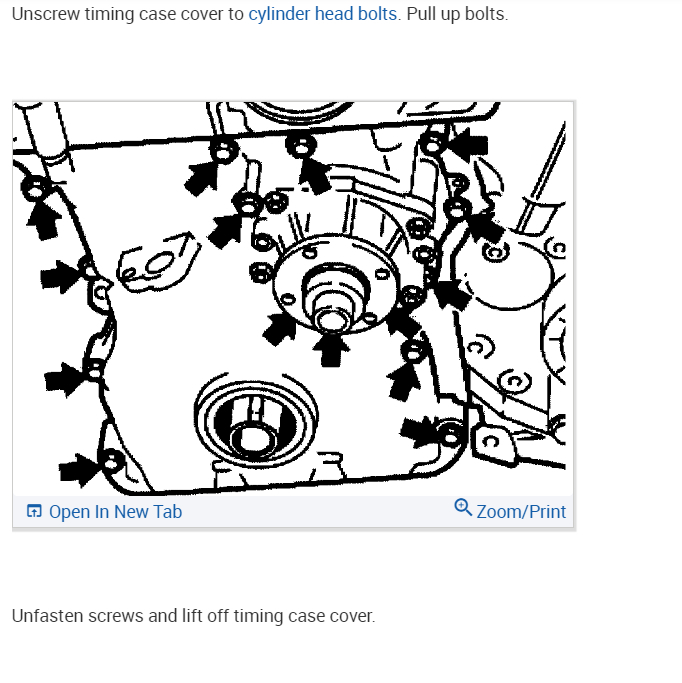

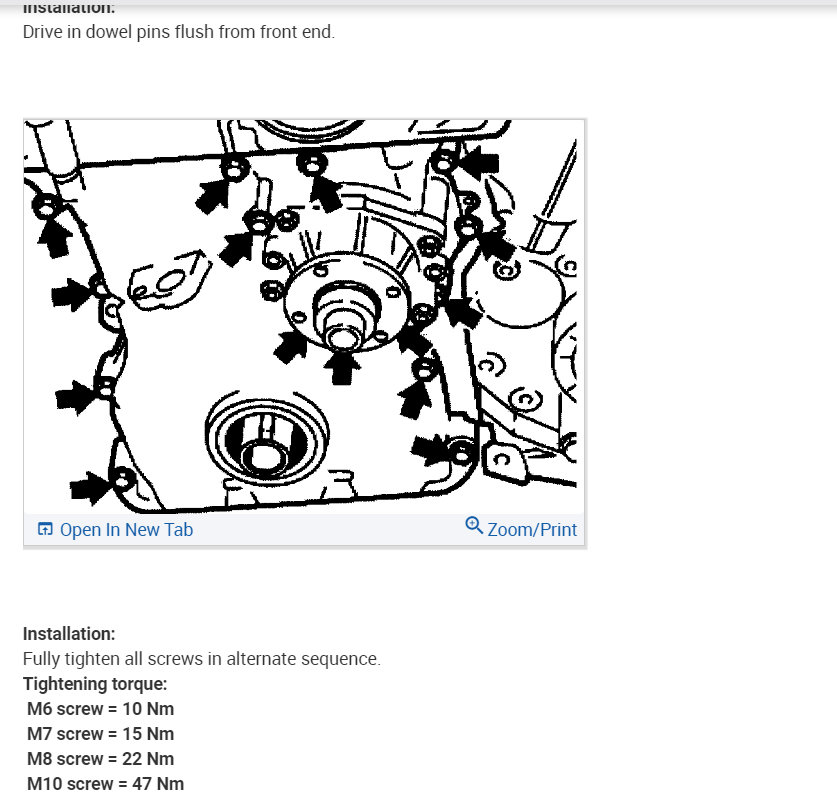

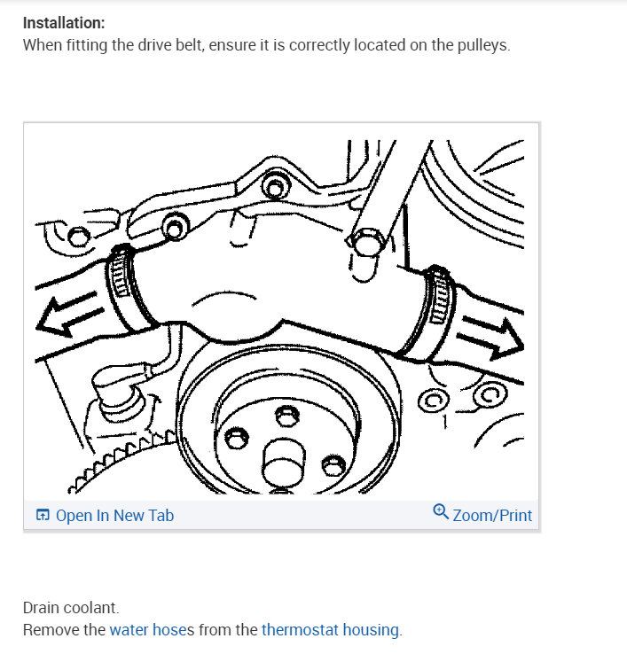

Yep, that is a good idea. here is how to change out the timing chain lower guide which means you will need to remove the front cover as well. Here is how to do the job in the images below. Check out the images (below). Let us know what happens and please upload pictures or videos of the problem.
Sep 29, 2022 at 4:27 AM
CHRISTOPHER SA
  • 255 POSTS
Thanks for this Ken. This may have to wait a while as I need to budget the cost in. I also need to sort out the drawings as they seem to be in no particular order.
Sep 29, 2022 at 5:12 AM
  • 55,433 POSTS
Sounds good, the images are in the order the manual gave them to me FYI. let me know if you need anything else to get the problem fixed.
