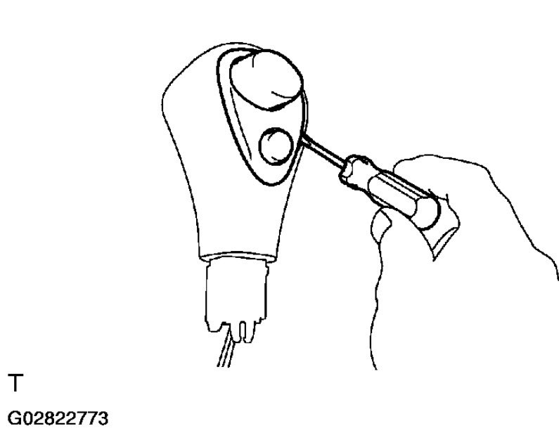

How do I change light bulb on gear shift
2003 TOYOTA CAMRY
190,000 MILES • 4 CYL • FWD • AUTOMATIC
RUTH POYNER

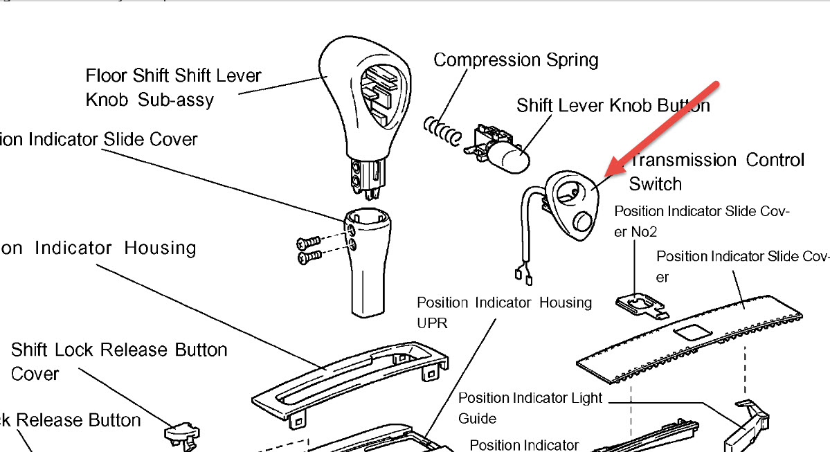

Light is burnt out on gear shift.
Apr 1, 2017 at 6:38 AM
HMAC300
  • 48,601 POSTS
see pictures. you will need a small screwdriver to pry the piece out to get to bulb. do not let spring and button go flying.
