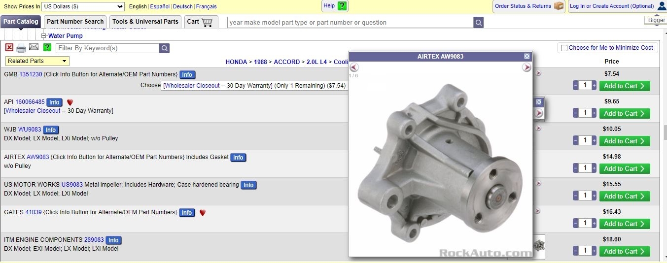

How do I find out what water pump to get for the car listed above? I do believe AutoZone has already sold me the wrong water pump. just wandering.
Jan 9, 2021 at 2:32 AM
Good afternoon,
I attached the pump for you from rock auto. Airtex is a common brand that most stores carry.

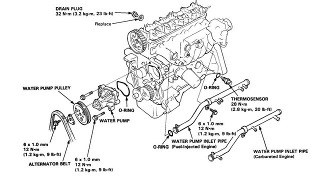

I attached the procedure for you as well below.
1. Remove Timing Belt, refer to Engine/Timing Components/Timing Belt.
2. Remove thermostat housing and water pump inlet pipe.
3. Remove the alternator bracket.
4. Remove the water pump and O-ring.
5. Replace all gaskets and O-rings when installing water pump.
6. Reverse procedure to install.
Note: When refilling cooling system, loosen bleed bolt on heater valve or water outlet, as equipped, and allow coolant to flow out until stream is free from bubbles.
