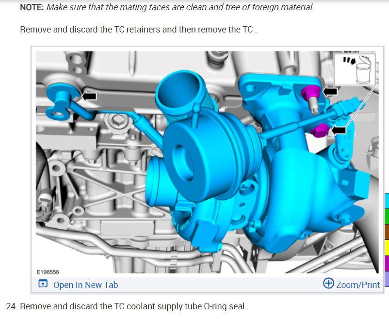

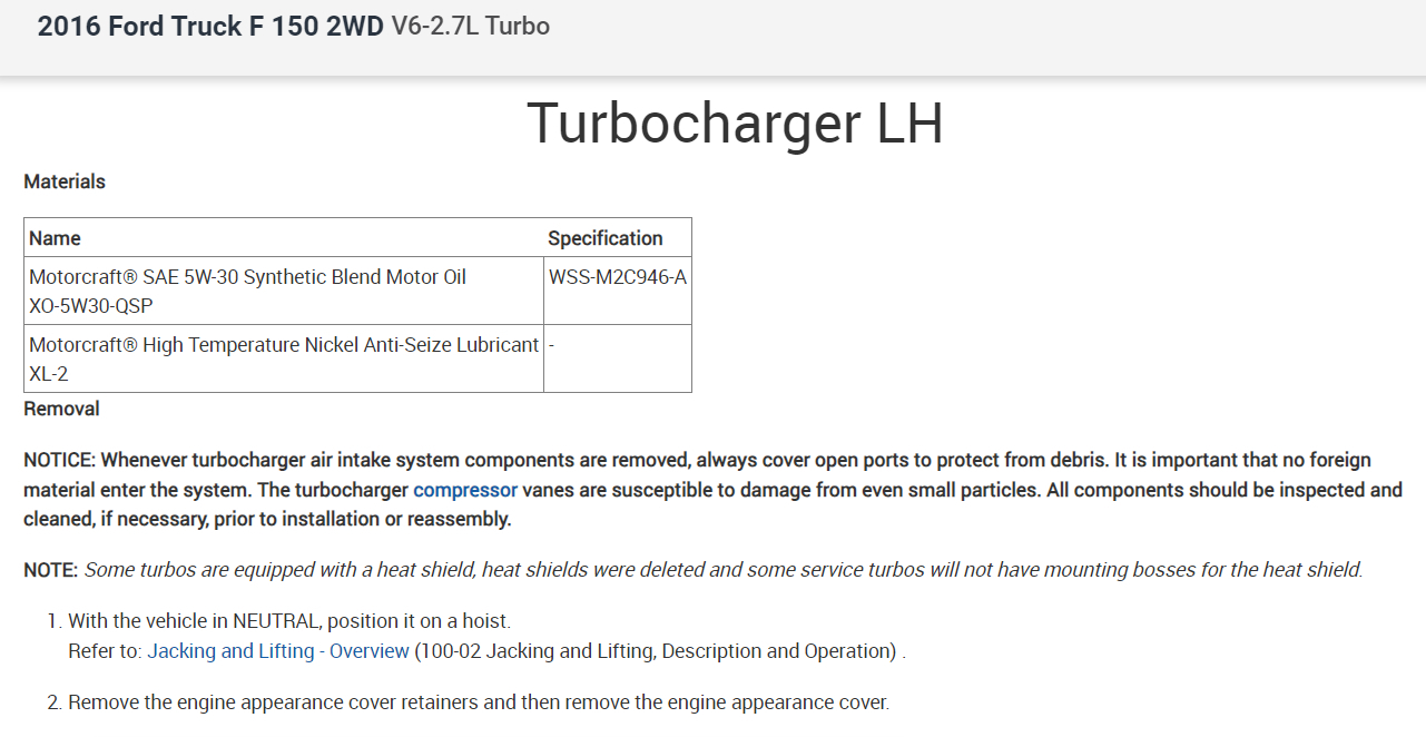

Recently did an oil change and I noticed some extra smoke recently. I added some Lucas stabilizer and now it smokes like crazy. The impeller has movement but what made it fail so quickly?
Sep 25, 2024 at 6:42 AM
  • 110,248 POSTS
Was the smoke from the exhaust and does the vehicle have any history of oil consumption? I know there were engines being replaced on the 2.7L turbo vehicles.
I need to know what size engine this has and if any diagnostic trouble codes were stored. Here is a link that shows how to check for codes:
Sep 26, 2024 at 6:03 AM
  • 55,682 POSTS

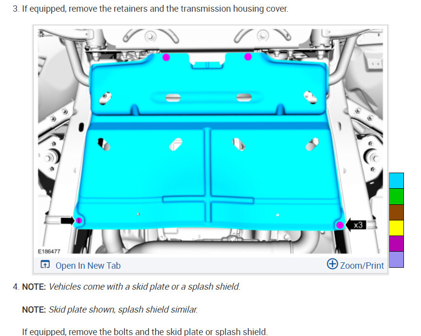

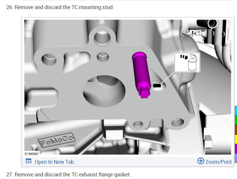

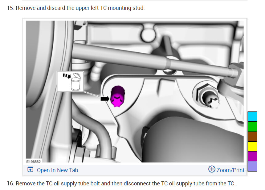

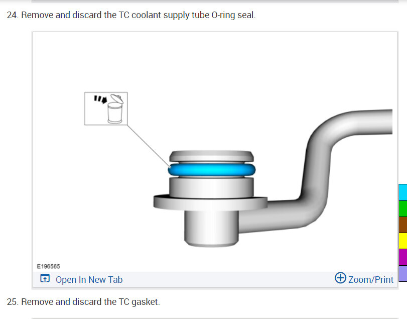

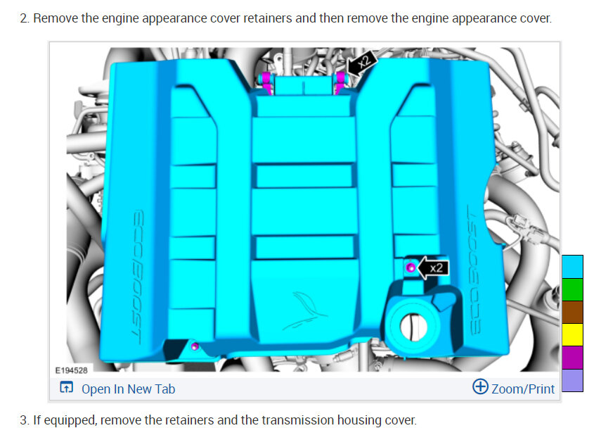

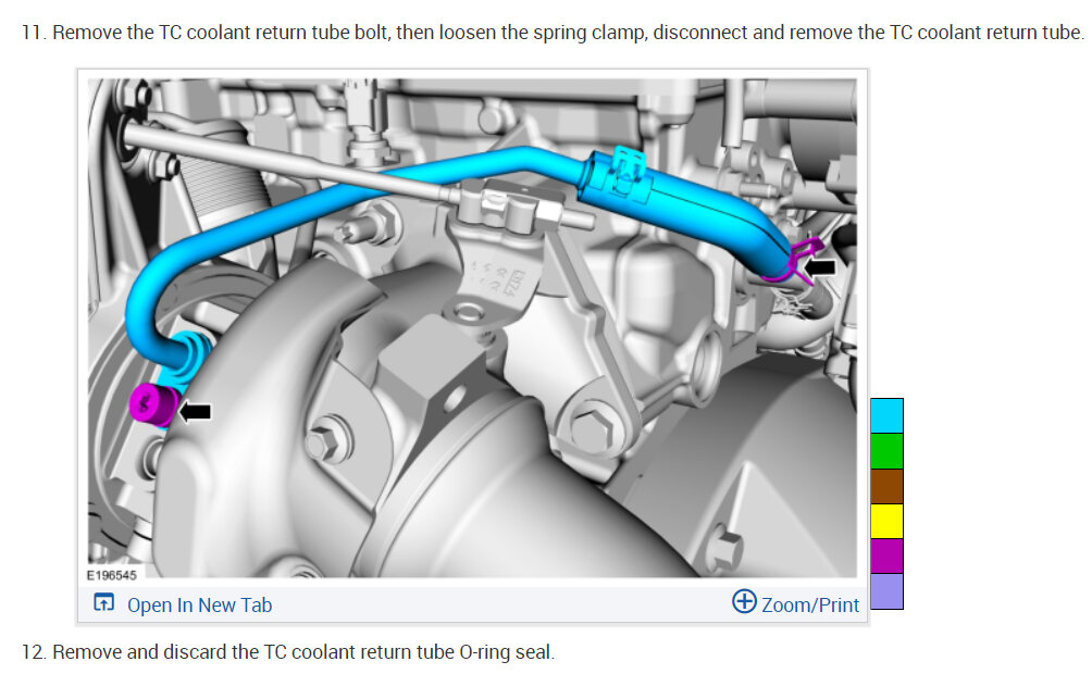

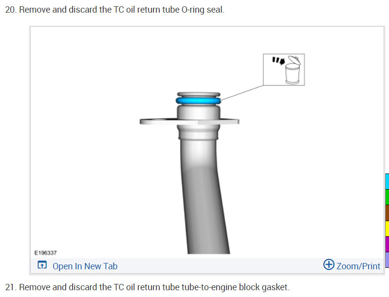

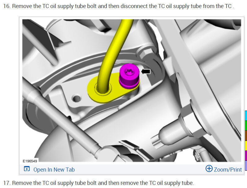

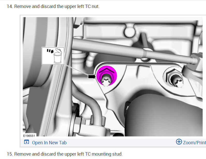

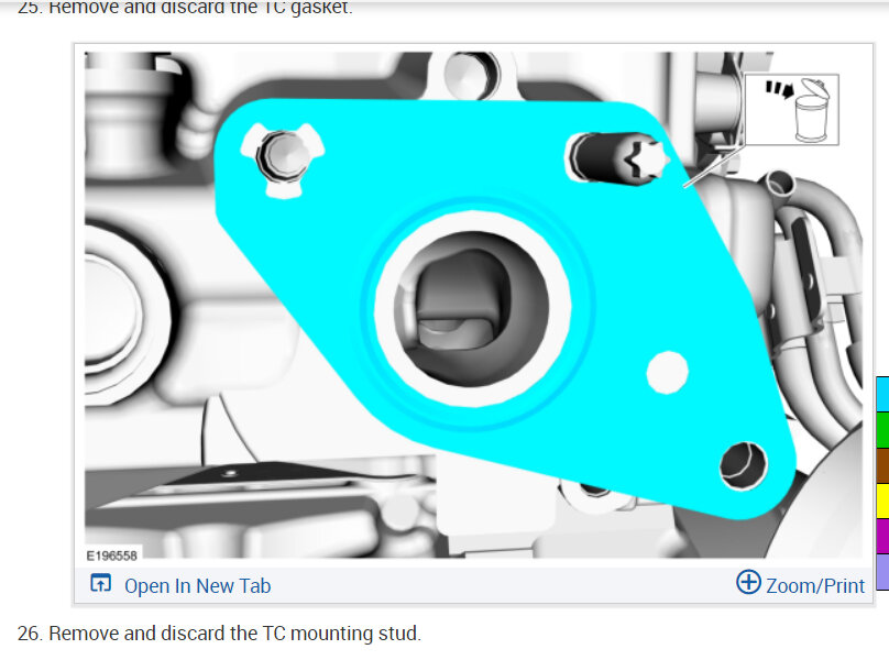

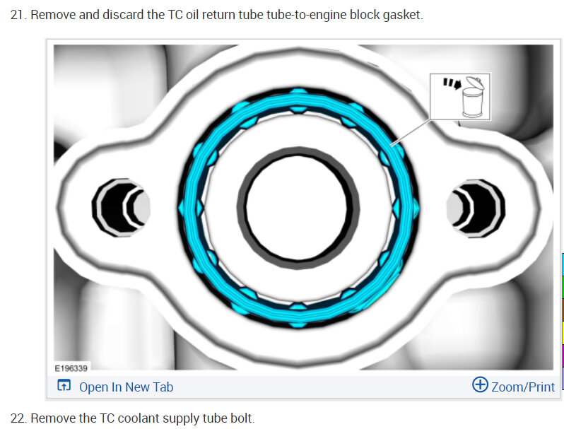

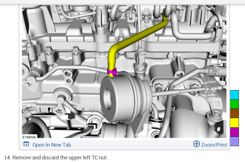

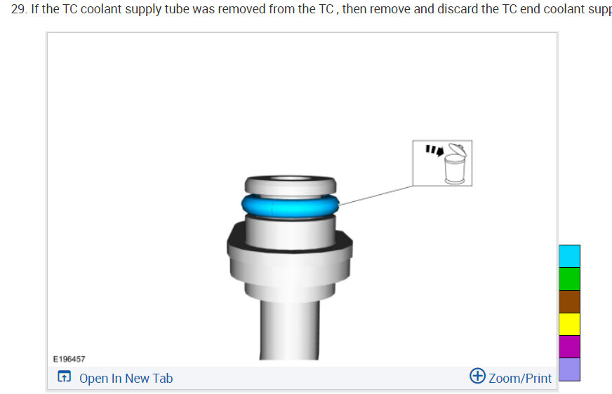

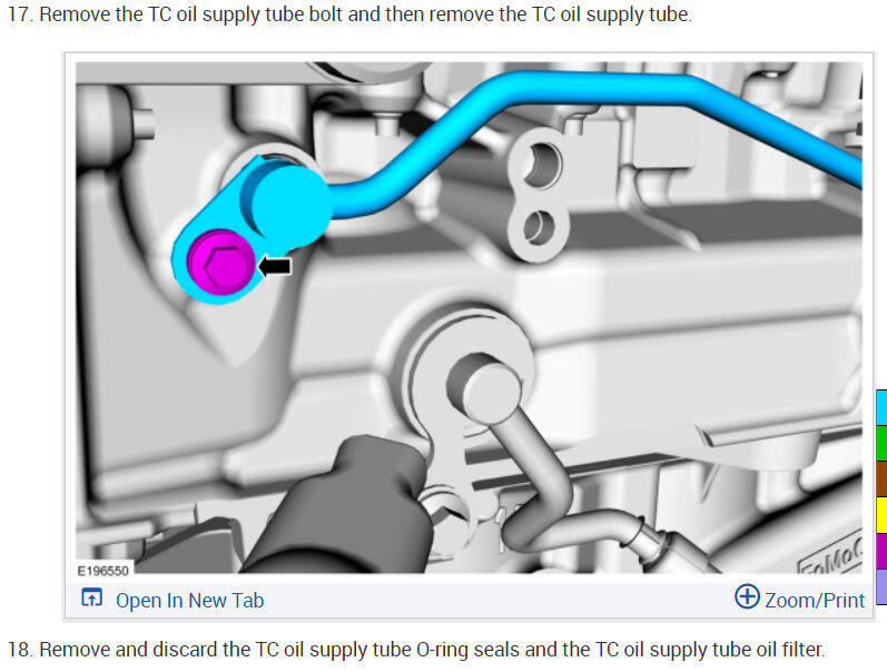

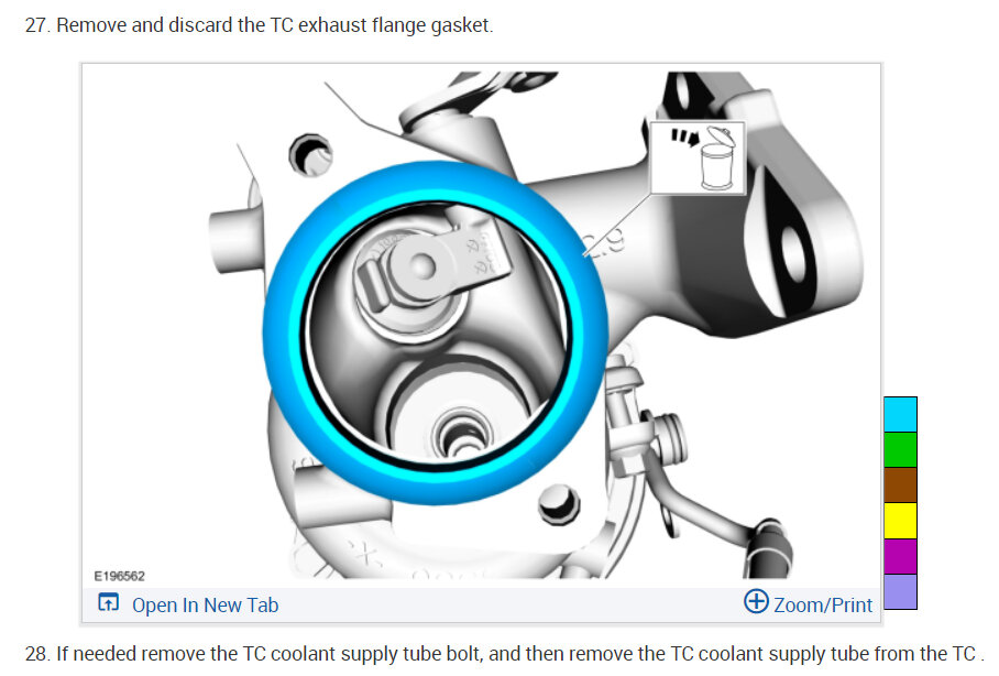

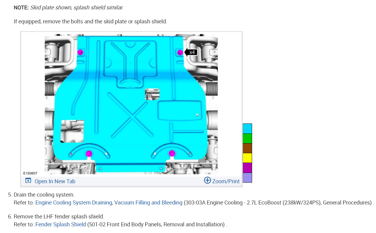

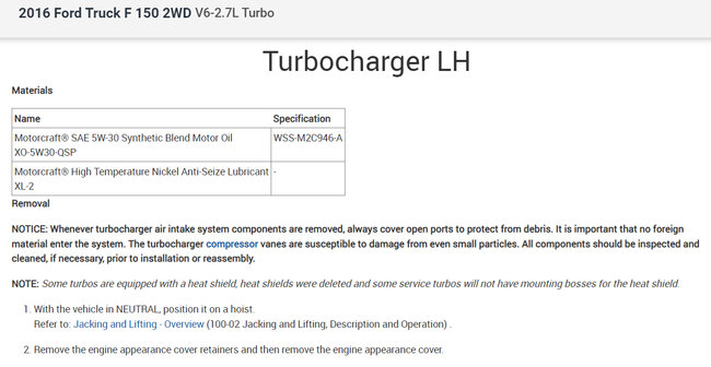

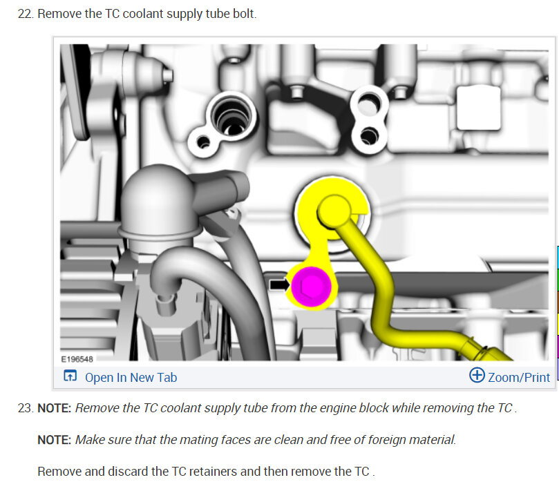

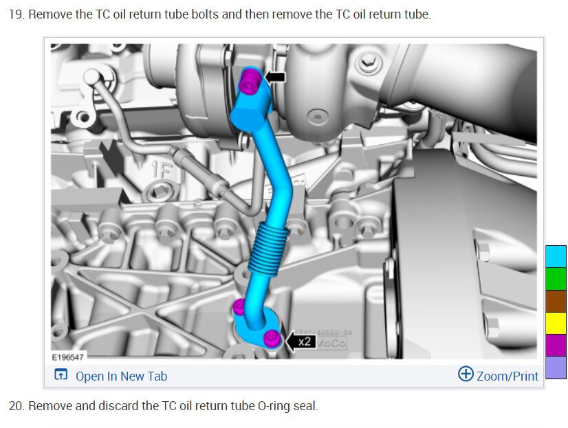

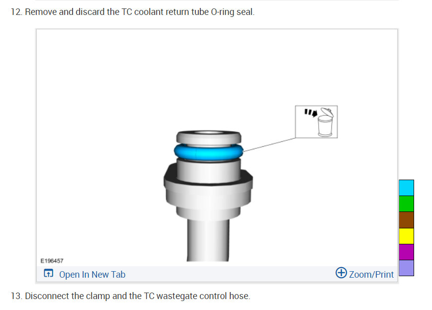

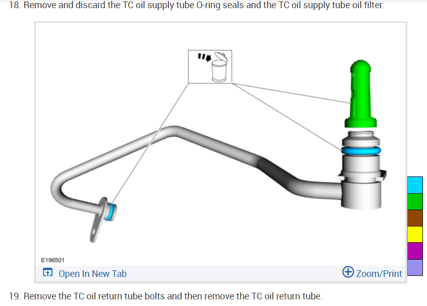

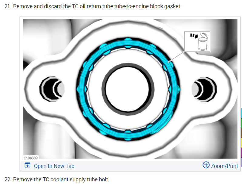

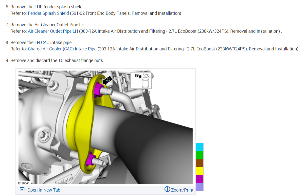

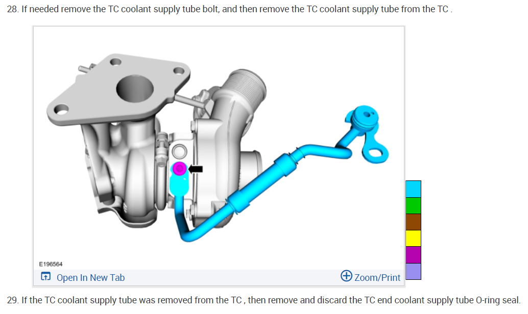

Yep, they just do, because the turbo spins so fast when it goes bad it does so very quickly which will cause the aforementioned smoke. This is a common problem with these trucks, I would replace both turbos to fix the problem, here is how. I show one right the opposite side is similar. Check out the images (below). Please let us know what happens.
