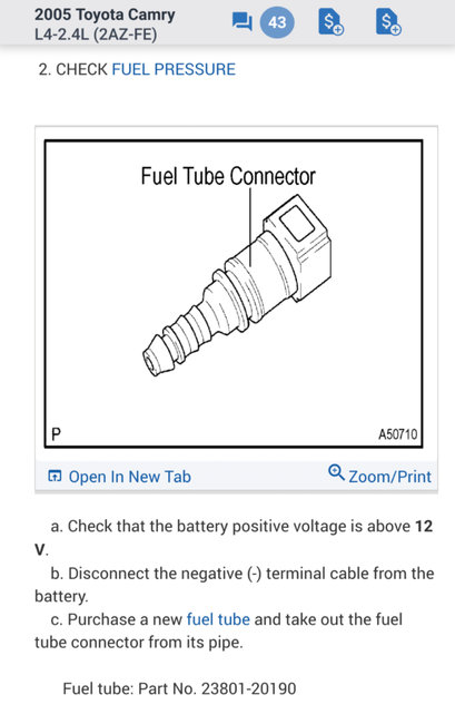

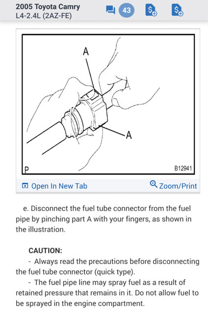

How can I splice into the fuel line near the connection the the fuel rail to put a T connection so I can check my pressures?
2005 TOYOTA CAMRY
333,000 MILES • 2.4L • 4 CYL • 2WD • AUTOMATIC
UHSNOEBIRD
  • 342 POSTS
I am wanting to put a T connector so I'll be able to check my fuel pump pressures with my fuel pump gauge . What is the size of the inside diameter of the fuel line to the fuel rail?
Apr 25, 2021 at 12:08 PM
HARRY P
  • 2,292 POSTS

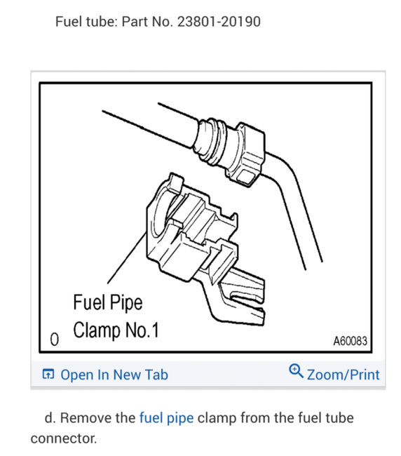

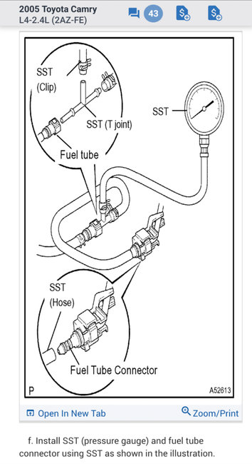

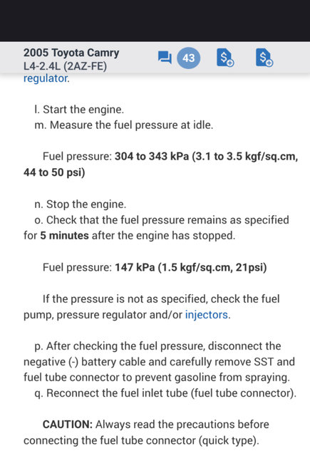

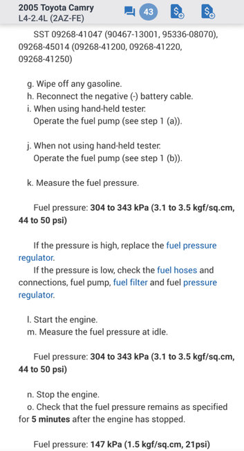

Hello. AllData actually has instructions on doing this included in their fuel pressure test instructions. I'm attaching that in the images below. Hope it helps. Let me know if you need anything else.
Apr 25, 2021 at 5:04 PM
UHSNOEBIRD
  • 342 POSTS
If I knew the size of the T fitting that would be very helpful along with the info. you sent me.

I've dug and dug but can't find any definitive information on that T joint other than it comes in a set of special Toyota tools. You could try calling the dealership and showing to someone in service. Or my other suggestion would be to pull off the line and manually measure it. Then buy a few Ts that are closest to your measurement asking with a few clamps and do a little trial and error. I know it's not the definitive answer that you'd like, but it's the best I can do without having the car in front of me to personally measure it.

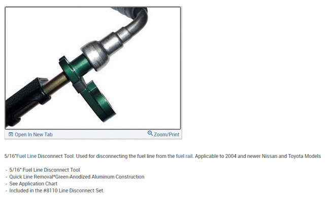

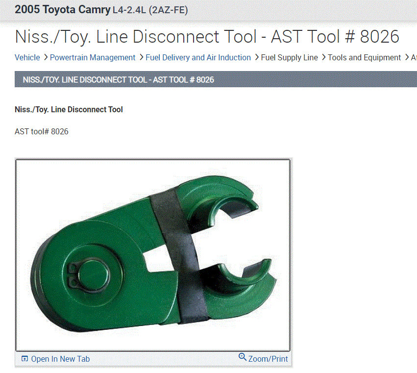

Are those gas lines hard to remove from the fuel rail on my 2005 Toyota Camry LE or do you know and I'll attempt to take it lose to measure it.
I am wanting to cut the rubber hose that goes to the fuel rail and put me a T fitting that has a Schrader valve in it. I've already done my 1997 Nissan truck that way and the T connection is there for me to check my fuel pressures anytime I need to.
I appreciate you helping me so much. Thank you
May 10, 2021 at 1:51 PM
  • 110,194 POSTS
The line isn't too hard to remove, but it does require a special tool. Actually, I have made the tool out of plastic prior to getting a set.
If you look at the directions below, they explain how to disconnect the line.
Let me know if this helps or if you have other questions. Also, there is a good chance that a parts store will lend/rent one to you.

  • 110,194 POSTS
It came with a steel fuel line under the vehicle which at both ends changes to rubber. The fuel line should be 5/16". I'm surprised the dealership didn't know that.
