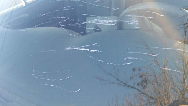

How can I get this metallic colored marks off my windshield myself
179,000 MILES
CODY SHULL
Earlier this month, I was desperate and had no ice scraper. So, I had this older flat metal pizza pan with wooden handle to use one morning. And it left behind some metallic colored marks into the glass. But, it still feels smooth. No scratch feeling to it. Just a discoloration into the glass. I have tried different methods, but to no avail. What do you suggest? Thank you.
Dec 29, 2016 at 12:05 PM
STEVE W.
  • 15,375 POSTS
That looks like aluminum. It might come off if you use a mix of one quart of bleach in a gallon of water. Soak paper towels in the mix and lay those over the marks, keep them damp. Let them set for an hour and try to wipe the mark off with a dry towel. Then wash the glass with some white vinegar mixed in water to remove the bleach residue. Be carefull with the bleach solution.
Or call a glass shop and see if they have a better option.
