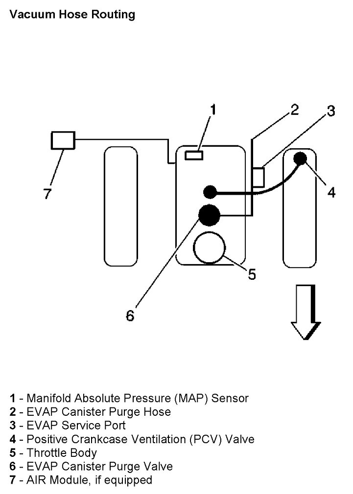

Can I get a vacuum lines diagram?
2006 GMC ENVOY
155,000 MILES • 5.3L • V8 • 4WD • AUTOMATIC
MRDEEDS321
  • 7 POSTS
Vacuum system diagram needed.
Dec 28, 2024 at 1:44 AM
CARADIODOC
  • 34,367 POSTS

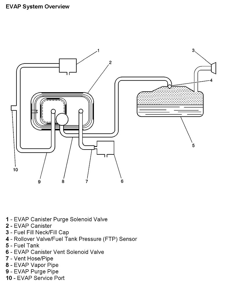

There isn't much to it. The second drawing is for the evaporative emissions system.
