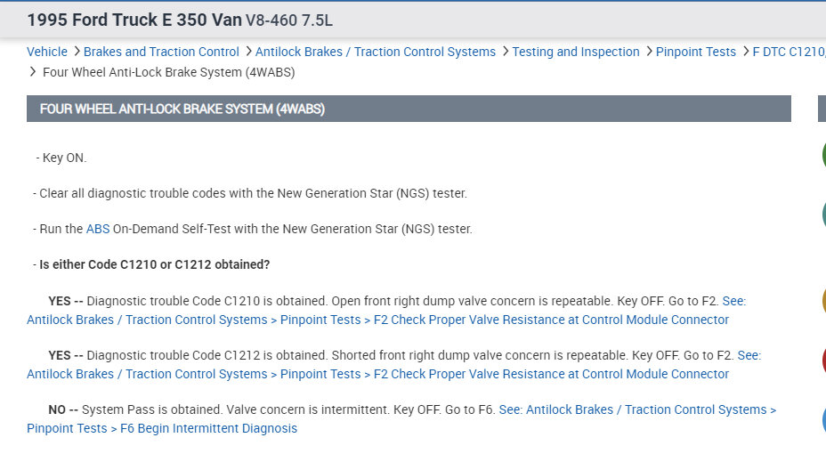

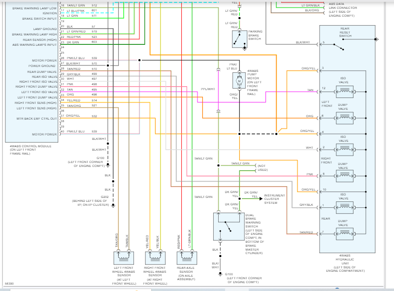

My parents have a motorhome they bought and they're trying to fix it, but they have ABS codes c1214, c1206, and c1210. I know nothing about a Ford ABS system at all, not really sure where to start or how to test.

I did all that already it's and it's still has codes the OBD1 trouble codes are for a the right check valve n a dump valve.

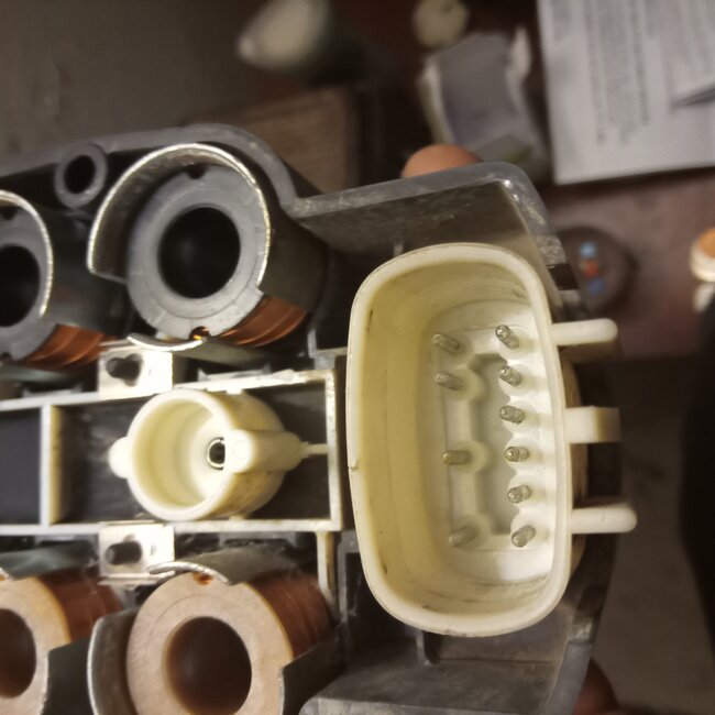

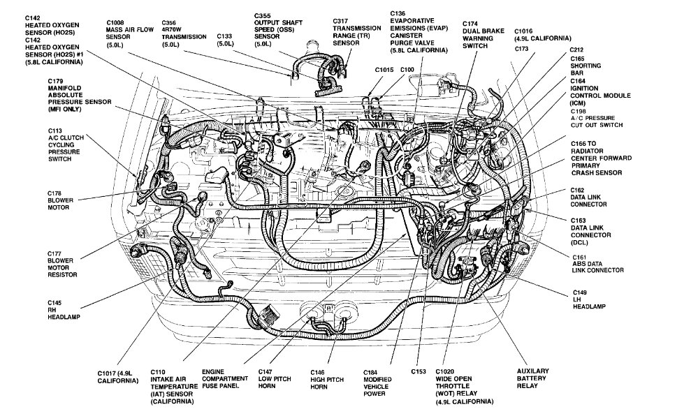

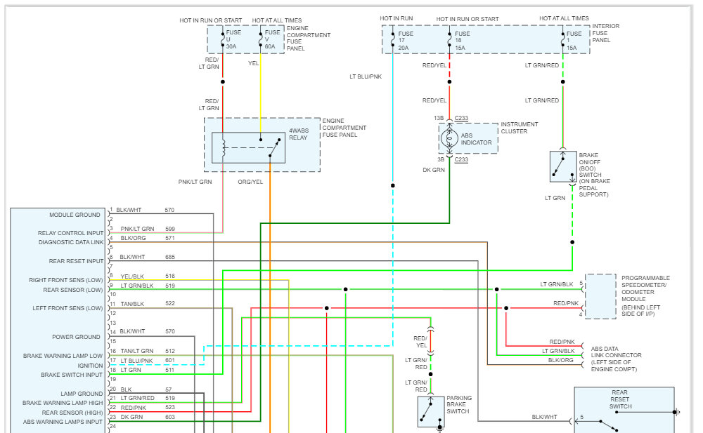

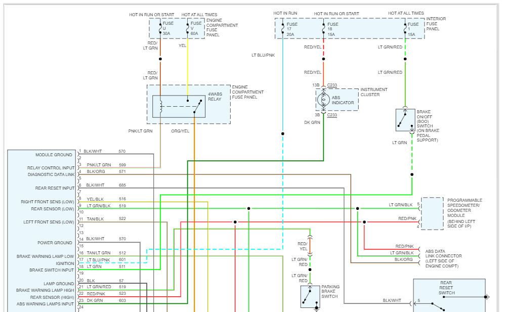

Do you know where I can find the wiring pins set so I can test the ABS module?
Oct 17, 2023 at 8:22 PM

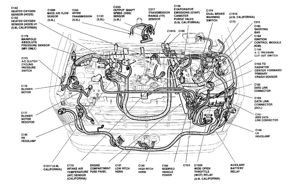

  • 110,194 POSTS

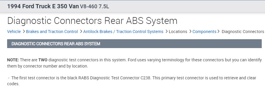

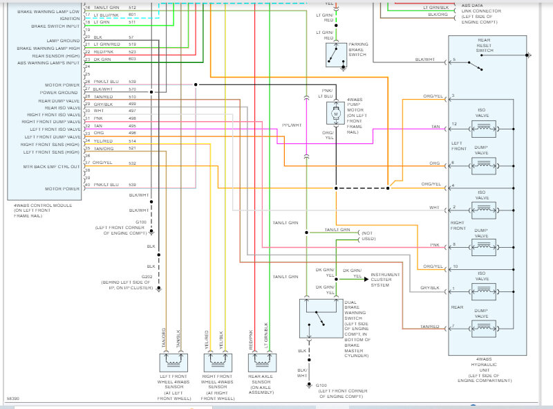

I attached what I have below. As far as a pinout, the manual doesn't provide one for the module. If you let me know the codes that are found, it may point me in the right direction.

C1214 c1210 c1206

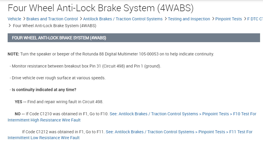

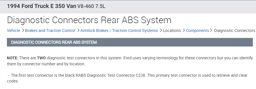

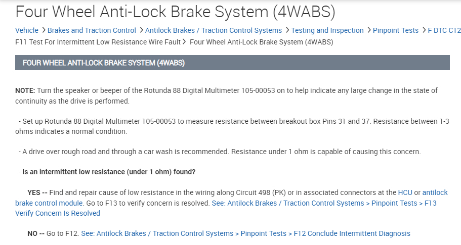

  • 110,194 POSTS

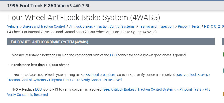

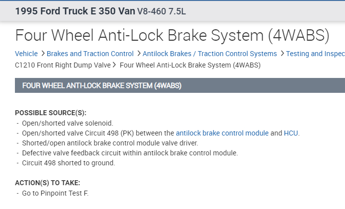

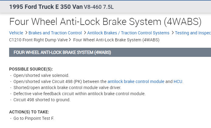

Thanks for the info. Actually, I'm a little embarrassed that I forgot they were at the top of the page. Ugh! Too many things on my mind.

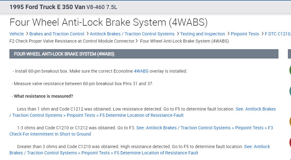

Now I have a new problem. The codes you provided are OBD2. Either this is a 1995 or it is a late production 94.

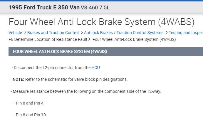

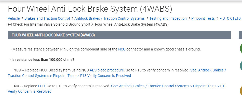

I had to go to the 1995 to access the code. C1214 isn't indicated for this year (1995). The one that has my attention is the C1210 which indicates a problem with the right front dump valve.

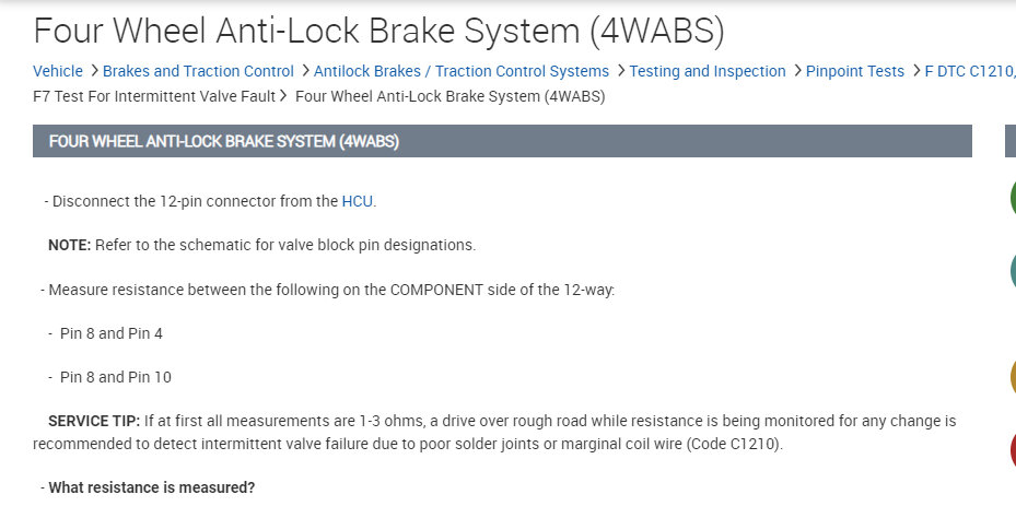

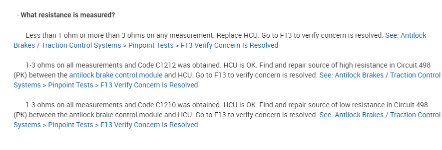

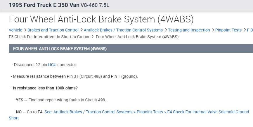

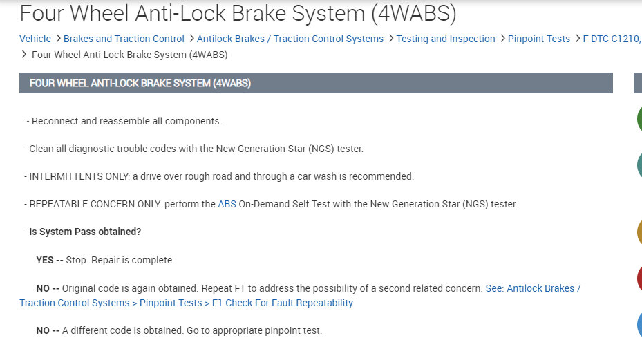

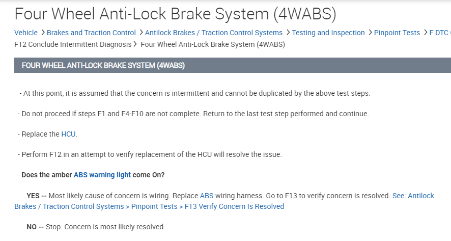

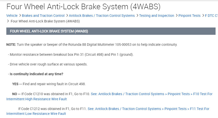

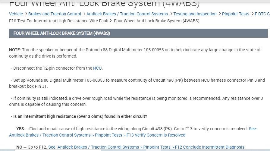

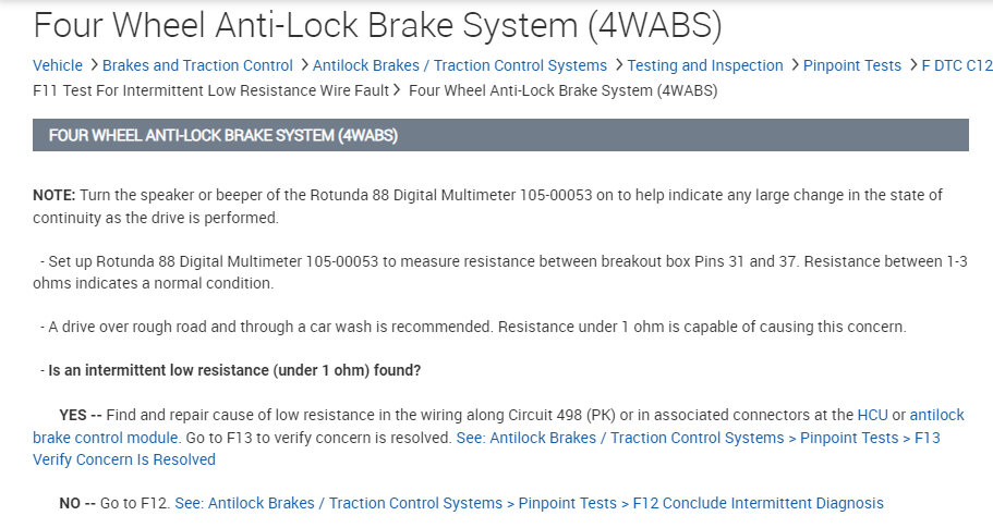

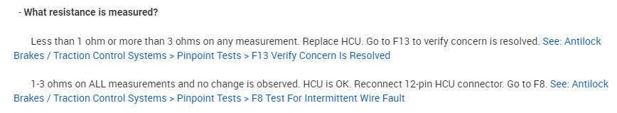

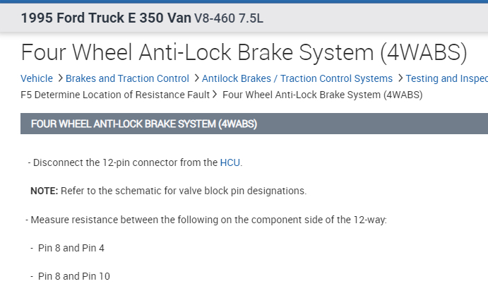

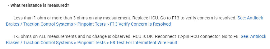

I attached diagnostics below specific to that code. Again, this is listed under a 1995, but it should be the same. Take a look through the diagnostics and let me know if you are comfortable performing them
Oct 18, 2023 at 5:12 PM

So is it at the same test for the 3 and 4 wabs because I have the 3 wabs.
Oct 18, 2023 at 5:58 PM
  • 110,194 POSTS
I just went through the manual to confirm. This is the only test it shows for the code. With that in mind, I would think they are the same.
Let me know how things turn out for you.
