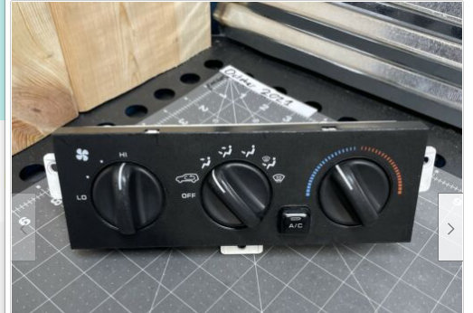

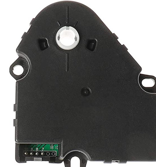

hello, hoping someone can help? i have the vehicle listed above Grand Cherokee Laredo that i have been having blend door problems, all i would get is heat out of my vents, so after doing some exploring i found that my actuator was bad (a crack gear inside) so after replacing the actuator, i connected the new actuator to the connector plug before installing it, and i get no movement from the actuator, after
turning the switch from hot to cold, so my question is how can i check my A/C, Heat Climate Control switch. by the way i can move my blend doors by hand to change temperatures.

Hello Joe, here is a update on what i found so far: the 12 volt fuse is good with 12 volts at
the actuator connector, the heater control unit (dark blue wire with red tracer) have o volts
with switch on, the (violet wire with a white tracer) in the connector does have continuity
to ground. so, i need to find out why dark blue wire with red tracer have o volts.

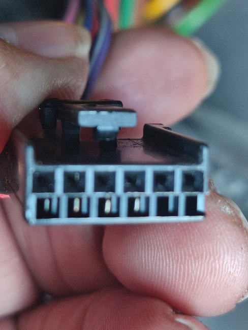

i check the blue/red wire right at the module, and no power, and i check the blue/red wire right at the actuator connection pin and no power, but i do have power at the green/pink wire at the module selector switch. question? so does the green/pink wire supply power into the module selector switch? Does the selector switch send power to the actuator? when i connect the actuator and turn the switch the actuator moves in one direction, and when i turn it in the opposite direction no movement, could it be a bad selector switch?
Dec 1, 2021 at 5:20 AM
  • 110,248 POSTS
The dark green/pink supplies power directly to the controller. Power can also be introduced via the blue/red wire in the opposite direction to turn the actuator motor in the opposite direction.
So based on your description, it works one way but not the other. Are you getting power at the pink/dark green wire at the actuator? Power is supplied to that wire via the same fuse dark green/pink wire but through a different wire to the actuator.
If you are not getting power to the pink/dark green wire, that is why it won't go the opposite direction.
Let me know
See pic.
Dec 1, 2021 at 10:34 AM

Okay, then either there is no power out from the actuator to the controller, the ground is bad, or the controller is bad.
If I recall, you checked the ground. Also, when you tested for power at the blue/red wire out from the actuator, did you provide your own ground? If you did and there was no power, it sounds like the problem is at the connector on the actuator. The controller provides a ground path for that wire to complete the circuit. Providing a knowing good ground and testing at the actuator, you should see power. So, inspect the wiring very closely and the connector as well.
Now, if you provide a knowing good ground and there is power, the controller is the likely cause.

Hello Joe, just getting back to you with some good news, i received my new controller Wednesday and after installing it on Thursday, everything is working again, so the old controller was getting power to it, but not supplying power to the dark blue/red wire to the actuator. the new controller fixed the problem. Once again (Thanks for all the help) i can ride cool again.
