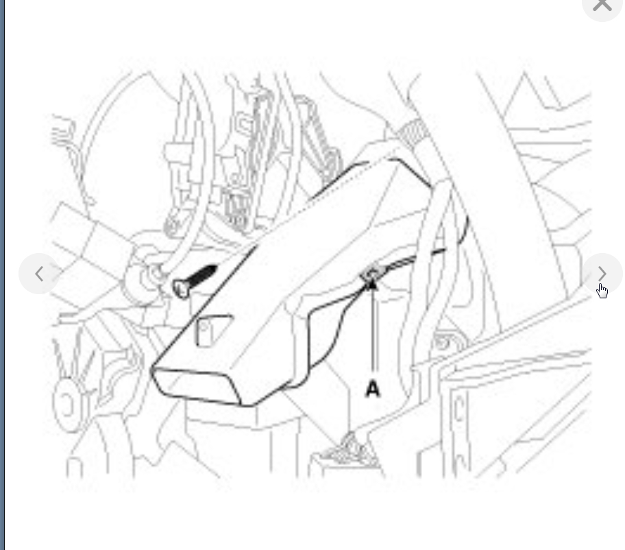

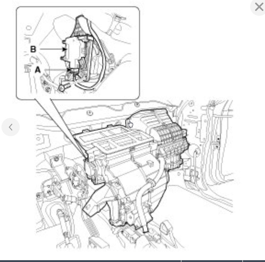

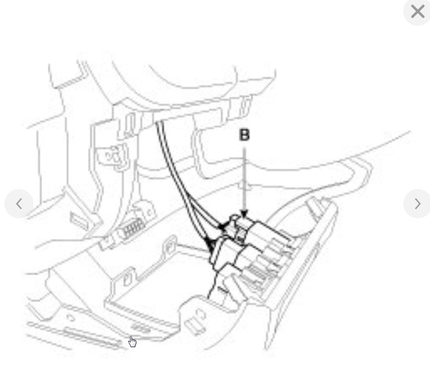

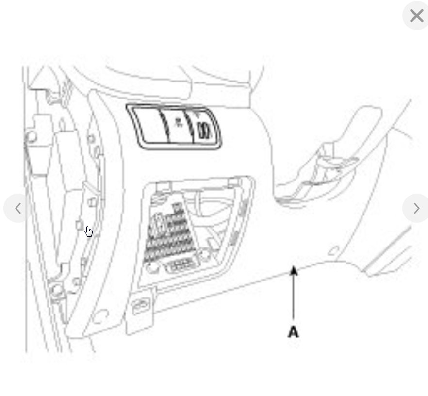

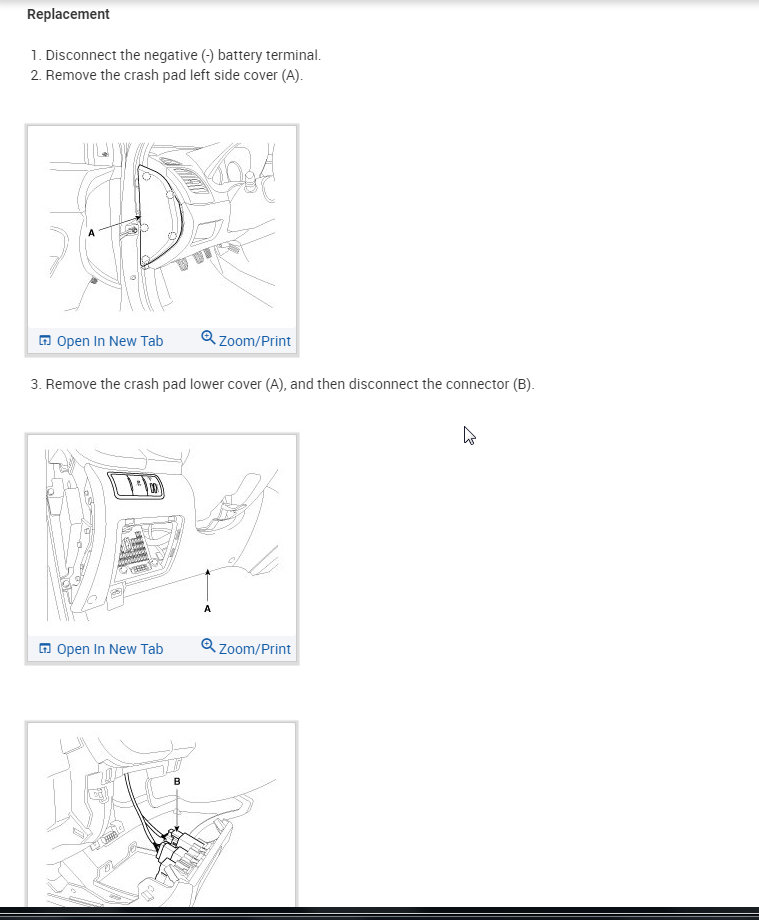

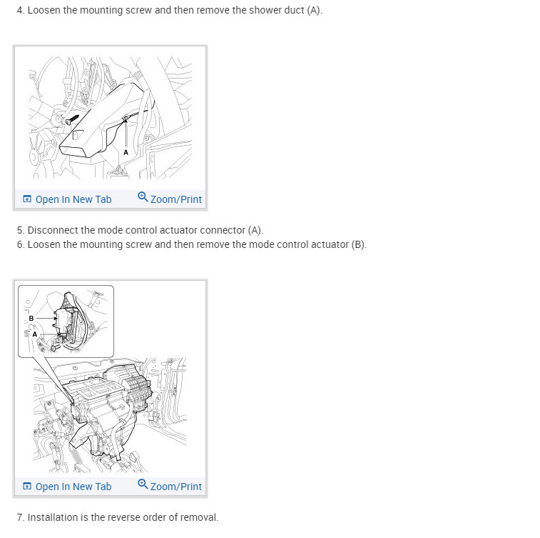

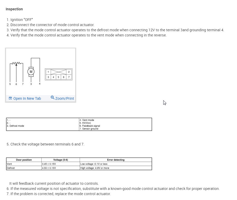

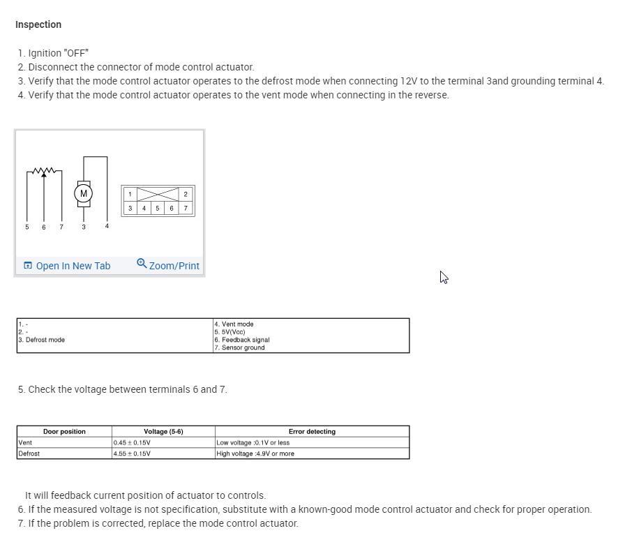

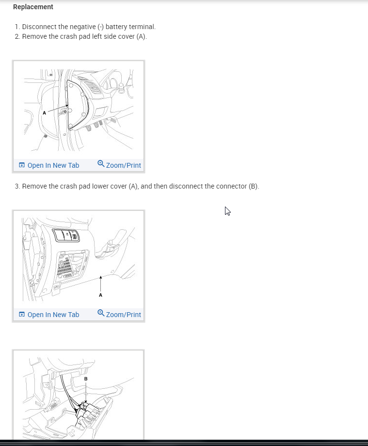

Clicking sound. Heat and A/C work but only blows through defrost vent.
Jun 22, 2019 at 4:41 AM
Here is the procedure on the mode door. Let me know if you need more information. Thanks
Jun 22, 2019 at 5:01 AM
DARMIL521

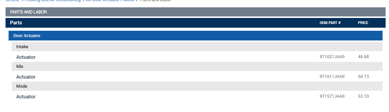

Yes, awesome! That is exactly what I needed. Do you happen to know the part number I need?
Jun 25, 2019 at 8:01 AM
Here are the OEM part numbers that I show in Alldata. However, I would have these checked to make sure they are correct before you order because I have been told they are not correct sometimes.
