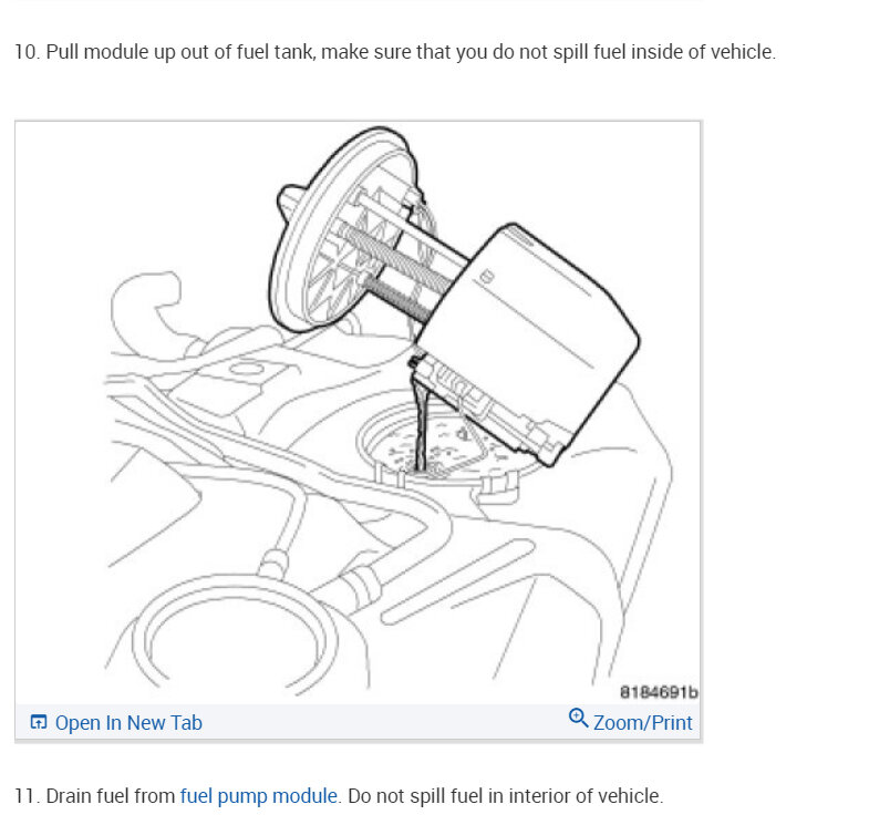

I have a fuel pump that I just got, but my housing that I have does not fit my fuel pump. So, I'm trying to figure out what kind of housing I have to get for the fuel pump.

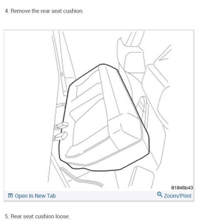

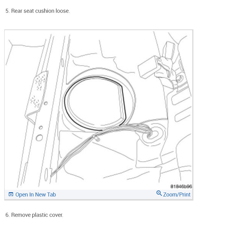

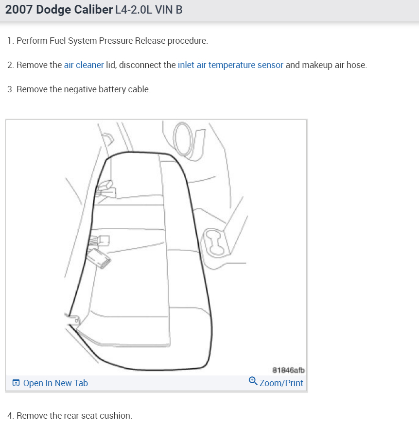

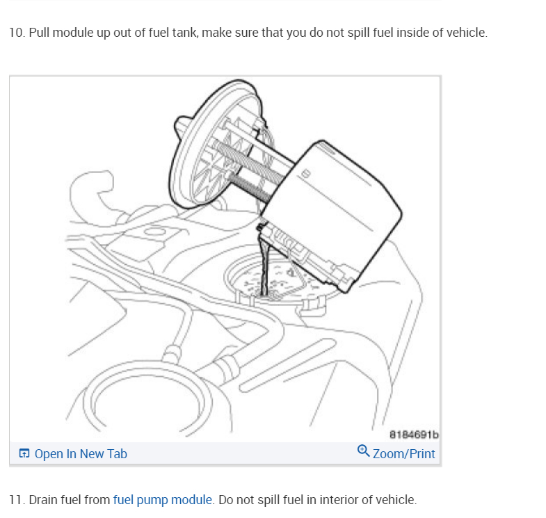

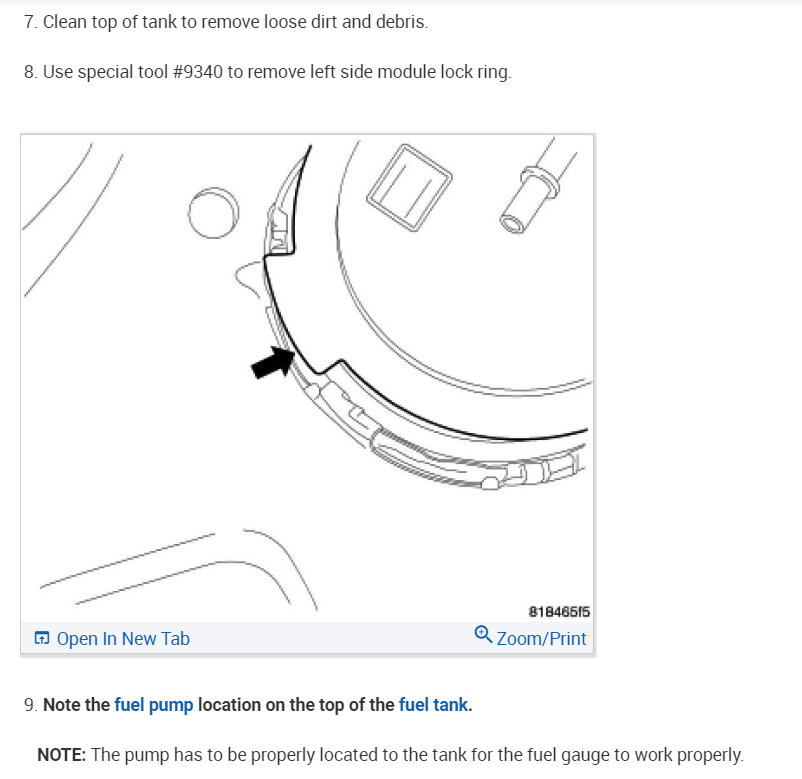

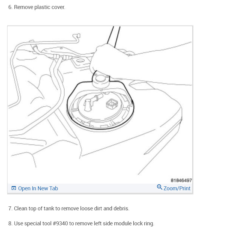

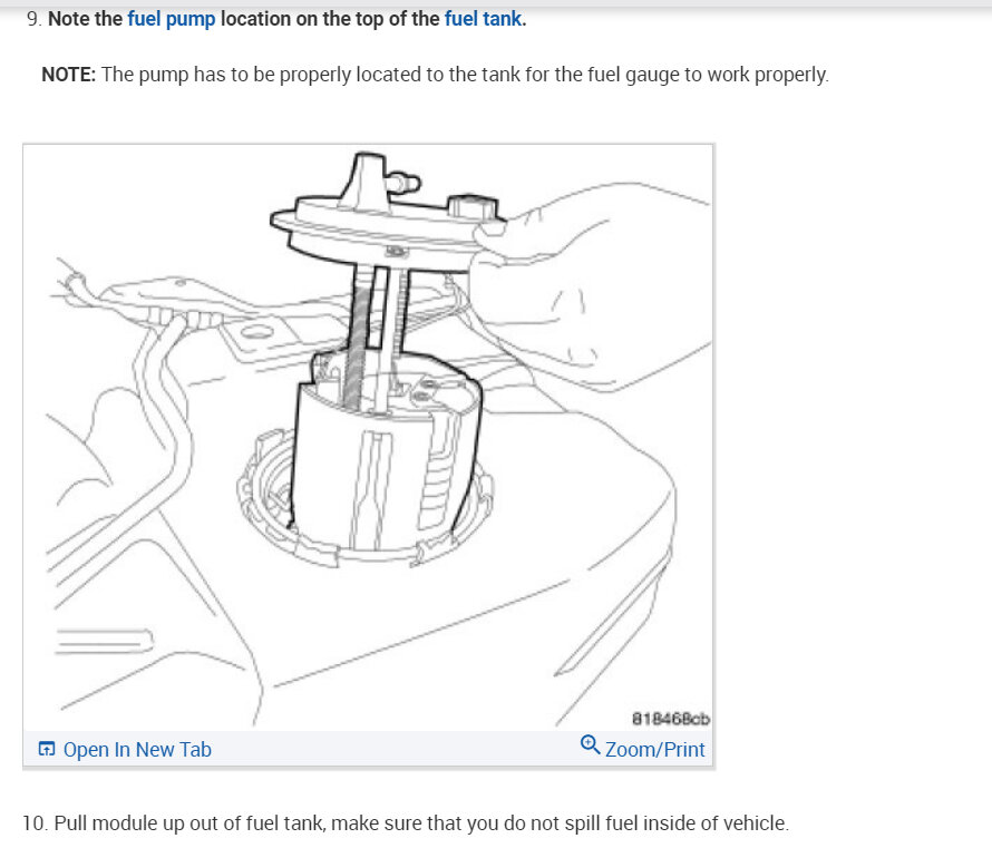

Please upload pictures or videos of the problem so we can see what's going on. Did you get the correct part? Is it OEM or aftermarket? here are the instructions on how to replace the pump. Check out the images (below). Please let us know what happens.
