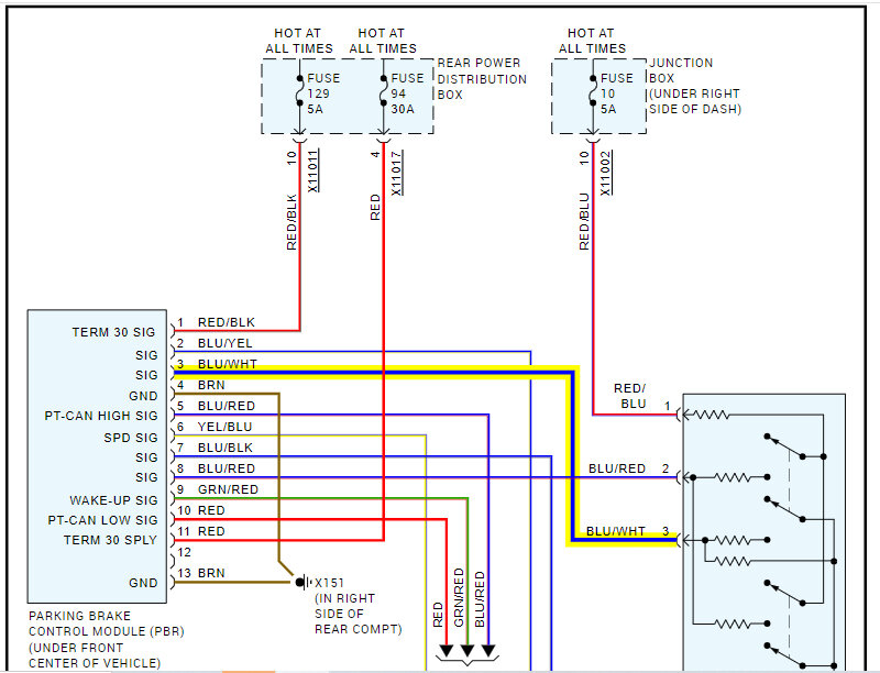

What wire needs 12v and GND to actuate the Parking Brake Control Module?
For reference I found this wiring diagram in thread from last year:
https://www.2carpros.com/images/question_images/449637/original.jpg
Thank you!

I would be happy to provide a wiring schematic for you, but this procedure should be done using a bidirectional scanner that can actuate the park brakes. My concern is if something becomes damaged.

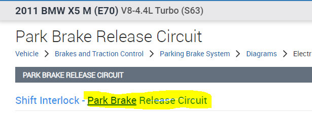

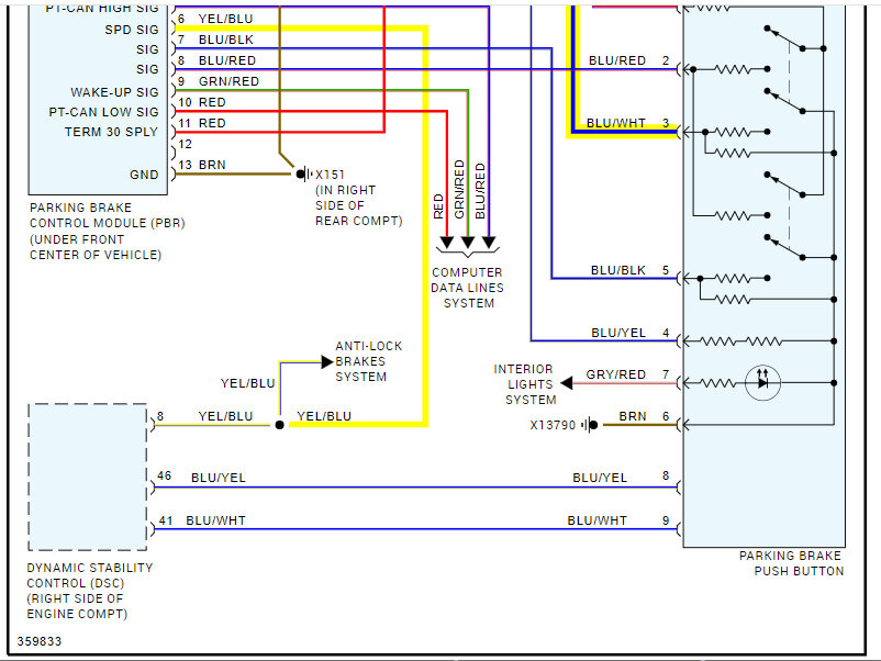

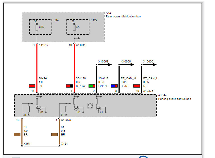

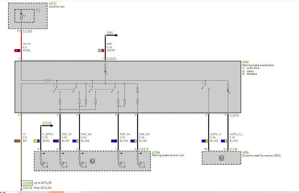

I attached what I have below. Pics two and three are non-OEM and more readable. LOL The remaining is what the manufacturer feels is what we need. Note that I cut the non-OEM pics in half to make it more readable for you. I did overlap them so you can follow from one to the next.
Let me know if this helps.

Thanks again Joe. Any idea what AMP draw the motor in this actuator is?
Dec 19, 2023 at 1:39 AM
  • 110,251 POSTS
That should be a 12v signal (B+). If you apply 12v and it seems to run extremely fast, cut the power and drop it to 5v. However, if I recall, it is 12v.
Let me know how things work out for you.
